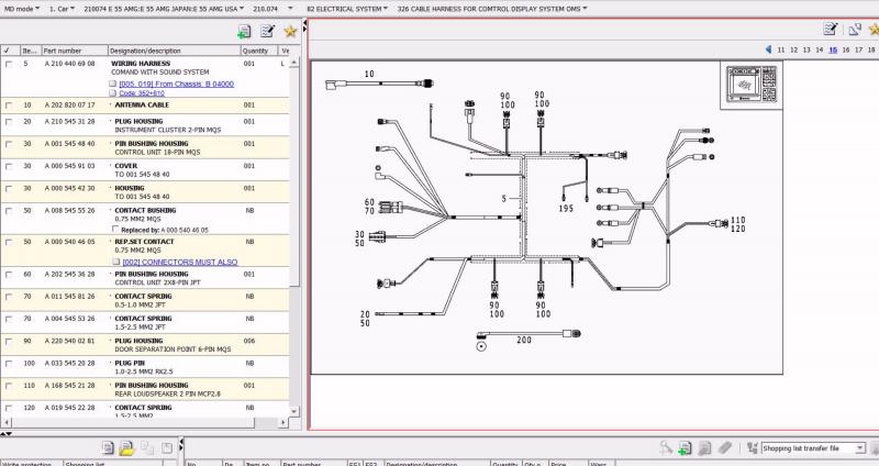

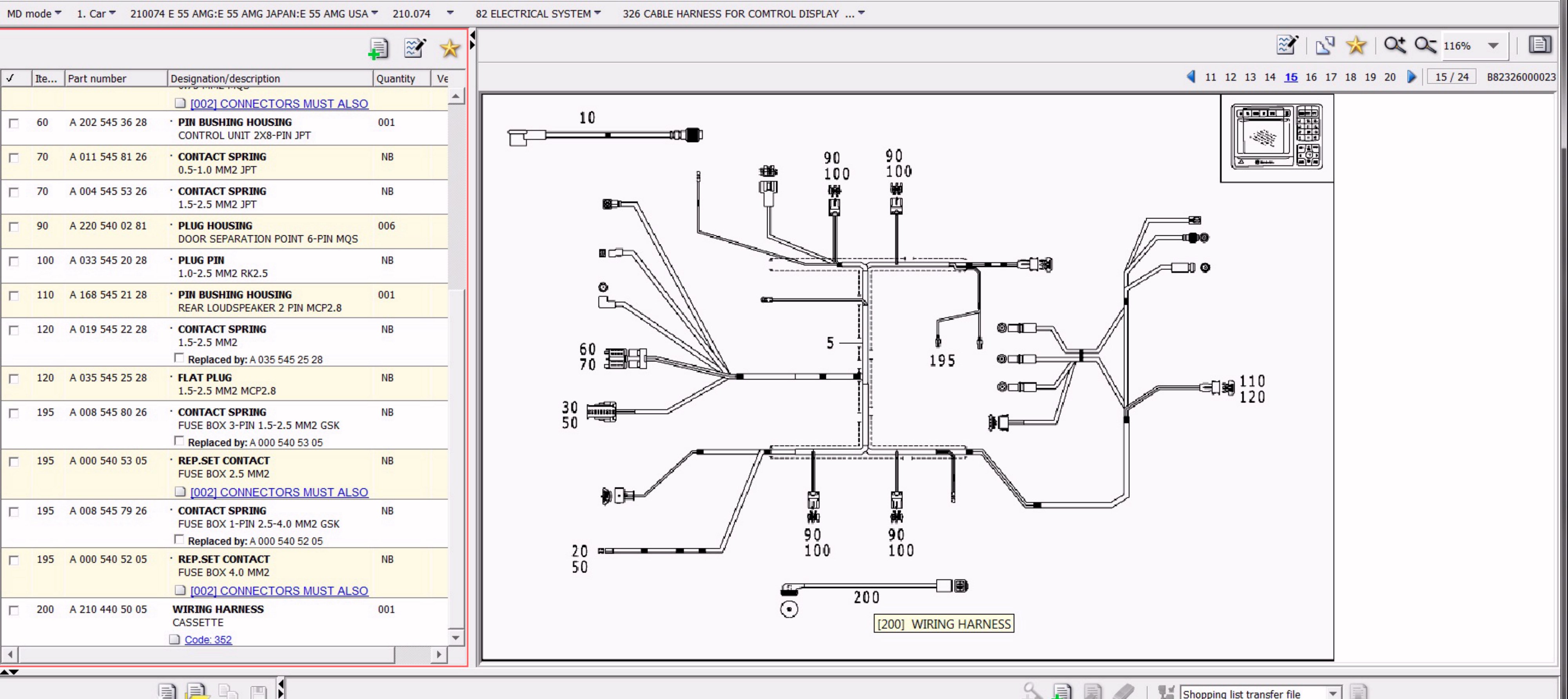

I ran a standard [Radio Shack] 3.5mm 6 foot wire from the glovebox inlet, behind the glovebox, tucked inside the console, out from under the console on the passenger side between the console and the front pass seat. I can use my iPhone while driving, or the wire can reach to the back seat for my daughter's music. Wire can be tucked down between console and seat when not in use.
homepukes: Hope you get the AUX inlet to work. Maybe the actual female plug is bad, not the wire or amp input? Have you tested it? Easy to change the female plug. Maybe you can look at the amp in the trunk and see if the AUX cable is loose?
Pic 1
www.cudaized.com/E55 amp b
Pic 2
www.cudaized.com/E55 amp wire b
Item #200 is the "Wire Harness Cassette" wire = the AUXinput. The owners manual talks about the AUX cassette input in the glove box.
