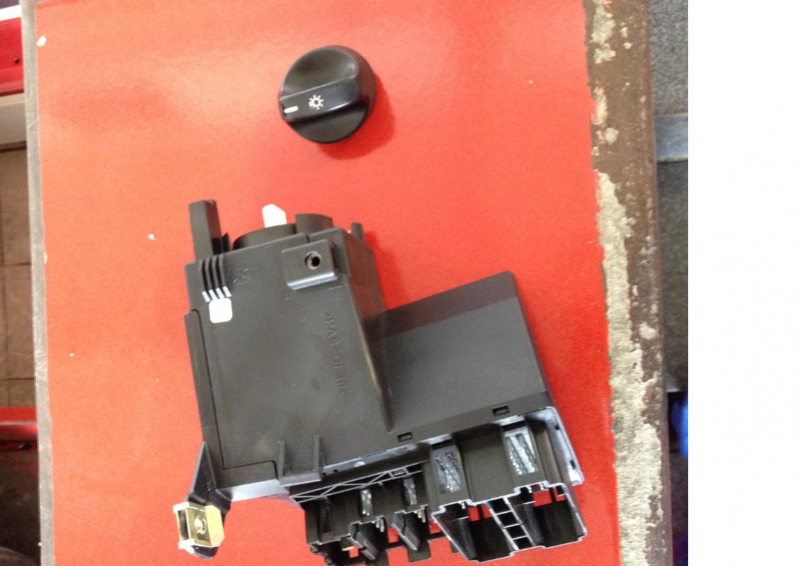

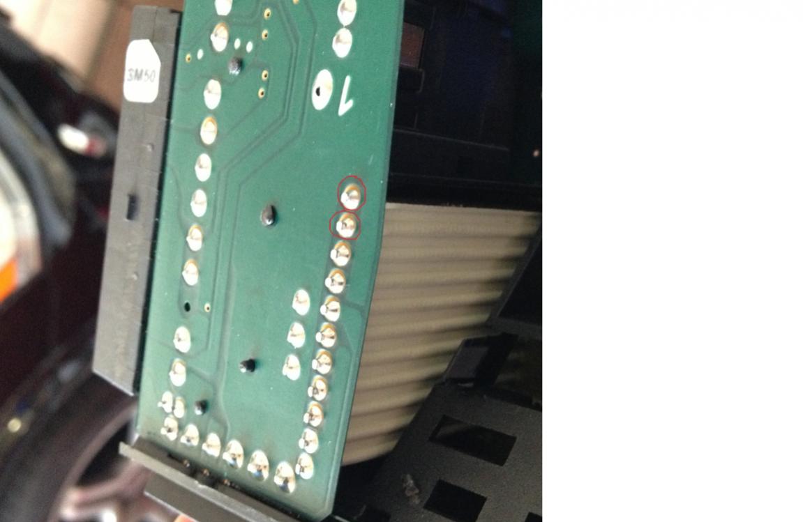

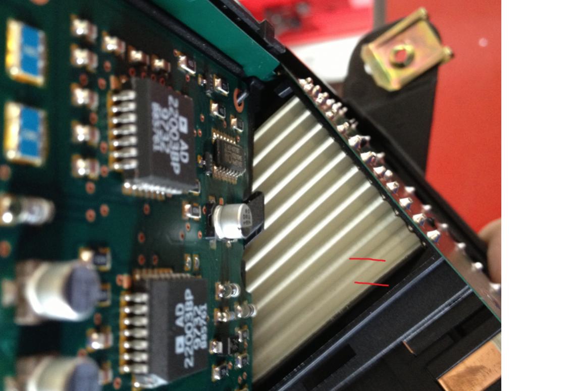

Ok i dissasemble one used unit in the shop today! here is some pics, the cannadian car that i made the job no comes with the plastic protector in the wires, this is why i tell you they are nickel plated wires. But the unit i dissasembled today seems diferente. I mark in red the pins that i think you need to cut. Just check with a voltage meter if this 2 pins got +12 when you start the engine and the lights turns on. Dissasemble the unit (remove the plastic covers. plug all the wires again turn the engine on and check with the voltmeter what pin got +12 when the engine starts). pell off the protector of the 2 wires and cut them
Here is the pics.
* Take care and do not cut the wires without check with a voltmeter if they are the correct ones cause i make this job 2 yrs ago and i'm not 100% sure if they are. but i'm sure in this wires is the function, 2 of them Left/Right. Just check before cut
Fabio Daniel
Here is the pics.
Fabio Daniel
THE BIGGEST THANKS EVER!!!!!!!!!!!!!
I have not thought,that these wires were that I needed,when I get w210 again,I will try

your welcome mate. Try it i make this job like 2 yrs ago but trust me is pretty easy, just take care to prove the wires before cut with the voltmeter. cause i'm not 100% sure if the 2 wires are the ones that i mark in red or the 2 ones in the left. but is in this lines for sure

hey,I made it,but there was no first and second wires,I tried all wires,so at last it worked,thanks for your help anyway,I couldn't be successed without you
