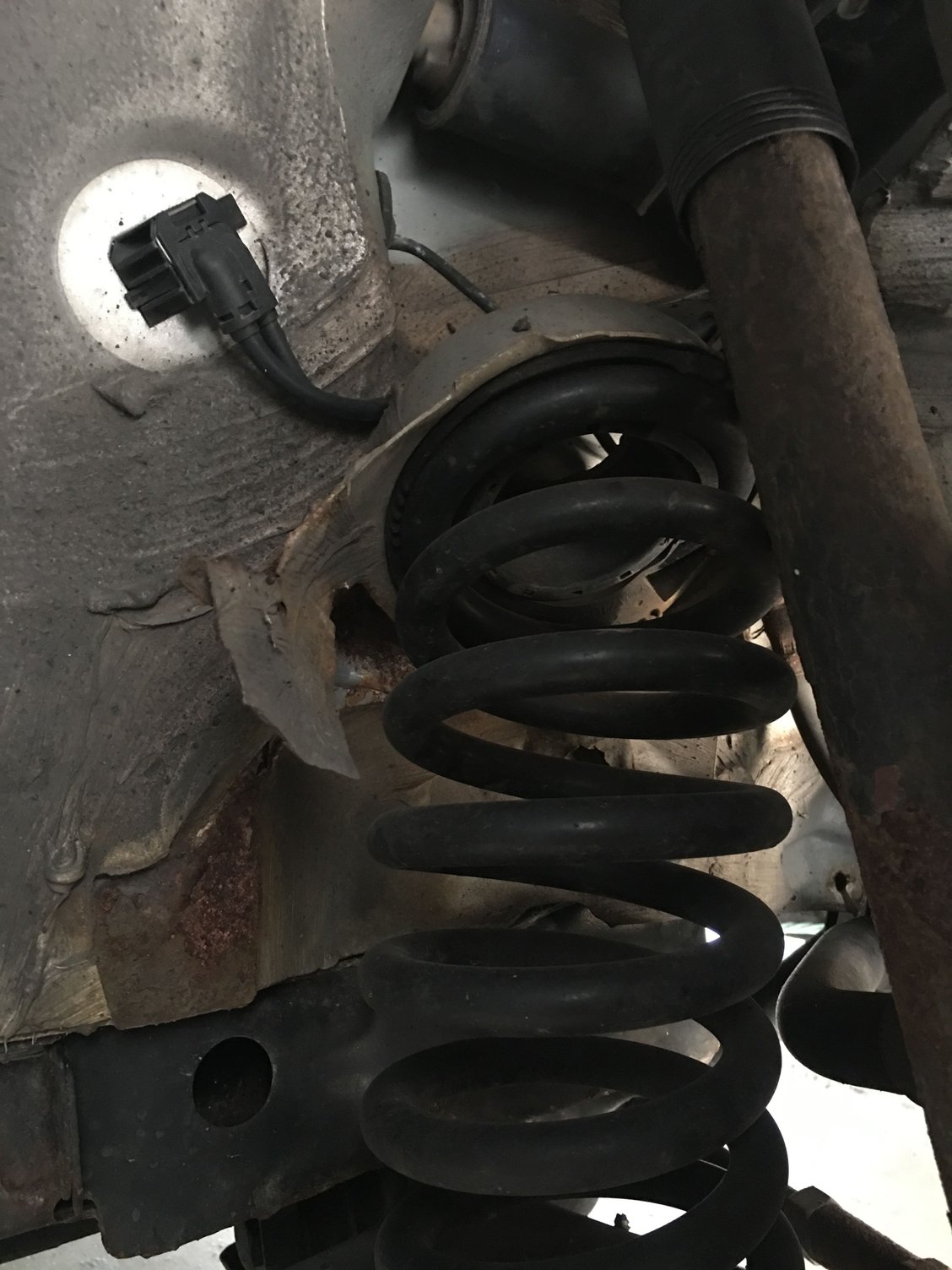

Does anyone know a shop near Plainfield that can repair my spring tower it's not broken but bent
This is the driver side

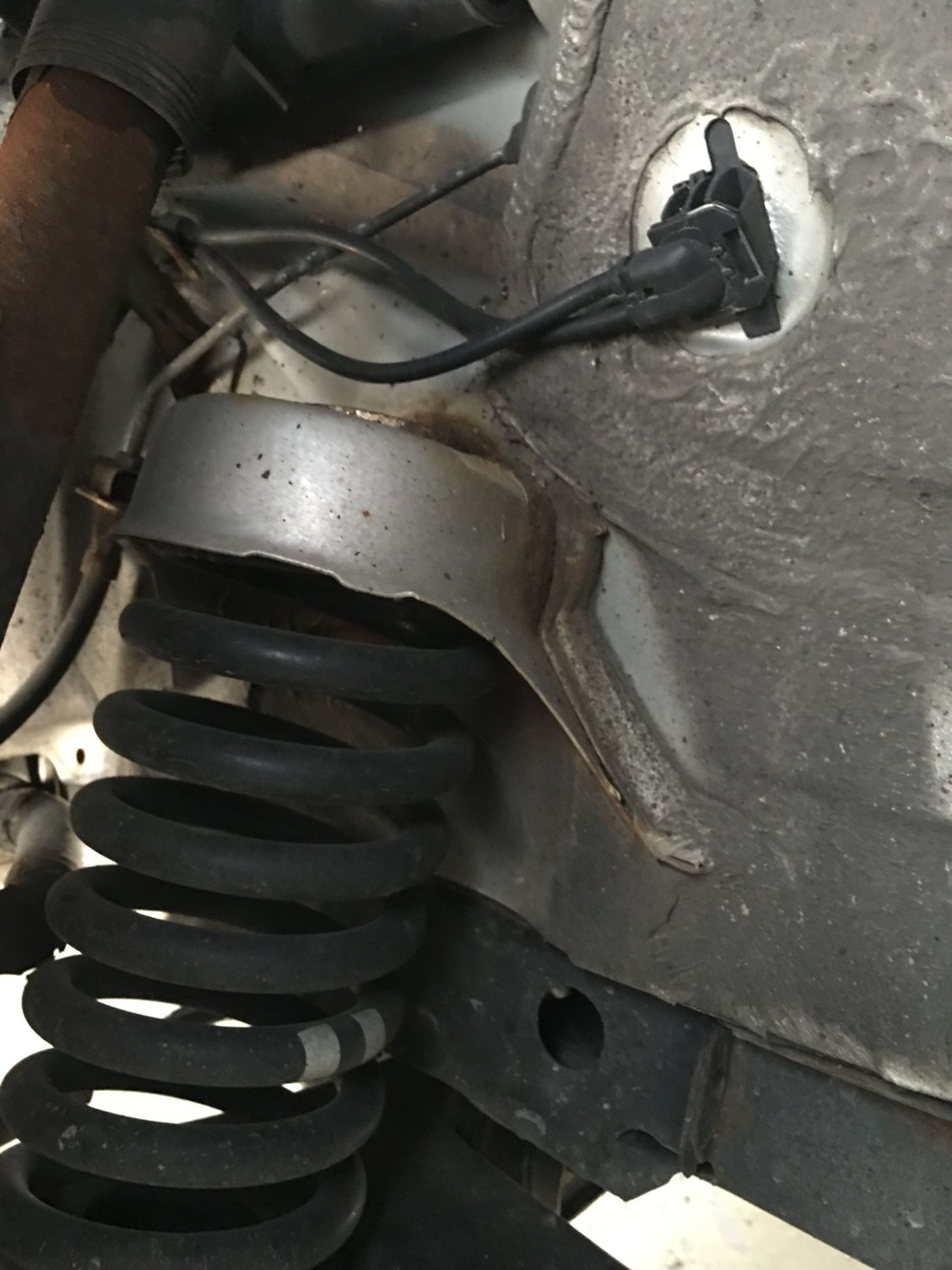

This is the passenger side

Body shop. Hard to see from the pic but it looks like the metal is torn. What did you hit?
They will have to remove everything, strip down to bare metal (there's lots of rust on your car), replace any torn or bent pieces with new or good used ones welded back on like factory, then re-seal and insulate all bare metal as factory. Probably $4-5k in repairs done properly.
Buy another car.

Originally Posted by Law Lew
What's that I'm a first time mob owner got the car used don't know much about cars someone told me about this site that they have have some answers if not all
Still you chose not to disclosure your location, what makes answering you harder.
Those cars had spring perch recall in USA. The time is probably over, but doesn't cost much call Service Adviser at local dealership and ask.
What is really amazing on your perch is that with no sign of rust around, the spot weld corroded.
I zoomed on the picture and did not see to many welds to start with, what makes situation better for you by indicating inferior craftsmanship.
Shops usually charge in the range of $300 for RIVETING new perch. But again, that in USA

The new perches sold by MB USA are rivet-mounted only.

I found a part through pelican
Was told this is what I need

Here you go.
It looks different than MB perches I have seen, but pelican is reputable supplier.
So did you talk to your friendly MB dealer about it?
