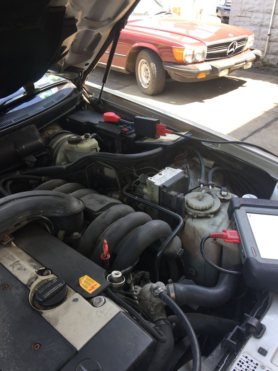

No mine was a hard not soft unfortunately I wish cycling the key would of helped things. This is where I’m connected to the vehicle

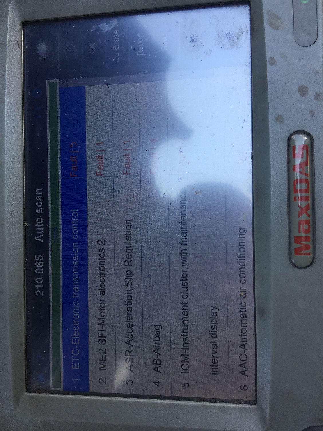

That’s a friend of mines auttel I believe it’s spelled scan tool I have been using it since my modis decided to grow legs waiting on a check from the insurance company to replace it. I probably should of stuck around and just did it myself that way I would know the code but he just said his best guess was it the shifter needed programming knowing that wasn’t the case is why I figured I’ll have to end up changing the conductor plate sooner then later anyway so I might as well do it now before it leaves me stranded somewhere waiting on a tow truck.

That's the right port, but was it right scanner?

That's the car "health page" You should read each of the codes later.
