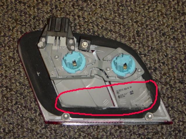

Going to pick these tail lights up today, question about install
im going to pick up these e55 tails today, and was told i will only need to modify a tab or two on each light to get them to fit, is there anyone here that has done the retro and knows if that will be all?

If they are factory OEM tails, they should be a straight swap. It appears the ones you purchased are just the lenses (no bulbs) and the ad states "This is a set of W210 Mercedes Benz tail light lenses only no bulbs included. Brand new, after market and look like nice as the original one.DOT & SAE APPROVED."

They won't be a straight fit . The the center two on the OEM MY00+ need to be trimmed down on the inside or else they will not fit.....elemnt, if you take the middle two off, you'll see Jimmy's done some mods to make them sit flat on the panel of the trunk......

There's quite a bit of shaving needed to make the MY00+ E55 taillights fit MY96-99 W210's. I have a whole thread including pics. somewhere in here. Do a couple of searches and you should find the thread. If I was in town and avail. I'd shave them for you but unfortunately I'm in Miami Beach at the moment and won't be back for a couple of weeks. Good luck on the search and modding and make sure that you have a dremmel or other small rotary sanding tool avial!

Anyway, anyone who attempts this should have an electric rotary tool of some sort. Some people have also used a hot blade but I've never tried that and besides, the dremmel tool makes it quick and easy. Find my thread and you'll see the pics. people. Good luck!

I still got that pic of where to shave u gave me jimmy...i can send it back to u or elemnt when i get home this weekend. lemme know.

ya i was told by my buddy that installed these same lights on his e430 that id just need to shave down a part or two, i already have a dremel, is there a specific attachment that you guys could reccomend ?

i think ill have to mod them because theyre made for 00,01,02 and i drive a 98, anyway got them today, didnt have time to put them in tho, hopefully tomorrow
if you have any of the pics of where to shave id appreciate it, thanks

Hey Davey boy, if you have that pic. please post it so these guys will know where to shave it down. After you guys see the pic, please note that the areas that are circled need to be taken almost all the way down. It's okay if you poke through on a couple of spots but just be careful not to completely remove any sections because it's reflective and will cause a slight dark spot when mounted.
Sure....I'm travelling right now but will be able to do it within the next 24hrs when I get home....hang on to your lights guys

As promised:
Attached Thumbnails Going to pick these tail lights up today, question about install-light-1.jpg
