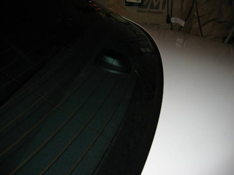

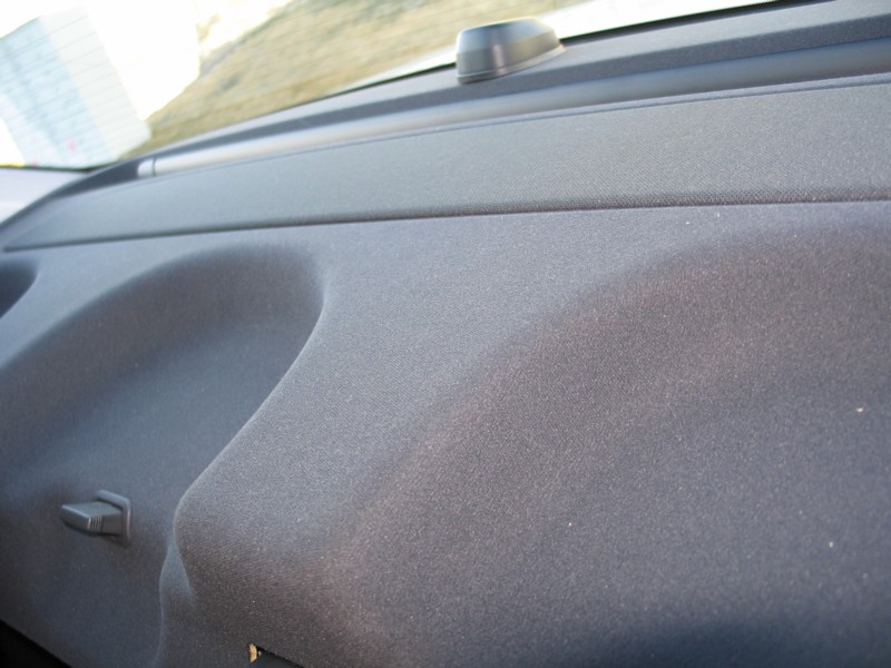

I don't know if this helps, but I think that there are two different issues here. The first one is that SOMETIMES the non OEM antennas don’t work well with the W211. That is why my dealer still uses the regular big black antenna that would be mounted on the trunk lid, but puts it on the rear hat shelf. The other is location on the car.
I have at least 100 hours of listening to the radio and I have excellent reception. Even in winding mountain canyons it never cut out. When I go into a tunnel, the music lasts about 7 seconds and then takes about 2 seconds to come back once I am outside the tunnel.
Attached are some pictures of the installation. If I had the antenna mounted on the trunk, then I would at least want it painted to match. However, since this has worked flawlessly, I am very happy with it being black and on the hat shelf.
Steve
