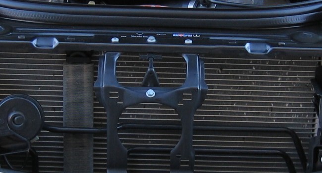

So the car went to the dealer for tire balance/rotation for a 2.5 hour job. They ended up keeping the car for two days. When I looked under the hood, about 20% of the radiator fins were pushed to one side. Does anyone have any idea what could have happened (like the tech’s knee hitting the radiator)? Does this look like the radiator is compromised?
The warranty receipt says “updates required” but nothing more. The service rep is out of the office for the rest of the week.

Dude, go back in there and get your radiator replaced. There's no excuse for that to happen to you. According to your picture, it definately looks compromised. I mean, you know, just look at it! What do you mean by "updates required"? You shouldn't have to wait for the service rep to come back in a week. Try and talk to a manager or supervisor or even someone higher up. Good luck man.

The fins can be straightened... there is a comb like tool.

do you know they were straight prior to taking the car in for rotate/balancing? It does seem odd as i would think they wouldn't have to pop the hood...

Classic pressure-washer damage.
Obviously they turned a retard loose on a high-pressure wash nozzle.
Did your engine look really clean upon return of the car?
Schmuck probably thought he was helping by getting the insects out of your radiator.
I have performed some pressure washing in my time...you have to be careful around residential air conditioners for the same reason.
Look also for swirl marks/ linear scuffs in your clear coat. Whoever raped your radiator with a water jet also has the mentality to drop a sponge then use it to continue washing merrily like nothing happened. Or to run the sponge along the low rockers or inside the wheel arches, then across the hood and roof.

Hi Mark. Looks like the damaged part is the A/C condenser, mounted in front of the radiator, not the radiator itself. Looking at mine, it's hard to see how a fin comb could be of much use for repair, given the configuration of the fins and tubes.
I have no clue re how this might have happened. The fact that they had the car two days for what should be less than 2 hours of work makes me suspicious as well.
In any event, it looks like the damage will restrict airflow, through the radiator as well as the A/C condenser that's damaged. Not something I'd want to have if I lived in Tampa.

That is exactly what it looks like to me! The aluminum fins are super easy to bend on this car! My car has a few little bends from the day I bought it. There is a comb to straighten them out, but it would be had to do here because the fins are NOT constant. One would have to keep removing the comb and bending one little section at a time. Mine was not bad enough to do anything about it, but since this picture it has only gotten worse.
There is a chance that your dealer did not even do it!

Since it's the A/C condenser and you are in hot/humid Florida...
You should insist on a replacement. The performance of your A/C could be reduced.
If you don't get it fixed, you will pay at sale time; if it is noticed, your car has a blem and it is not as valuable.

Yes, I cleaned the engine compartment two days before service.

cdiken you were absolutely correct!
OK, so the service manager hasn’t returned my calls or emails for 5 days. I had my secretary call to make an appointment with the general manager, and, voila, the service manager had time to see me.
He looks at the damage and said at first a tech may have put his knee into the radatior. But, the bent fins went in several directions. Apparently, nothing they did caused the damages.
So I asked whether they use a pressure washer in the car wash and he said we’d go look.
With a quick drive to the car wash area, we found there were two S Classes in line and, OMG, a little old man with a PENCIL POINT spray nozzle on the pressure washer. So the service manager points it at my grill and smashes more fins. Good Lord, don’t they know that tip is used to remove old paint?
Thanks SO MUCH to cdiken for this insight. A new radiator and AC condenser (thanks Karl) are to be installed.
