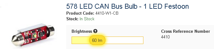

not so..the Merc license plate lights run on a canbus, needs 5W drain to report no error. LED's are brighter and lower wattage but the canbus LED's have a load resistor to simulate the 5W load. the heat thus still gets generated in the place holder from the heatsink...

There are many CAN Bus license plate lights for Merc available:
i.e. W203: https://www.superbrightleds.com/sear...oducts/canbus/

Are the wagon lights the same as the sedan lights? As far as the module is concerned?
If so and they are the same if it were me, I would get the LED modules. I replaced mine on our sedan and it's awesome.
Let me find the thread somewhere...
http://www.benzworld.org/forums/w211...te-lights.html
If they are not the same, disregard the above. I will take a picture tonight before work so you can see the led modules. They are pure white light and light up the back very nicely. I posted a picture of it on our CLK when I bought those modules specific to that car but it's pretty much identical in terms of how the rear end looks at night/light projected.
-Nigel
