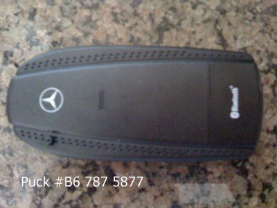

3) They had never seen the puck I bought from Steve B6 787 5877 (pic attached). They tried the puck they sell B6 787 5878 (the one that looks like an SLR engine), and could only hear one side of the conversation - the person outside the car.
BTW, the Bluetooth signal strength shows 5 bars on the lower right side on the COMMAND screen. The dealership wants the car for about 4 hours to try and diagnose the issue. Ouch, cost wise!

That is the Euro BT HF profile puck. I wonder if your car actually has the Euro UHI (or is it these days the same as the US MHI)? I still don't see why the audio would be distorted. Have you tried another BT puck?
Shouldn't you ask Steve before letting your dealer look at the car. If it has Euro parts, they might through those away and put US parts in, for nothing.
I contacted Steve and ironically he called me from his hardwired Nokia phone using the hands free system and his voice was just as distorted. The dealer could only get one side of the conservation using the BT model they sell.
I email Steve this morning to see if he could comment on this thread as well with any thoughts he might have.

the older 211s have a microphone array with 4 mics at the bottom of the mirror - mercedes changed that in 2007 for microphone arrays with only 2 mics at the top of the mirror...one of the reasons for that change was what is described here.
The installed MHI module (US spec) is new and so was the BT cradle...the small black BT cradle is the same as the SLR looking one...same internals - different housing (US= SLR, europe= black) and same pairing code.
Just mail me and we will set something up rather then wasting money at a dealership (we DO offer aftersales service).
