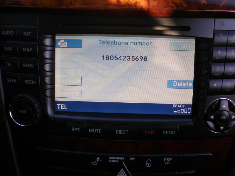

hey AP.... I had the same problem with my 04 E320 and was about to pay the dealer $2500 for the OEM installation and then I found the Itronic+Ipod. The phone works perfectly, the clarity is great. I am always on the phone and no one has ever complained. Plus I was able to get my IPOD to work. All my steering buttons work as well as everything on the command.

Where did you get the itronic from? Cost? Did you install it yourself?? I believe I have the same COMAND as you.
