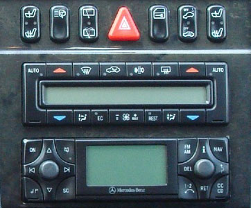

The problem is that MB have dropped the Rest button since 05
yup, at least on the E class and other lower models (CLK, C, SLK). I think even the CLS doesn't come with it. Probably only the S/CL/SL have it now, idk. Man, MB used to make one AC control system i really liked, it was used on pretty much all MBs at one point for a little while: seperate auto mode, seperate direction for passenger/driver, charcoal filter, REST, econ mode, etc
