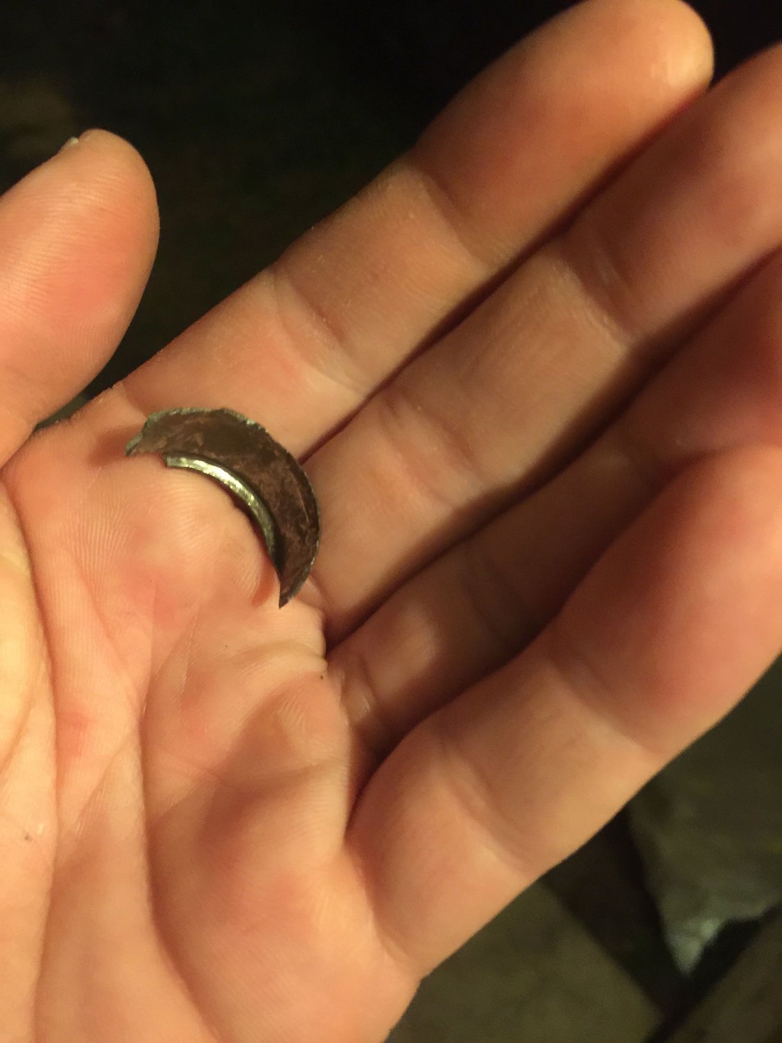

Fitted H&R springs all round today - off for wheel alignment later this week. Both rear springs were broken right at the bottom where they rest on the lower perch, about 1/2 coil on each side. Explains why the rear was sitting pretty low already!

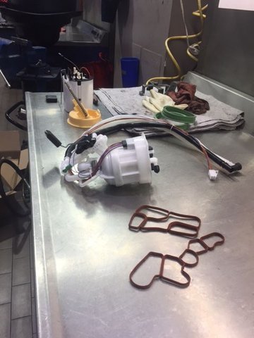

Today the 211 put some money in my pockets for once -fuel system components-warranty covered. And oil filter housing re-seal, coolant is turning brown after 4k miles and oil is starting to seep down my front cover.
Mine is starting to do the same as far as the oil seep is concerned, have the gaskets pictured but haven't had the time to do the job. How long did it take you to do these?

Originally Posted by W211_350WagoN
Clean or just replace your reservoir.
luckily it wasn't contaminated to the point where i needed to replace the expansion tank-so replacement wasn't necessary, housing was seeping/dripping and there was a small puddle of oil in my driveway.
well typically i just replace the housing however this is my car so i didn't mind re-sealing, saves me money and there was nothing to do here at work. Re-seal took about 2.5 hours, spent a good amount of time cleaning residual rubber gaskets from front cover and grooves of filter housing itself-age was the main culprit. Drain coolant-remove belt with tensioner-r/r oil filter housing-seperate oil cooler and replace seals-install in reverse order. It's a quite simple job and there really isn't anything to mess up. 1-10 job is about a 6 on level of difficulty. AMG i know you do alot of your own work so you should be fine tackling it yourself!

Originally Posted by PutNavid
Quick question, how does this job compare in difficulty to replacing an ignition coil?
ignition coil 1, sending unit replacement and oil filter housing gasket reseal 5's on both. What engine to you have? Coils take like 5 minutes if that.

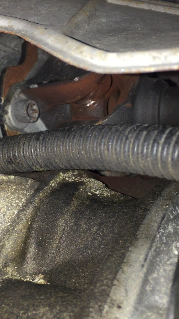

What did you do for your W211 today?-bd8c8d0a-40af-49b3-b9ae-d3fdd58a1a11_zpshphz8lia.png
My next lovely project to cold for this one
Seems pretty straight forward, any heads up before I tackle this one?
Oh that rights it's my front drive shaft
You better tighten up and change that joint! Before you on the side of the road hahaha jkjk, really though, pretty straight forward. Except unless you are on a lift I'm not sure you will be able to rotate it to remove the remaining t55's or what ever torx they are....
and that oil on that heat shield.... I'm sure you'll be cleaning that as well?

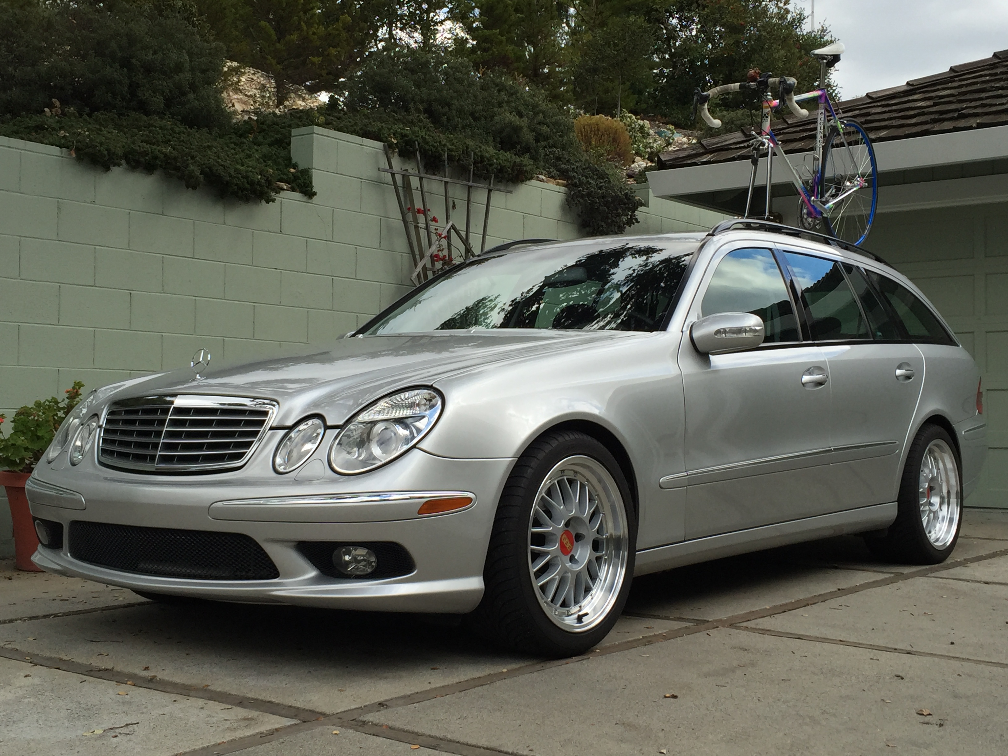

ride
Cleaned them both up and went for a ride.

Dorman drive shaft ??
Anyone approve or disapprove on this dorman brand for my Foward driveshaft ?
Dealer is $800 my cost
Dorman is just over $300
Thanks
Thanks
I wouldn't be surprised if they are the exact same thing....

looked of pretty good Quality. Jack was jacked up and only had 2 jack stands so with only front wheels off ground I was able to turn the shaft. Thank good I just bought myself a dewalt cordless impact gun for xmas without it, it would have been much more of a pain and time consuming.
Now I'll be doing fuel sender as a maintenance precautionary and hopefully get some performance (probably feel pump also) then on to conquer the AMG caliber ordeal "" hopefully
Btw this was sitting on the underbody cover with a lot of rusty dust from the U-Joint
