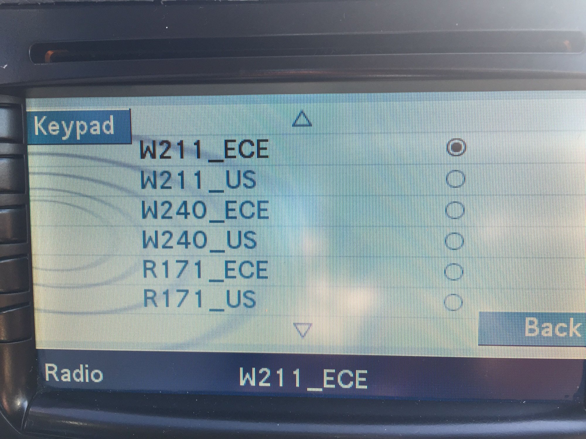

My car is 04'
Old Jun 15, 2015 | 02:38 AM
Ev1's Avatar
Ev1
Joined: Jun 2015
Posts: 12
Mercedes benz w211
Look the menu
Old Jun 15, 2015 | 11:57 AM
starbrite's Avatar
Joined: Jul 2006
Posts: 1,779
Likes: 11
From: Long Island, NY
2004 E320
Is it possible to scroll up ? It should be there. Mine is an '04 as well and it's certainly present.
