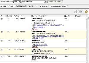

Disc/rotor part number for "sport" package is different than for base model. I don't have any special badging or indication of a sport package, but seem to recall that dealer said car had it when I bought. Am told that chassis number would give me the answer, but cannot currently raise hood to get it due to stuck latch. Will part of the VIN give me the answer or is the chassis number shown elsewhere? Any other way to determine?

Inspect vehicle may be equipped with alternate ventilated rear disc part # 2114230912.

Thanks for advice. I'm going to pull and measure before buying anything and will probably take the old parts to the counter to compare. Was hoping to save a few ordering online, but cross-reference on part numbers is inconsistent across sites. My front rotors are 295mm in diameter, which at least confirms which ones those are. Would like to go to lower dusting pads, even if I stick with the OEM rotors.
