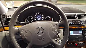

One more thing, when my car go straight the steering wheel is not center but tilt like this
2003 E500, dynamic driver chair, Heatr chairs, steering column are not working.-0404162011a.jpg
Is that because of the alignment out or else? Can I have the wheel alignment done at any tire/car service store or it has to be done by dealer?
Thanks
Old Apr 5, 2016 | 10:46 PM
rapidoxidation's Avatar
Joined: Jan 2016
Posts: 2,748
Likes: 880
From: In the Shadow of the Tetons
2013 ML350 Bluetec
I had my local tire guys do a 4 wheel alignment when they installed a set of winter tires for me in January. They did a great job: the steering wheel is centered, the car goes straight, and the tires are wearing evenly 4K miles later. The alignment cost me $60.
Old Apr 26, 2016 | 11:15 AM
ngocrebel's Avatar
Joined: Mar 2016
Posts: 15
From: Living in US
2003 E500
I brought the E500 to Plaza Tire for wheel alignment. They have $150 life time alignment which I think it's pretty good deal.
The steering wheel is center now and the car go straight. However, the technician said that car need special camper kit for both front and rear in order to do a complete alignment. They also give part number and picture so I can DIY. I just order the part, will put it on and re-alignment the car.
