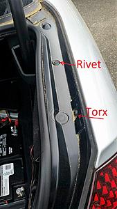

I'm replacing my trunk weatherstrip as water was coming in from "under" the seal.
2 questions:
1) I assume I remove the plastic cover, which is held in place with a few rivets and a couple of torx screws.Then pull of the rubber seal and clean all surfaces. See pic.
2) For installation, what "glue seal" do I use? I would ask at Autozone, but honestly would prefer to get advice here? Also, I assume I can re-use the rivets for the plastic cover?

1) Yes.
2) No glue seal. It just presses on. Reuse the plastic rivets.
