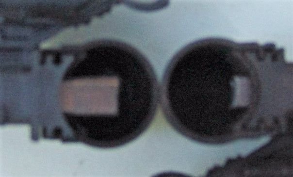

I did preemptive replacement at 170k.
Took a picture comparing the brushes. Maybe I would make another 10k, maybe not.
Mine is 180 amp alternator and has pretty long brushes.
Good luck with 3rd party parts

There is not much prevention in replacing part that is about 90% worn out.
For some reason alternator brushes is one of most neglected maintenance on cars.
Even if you replace the brushes (too bad you have to buy whole VR in America) at 70% wear, it sure beats towing and emergency repair like above.
To top it - just like sample above shows, mechanics will talk you into whole new alternator.
So let's talk how $70 prevention can save you $ 1300-2000 spend at dealer.

I finally transfer the picture that shows alternator brushes with 170k "head to head" with new ones.
Let me know if you need more explanation
