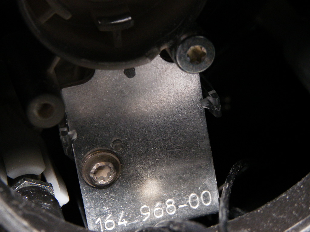

I can not find out how to take out the bulb. Se picture
The are some plastic tabs on the side of a metal plate.
I can not get it out

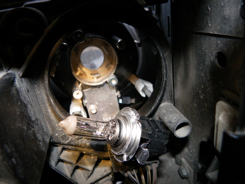

i reckon those are your headlights H7 bulbs and not the park lights. just pull it. whats with the 2nd photo?

Correct, here’s the bulb.

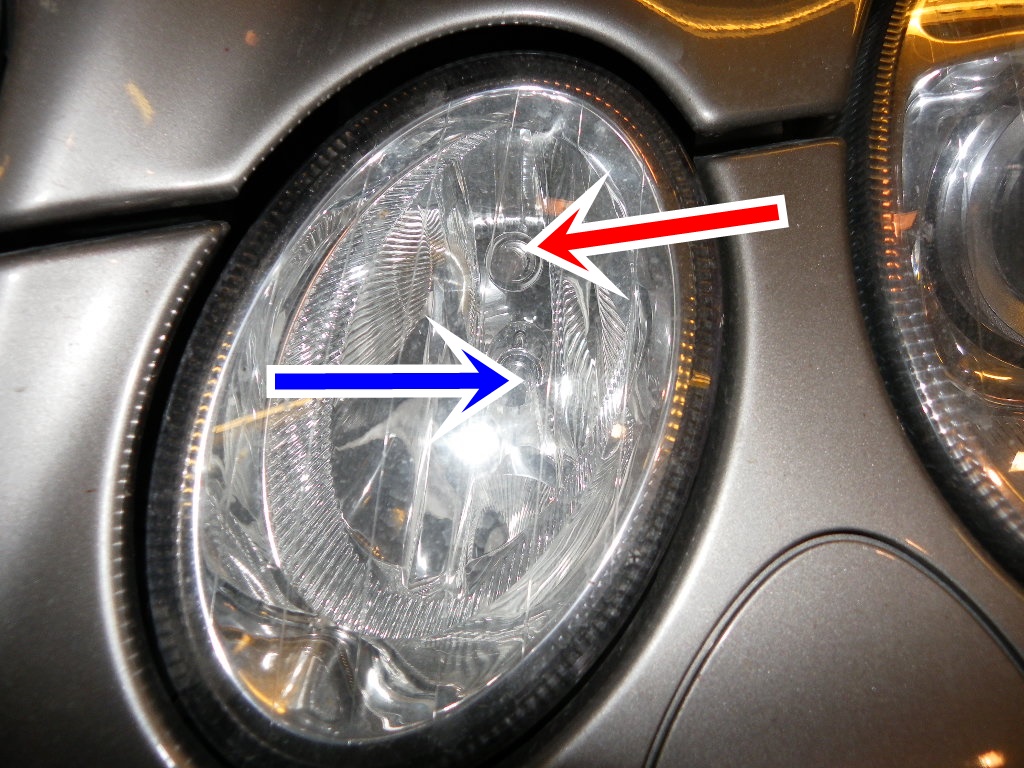

I have taken out the H7 55 w bulb, (red arrow)but the are not the problem
I think the park light are 5 w or somthing in the middle of the lighthose. (blue arrow) but I can not find how i taken it's out

red arrow is your high beam, blue arrow is your park/city light bulb.
twist and pull from the back.
edit: there should be 2 openings the the back of each of your headlights. 1st is for the low beam, 2nd is for the high beam and the park light.

The metal plate 164-968-00 can not be twist.The are some screws in the top do not alowed to do that.See picture #2

not sure if youre opening the same door from the back of your headlights but the parklights should just be twist and pull. not sure what that metal plate is of if your taking a photo of your low beam window from the back.

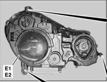

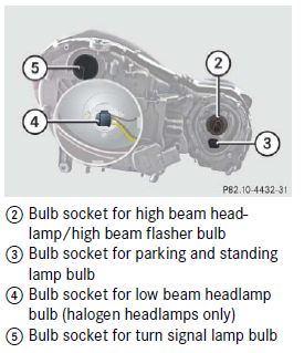

Here is OM info, is headlamp OEM
Attached Thumbnails How to change park bulb-capture1.jpg   How to change park bulb-capture.jpg   How to change park bulb-capture3.jpg

I have the same metal plate on my parking lights.

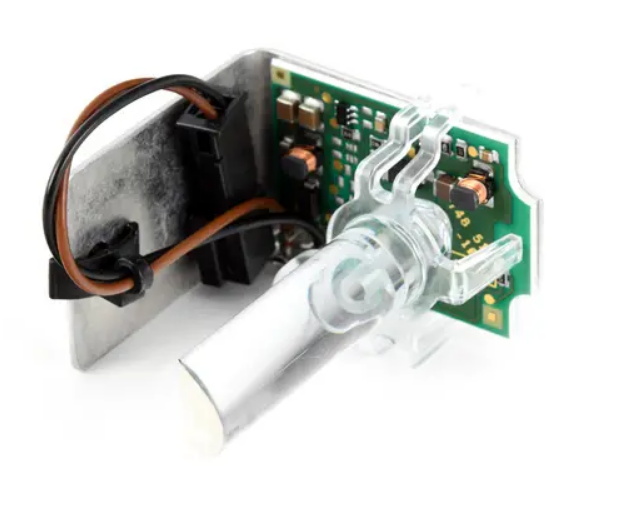

HI city-light / parking light - called "LED Module" is on the back of that small metal plate and fixed with that Torx screw.
Partnumber is 2119060036 or A2119060036 aka "A 211 906 00 36"
That LED module with circuit board and mounted lens is specific for some of the facelift models (+2007)
The part is no longer regularly available.
A 211 906 00 36

yes. Was able to get one from a company in the Netherlands called Aharon: http://www.aharon.nl/onderdelen
i don’t know if they have more in stock still, but may be worth a try.
