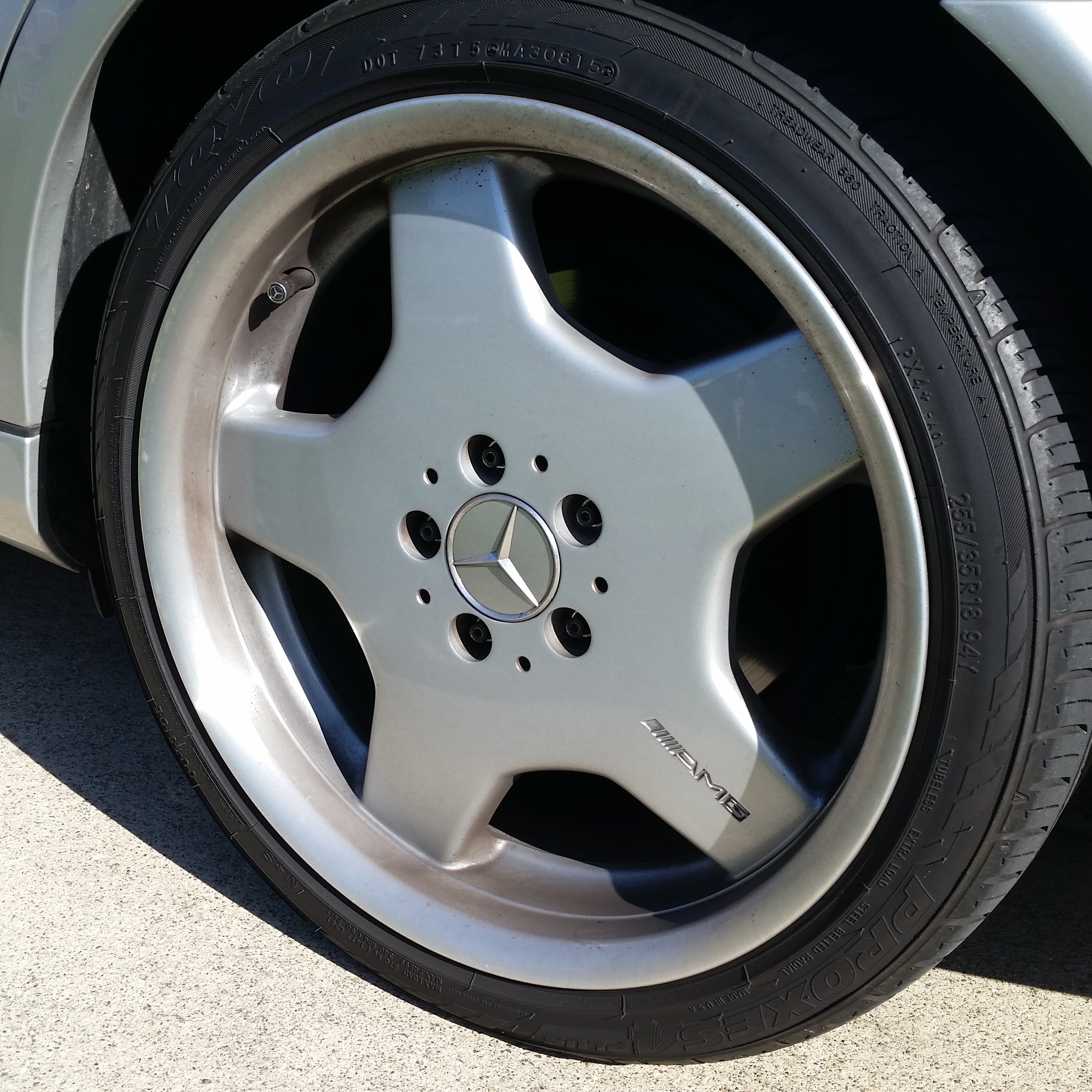

Old Apr 2, 2017 | 12:47 PM
S70Houston's Avatar
Joined: Mar 2015
Posts: 1,975
Likes: 265
From: Sacramento, CA
2018 GLC300 4Matic; 2008 ML550 4Matic; 2004 C320
Originally Posted by kajtek1
S70Houston did not say what tires model he put, while nominal sizes can have huge variety of rpm.
Without checking tech spec you are gambling.
S70 Houston is running TOYO PROXES 4 PLUS all around.
