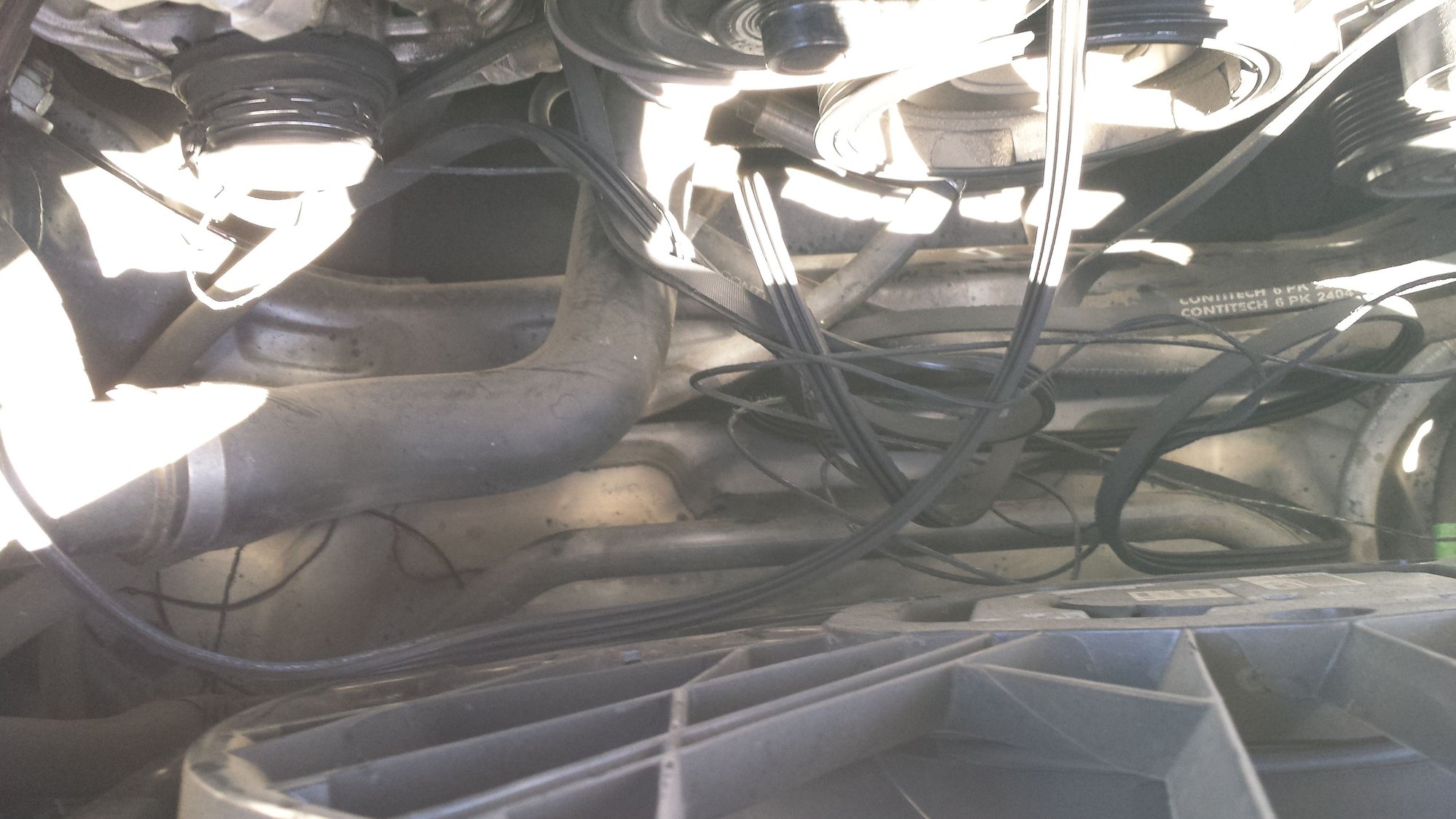

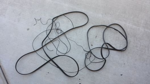

Well, thanks for asking me to look at the serpentine belt. Found out why the PW wasn't working as well as the alternator (which I was getting ready to purchase)
This is my belt...well, what's left of it...
Heading to the store right now.

Ok, think I found out why my belt is in pieces. Googled the part# 000 202 10 19 which is visible on the pulley and it comes up as the Drive Belt Idler Pulley. Some stores show a replacement pulley but mine does not look like it can be removed. Does anyone know what it is connected to or is the bracket it is attached to, part of the entire unit or is it something else?

You should have Allen head bolt behind the center cap. (drawing might show different set up with the same pulley)
Don't know 350 engine, but MB star putting cheap bearings on pulleys and tensioners starting with W210 engines, meaning replacing them is consider maintenance items.
Consider replacing them all.
thats a nasty split.
replace it and drive along again

Thanks to everyone that posted. I went to youtube to find out how to replace the drive idler pulley and found that it was a cap covering the bolt. Used a flathead screwdriver to remove the cap, used a T50 torx driver to remove the bolt and presto-chango! Installed my autozone replacement pulley, installed serpentine belt and voila! Everything works and all messages cleared!
Special thanks to Maroc_Specops for mentioning the serpentine belt. Surprised I was not getting more messages since the entire belt was shredded to pieces. Saved me from purchasing the alternator.
