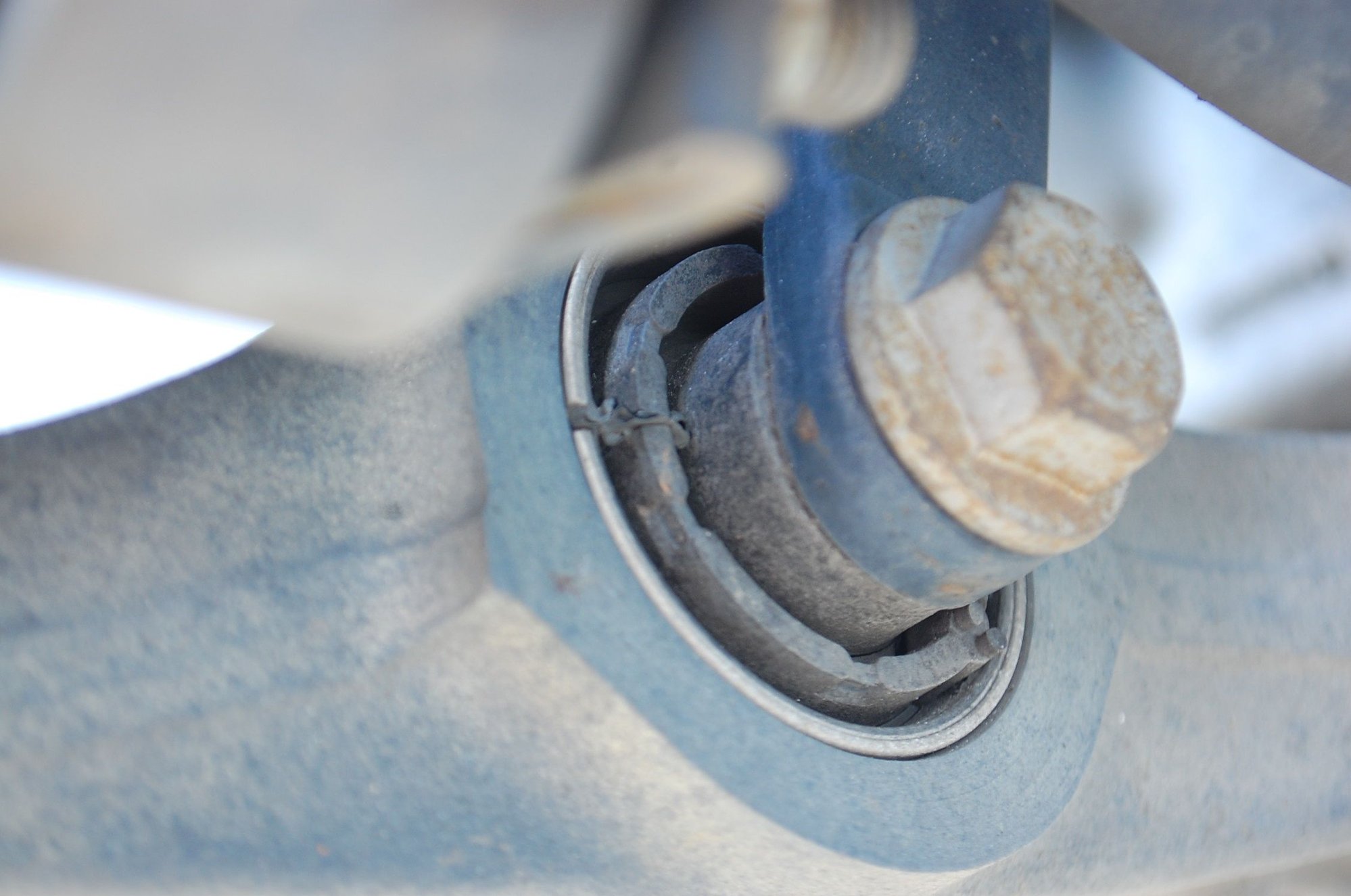

I took the wheel off and looked, and honestly I'm not sure how to tell if the bushings are worn or not. I took some pics.

Put a pry bar between the arm loop where the bushing is and the frame and see how much you can push it?
Some of those bushings are "hydro-bushings" and they have soft play by the design, what makes them harder to diagnose, but if they move easy and few mm, you know they are bad.
If they are original at 108k miles, you can easy consider their replacement. Hydro-bushings and hydro-motor mounts have shorter life than solid stuff.

Bushings seemed fine, so I took it to an independent shop that has a Hunter Hawkeye alignment machine. He said it needed the camber bolts. $114 for the alignment, $64 for the bolts, and $124 to install the bolts. $329 after tax. I hated spending the extra money on the bolts and labor to install them, but I wasn't sure what it needed and didn't want to throw parts at it.
