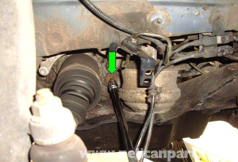

Thanks konig. So there is a front differential (similair tutorial is on the pelican parts website)

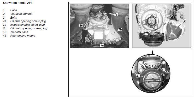

that is the guide I am referring to for the TC
File Type: pdf

pretty cool how you have access to these ! thanks for sharing them. Now that I understand it I will more than likely tackle it before winter comes, especially since I have some ATF 4134 left over from the transmission fluid change
