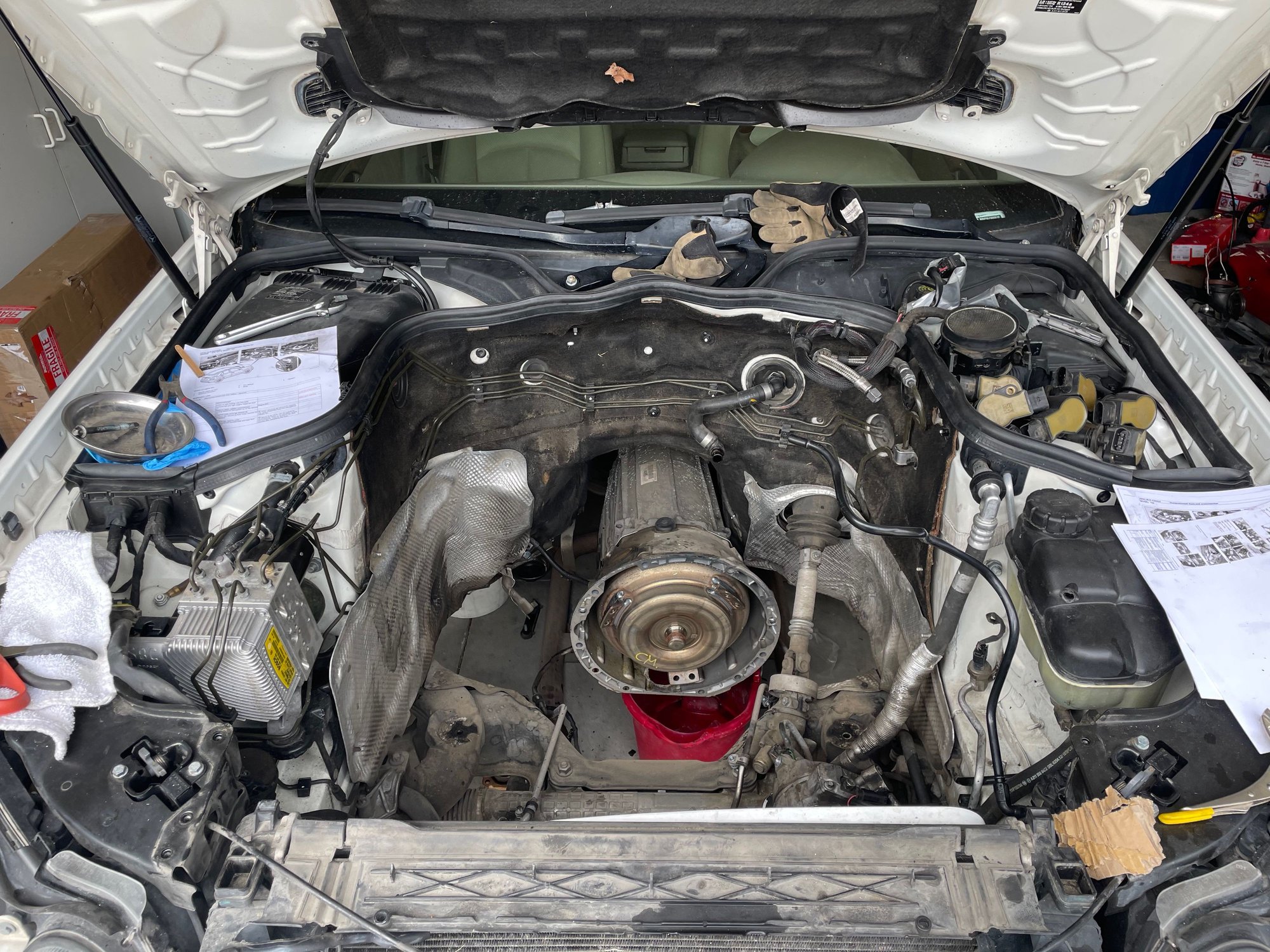

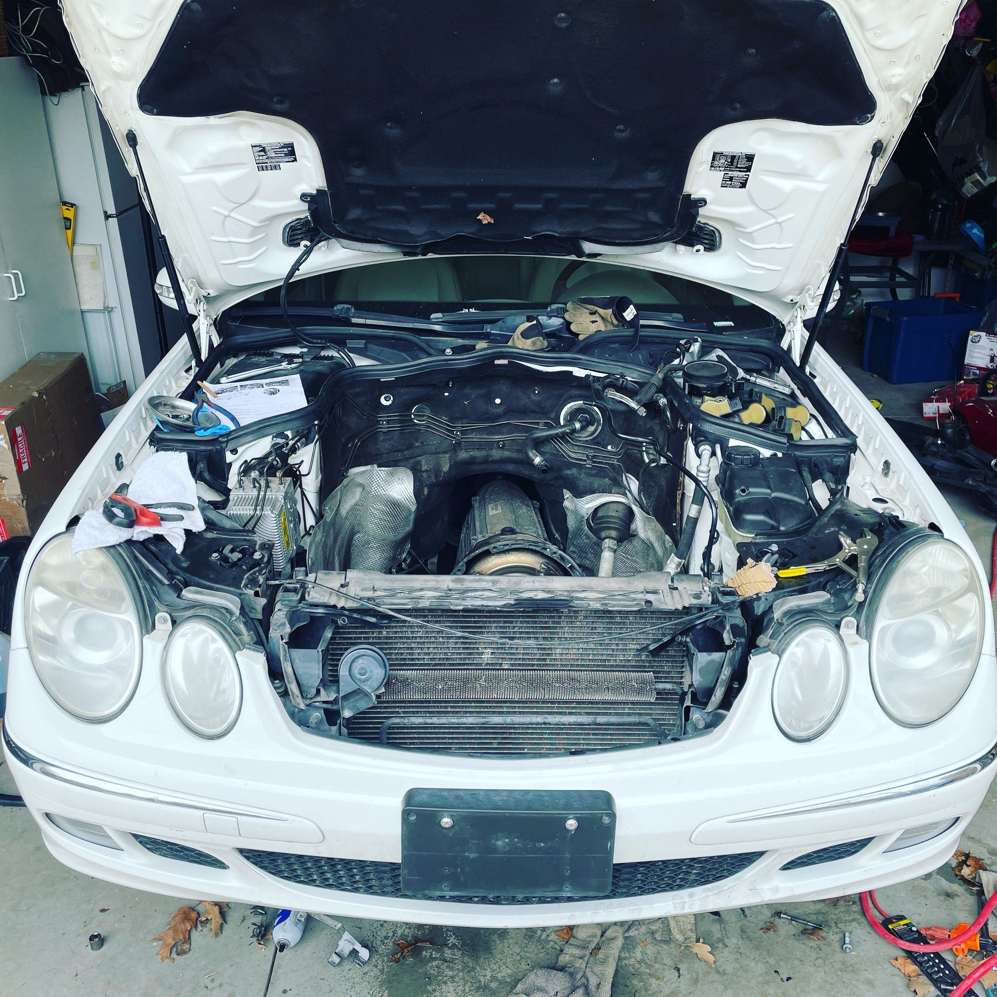

Engine is out. Thanks for the info I was able to get the engine out with few hitches. Only things of note...needed to lift the engine partway to get at the A/C compressor bolts. Also after the A/C step I stopped looking at the instructions and missed the transmission cooler lines and the ground strap for the starter. After freeing those I was off to the races.
Little time lapse of the lift:

Great job! How many hours of work from backing it into the garage until engine out? Not counting breaks, trips to the parts shop, etc.

You could open the hood 90deg to the service position to get the engine out easier.

I backed it in Saturday and had it out by Tuesday. Really just working Saturday and Tuesday evening. Maybe 4 hours or so. I studied the instructions a lot beforehand and invested in air tools which has really cut down the wrenching time.
honestly I couldn’t believe how easy it turned out to be. This is my first time doing something like this and Mercedes made it easy on me. I am coming off from spending weeks and lots of swear words on the electronic parking brake module and rear brakes of an LR3. I could have done 3 more mercedes engines before I got the darned Rover right.
the real challenge will be getting it all back together and in. I got new accessory pulleys, water pump, p/s Reservoir (broke the old one on extraction, oops), Coolant hoses and motor mounts to put on, which is dead simple with the motor out. Will need a helper to align everything and not smash the trans lines I think.

omg thank you! I looked at the mechanism for something like that but didn’t see it!
