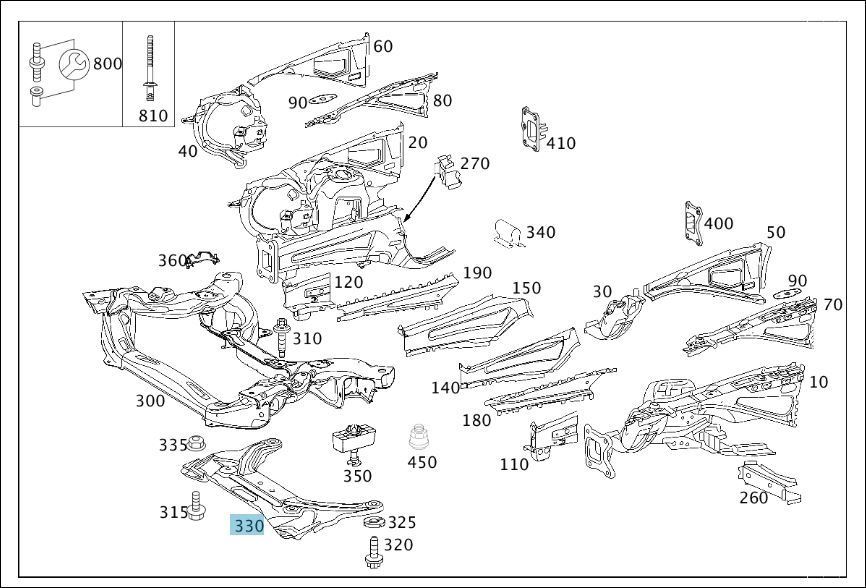

It's likely the steering rack mounting plate which is known to generate noise on early 211s. There's an updated part number.
Originally Posted by Heguli
I'd say it's the strut mount/bearing, up in the wheel well.
​​​​​​​That's an interesting theory considering that 211 doesn't have struts.
Old Jan 18, 2023 | 12:24 PM
konigstiger's Avatar
Posts: 15,901
Likes: 4,632
From: North Scottsdale, AZ
'71 Pinto
See attached bulletin.
File Type: pdf

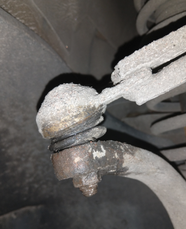

I think I found the issue, though I haven't fixed it yet.
Read here about possible suspension problems: https://vroomo.co.uk/mercedes-w211-suspension-issues/
Apparently, ball joints are lubricated inside those rubber boots, and when the rubber cracks the oil seeps out and the ball grinds in the socket.
Upper right side:
Everything else was nice and tight, albeit dirty.
I'll swap on both sides pronto. It's a $30 item weighing less than a pound, held by three nuts on the top.
