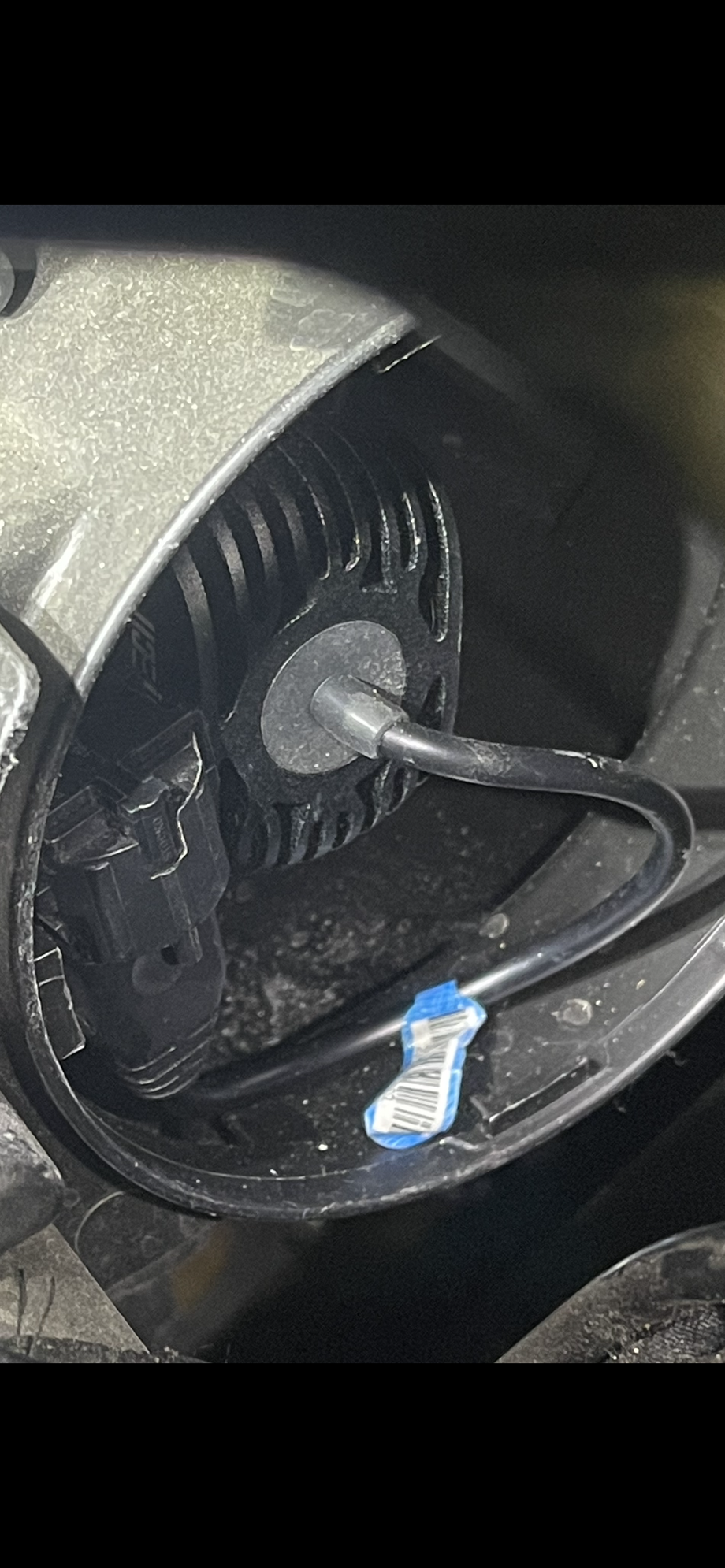

The H7 led fits perfect into the headlight housing and black dust cap also fits like a glove. Enough space between the dust cap and wires. They said that make a 2 small holes on the dust caps for cooling the fan but I haven’t done it but no issue so far…
The black triangle head is one that I have in the car. The silver rounded, newer version came out not long ago so I do not know anything about it.

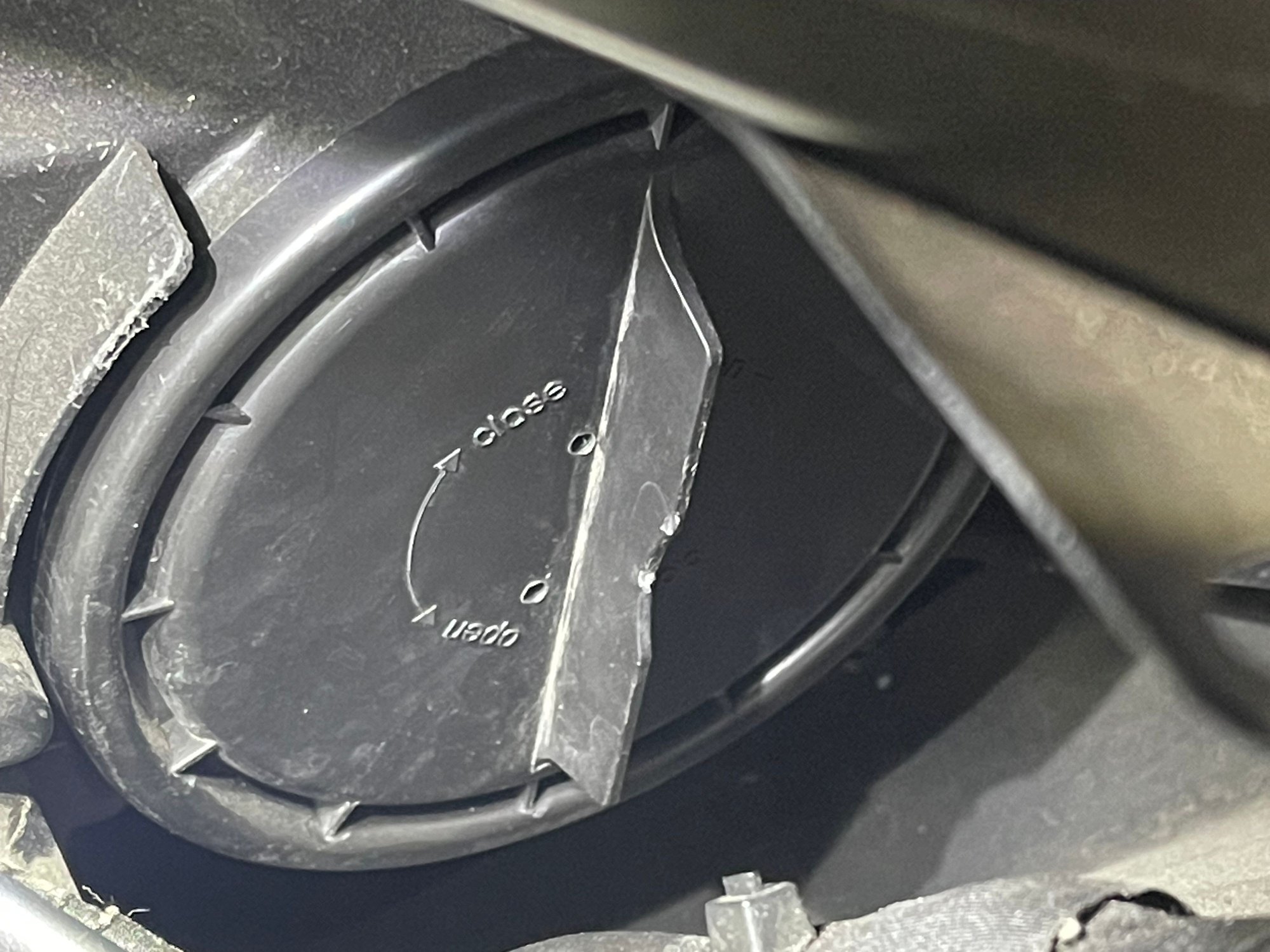

As you can see my 09 did not equipped with dust caps
Black triangle head type h7 for low beam
