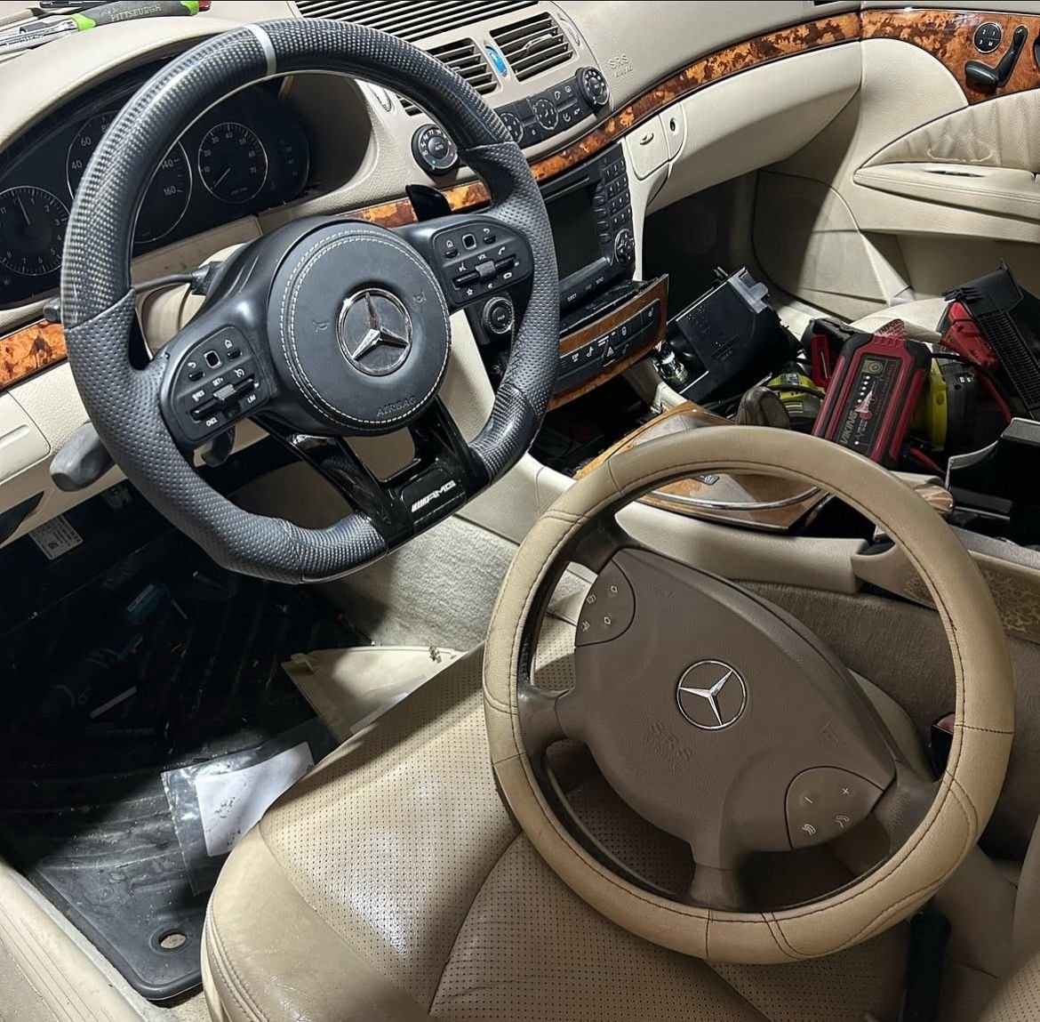

Was working on a little project this weekend
This is for 03-04 E-class clockspring updates to facelift decided to make a full write up, there are a few threads outlining the job already but the information is scattered throughout a couple pages. Iv consolidated it all here

This swap is for users who want a facelift wheel, example e55 swapped to e63/cls55 wheel
The 2020 wheel is my personal touch
Reason for the swap is I’ll be doing some product testing of a w205 swap but worst case I’ll just rock a 2020 wheel

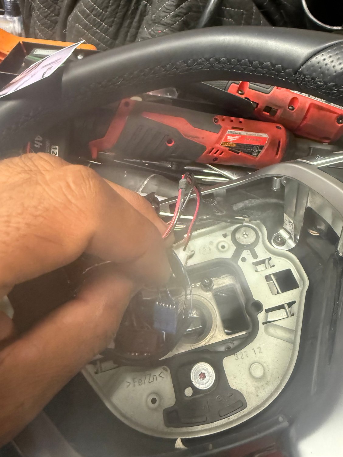

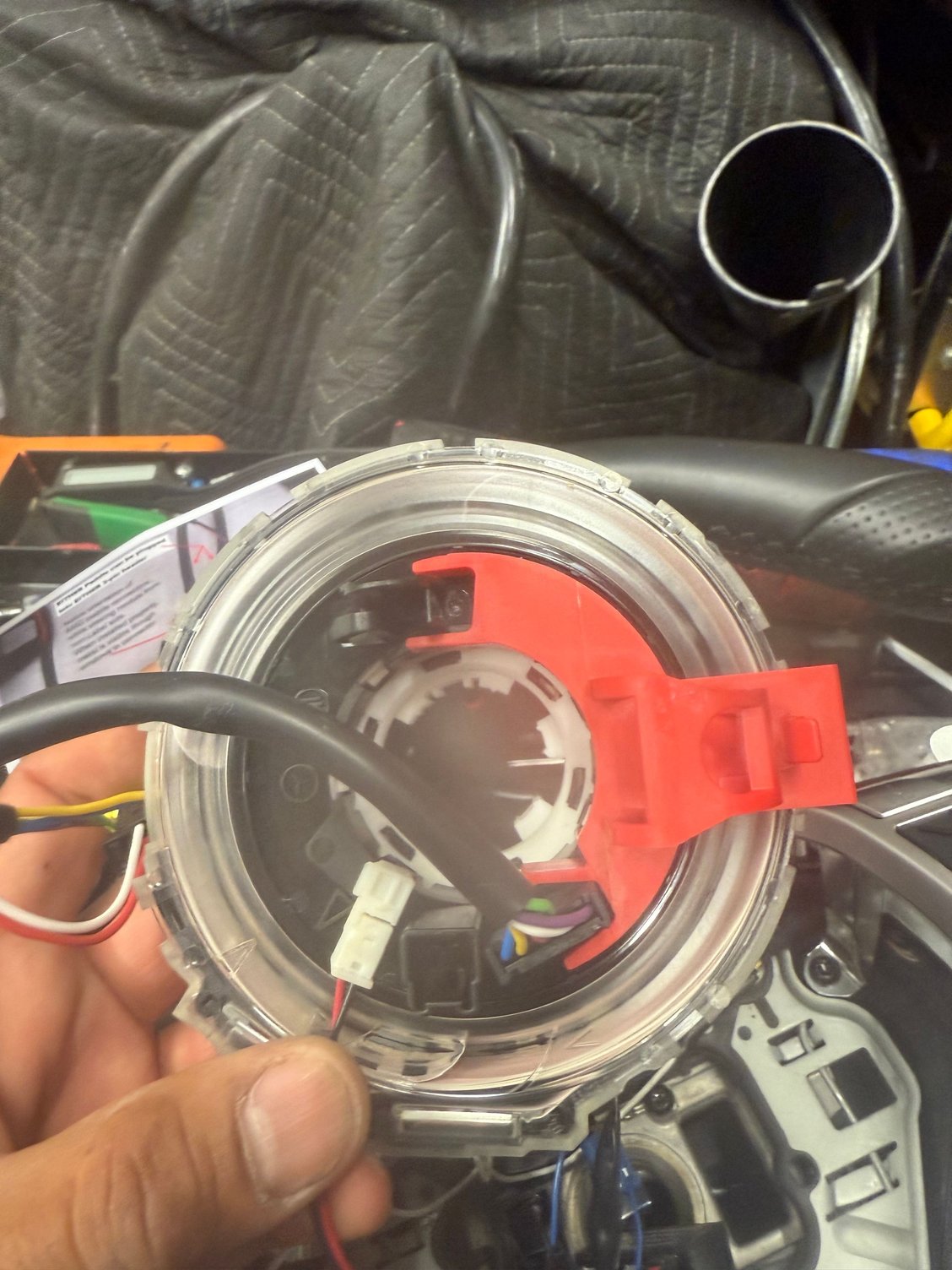

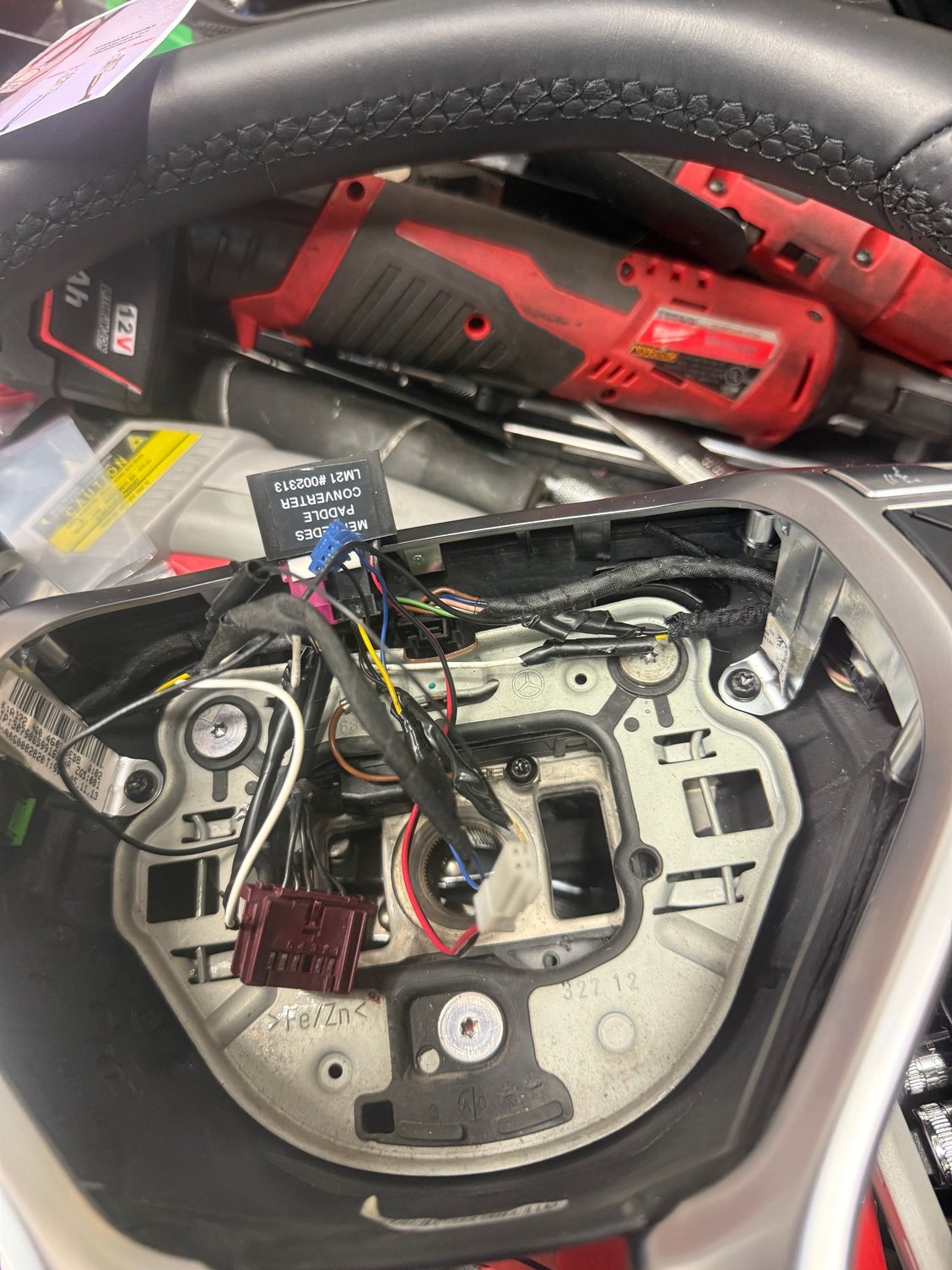

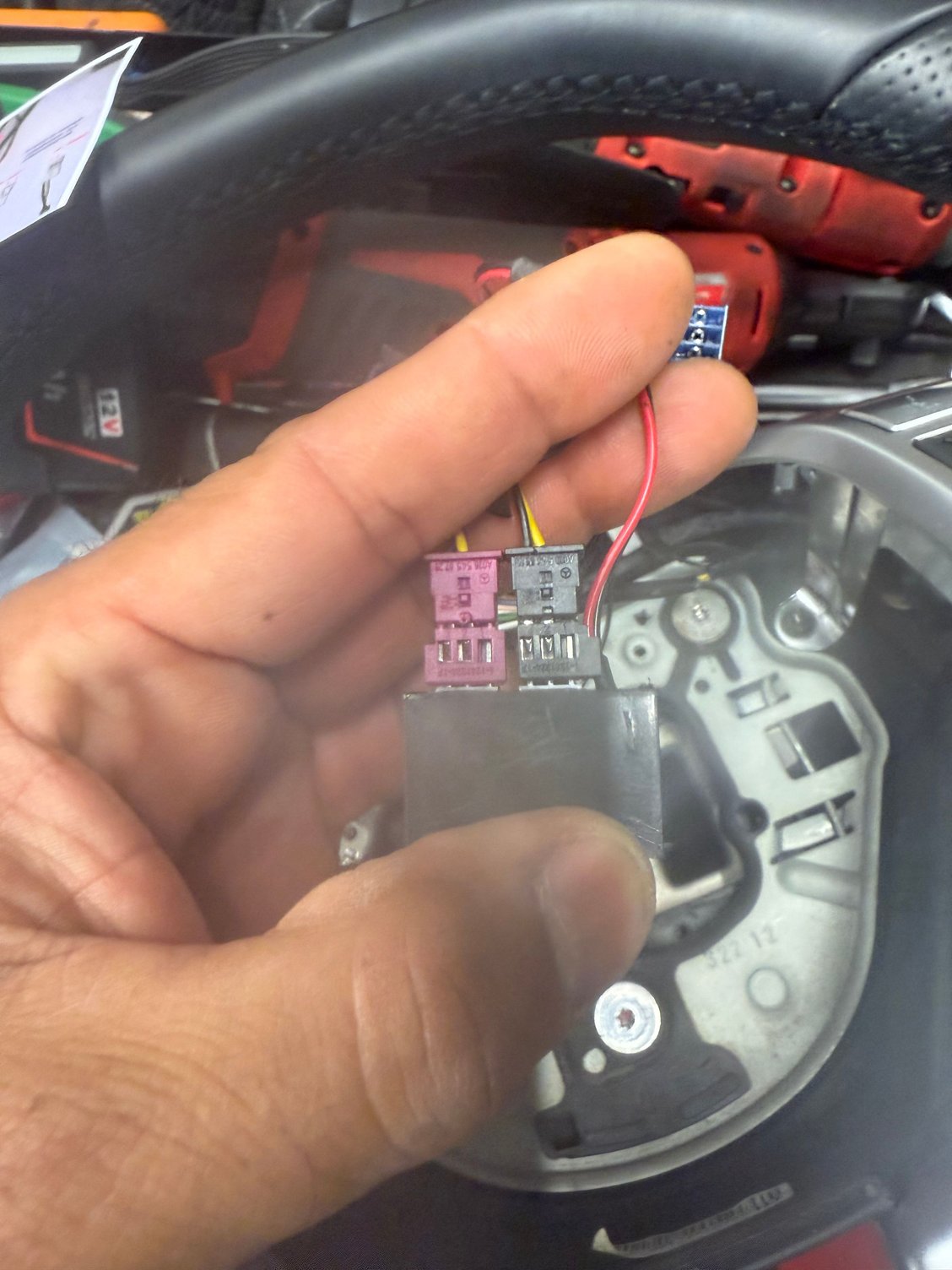

I was putting in an updated steering wheel from a w212 with the harness and airbag. I also picked up the module for the newer shift paddles - I am not sure I wired those properly either. I attached photos - can you take a look and provide any guidance? I appreciate the help.
The white plug is different from the female connector on the clockspring. I did also purchase an updated steering column piece that houses the clockspring.
This is the updated closkspring I bought. One of the used steering column housing with the cloaking was broken so I bought a new clockspring
This is the paddle module - I am not sure I connected it properly.
the write up I have is updating a w211 prefaclift steering column to a facelift. You’re trying to retrofit a much newer setup. Totally different
I doubt my wiring instruction will work with that.
maybe start by pulling up the schematics for w211 clockspring wiring and w212 to make you’re custom wiring harness
good luck

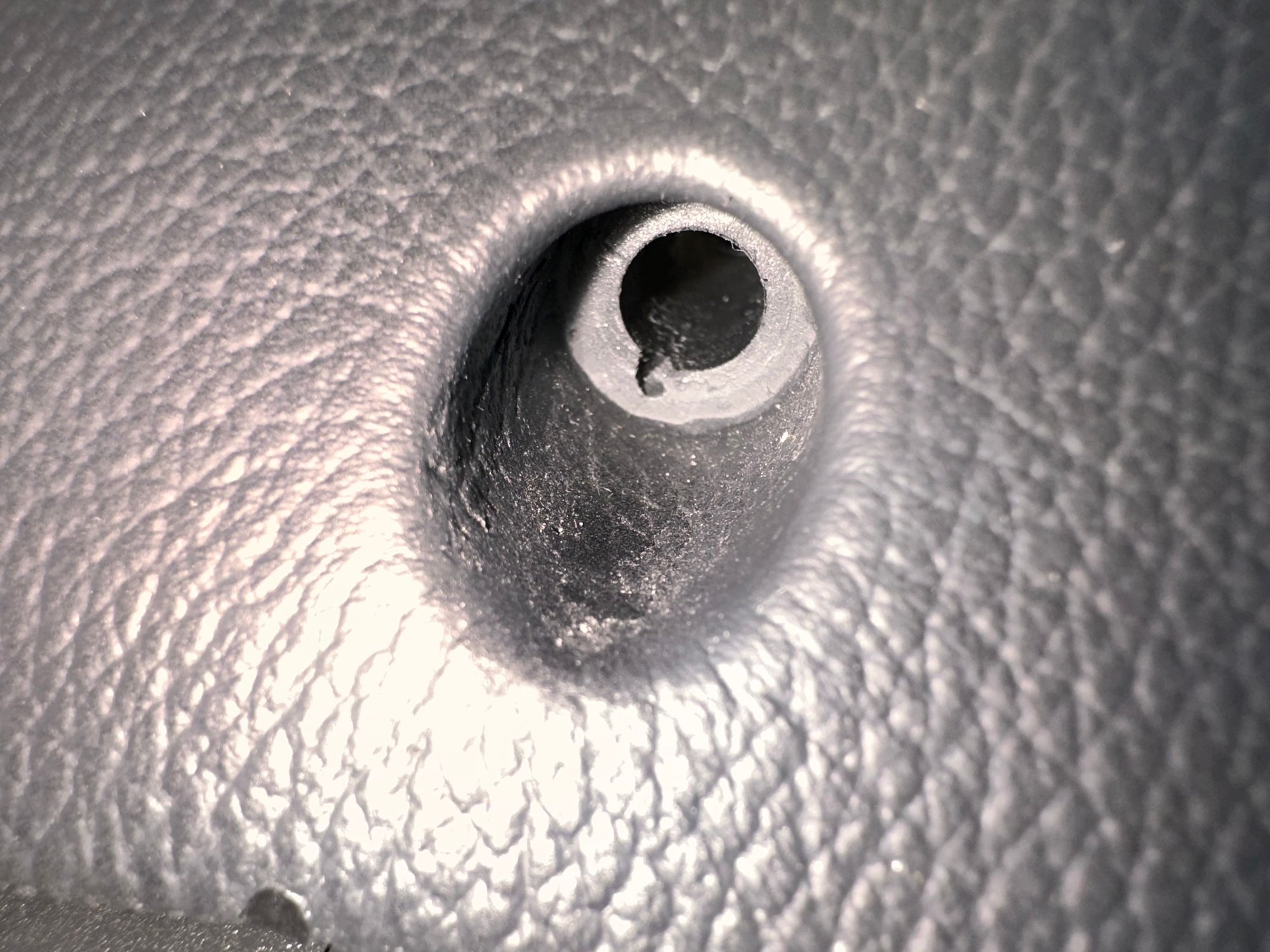

I have a 2006 E500 with an old cracked leather steering wheel, got a much better one with wood. Went to remove the old one and looks like there’re no screws in those wells on the side of the steering wheel.
Do I just pry the airbag out?

iv never in my life seen those bolts missing. If the bolts arnt there the airbag would just fall out

I looked at the steering wheel I was going to install in place of the old one in the car and figured it out!
The screws are deeper in those holes and concealed, they are integrated into the steering wheel and don’t come out! Silly me!
