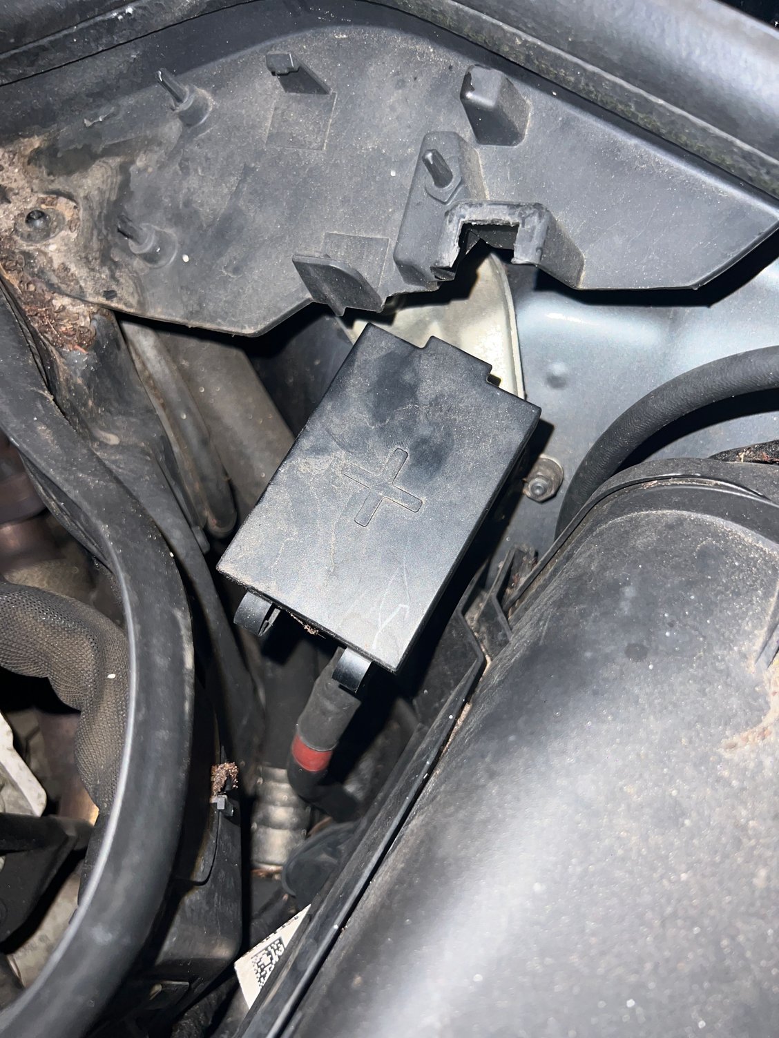

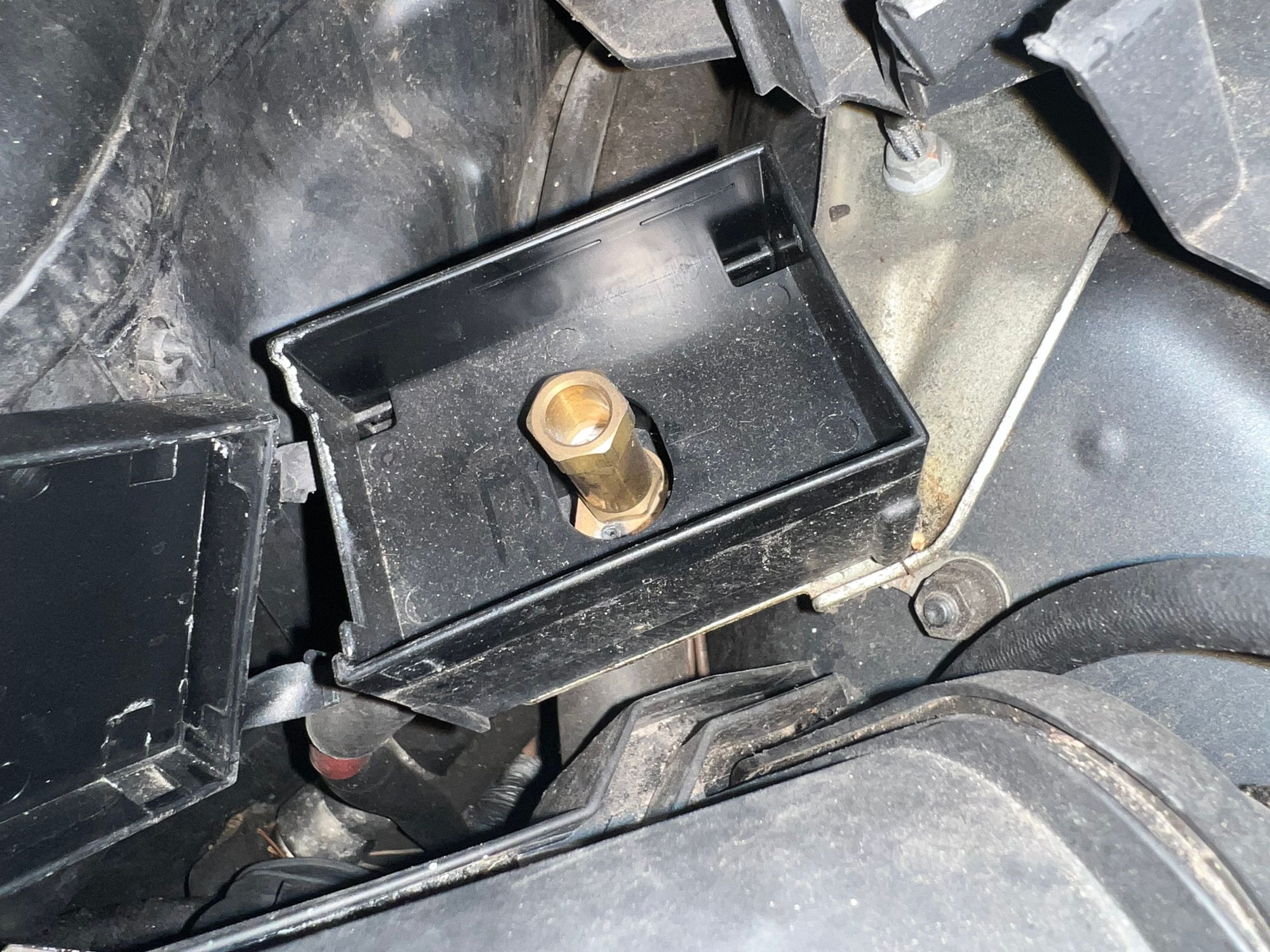

From the engine bay?
There’s a small fuse box looking thing on the left side near the windscreen that that has a red + 12 printed on it you can clip jumpers to that and black to the body and run it for a few minutes. I looked in mine. It’s above the dip stick under a vent cover. Size of a match box
if you could get power you could use the electric release?
Not all have that jumper post: https://mbworld.org/forums/e-class-w...ngine-bay.html
