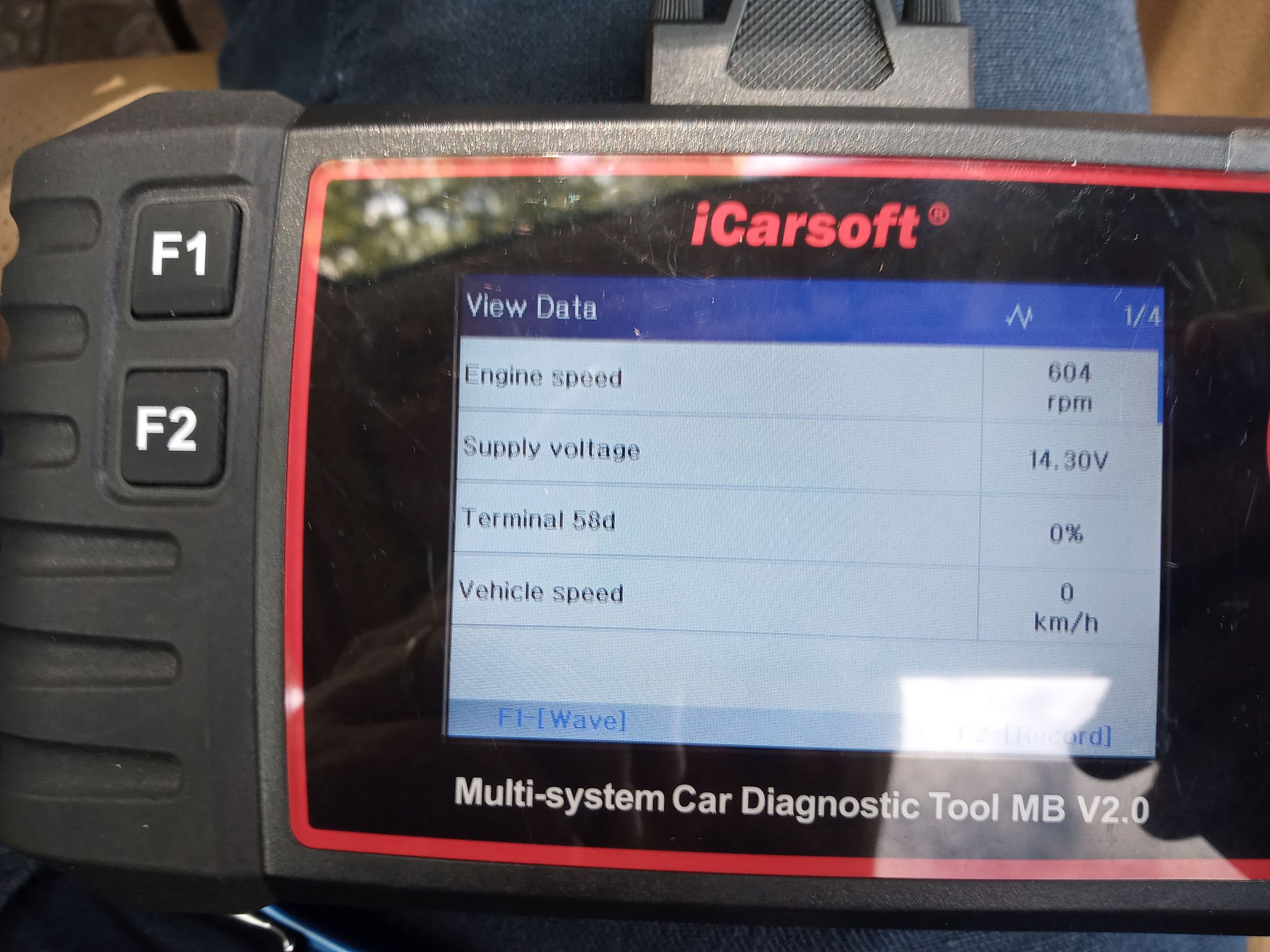

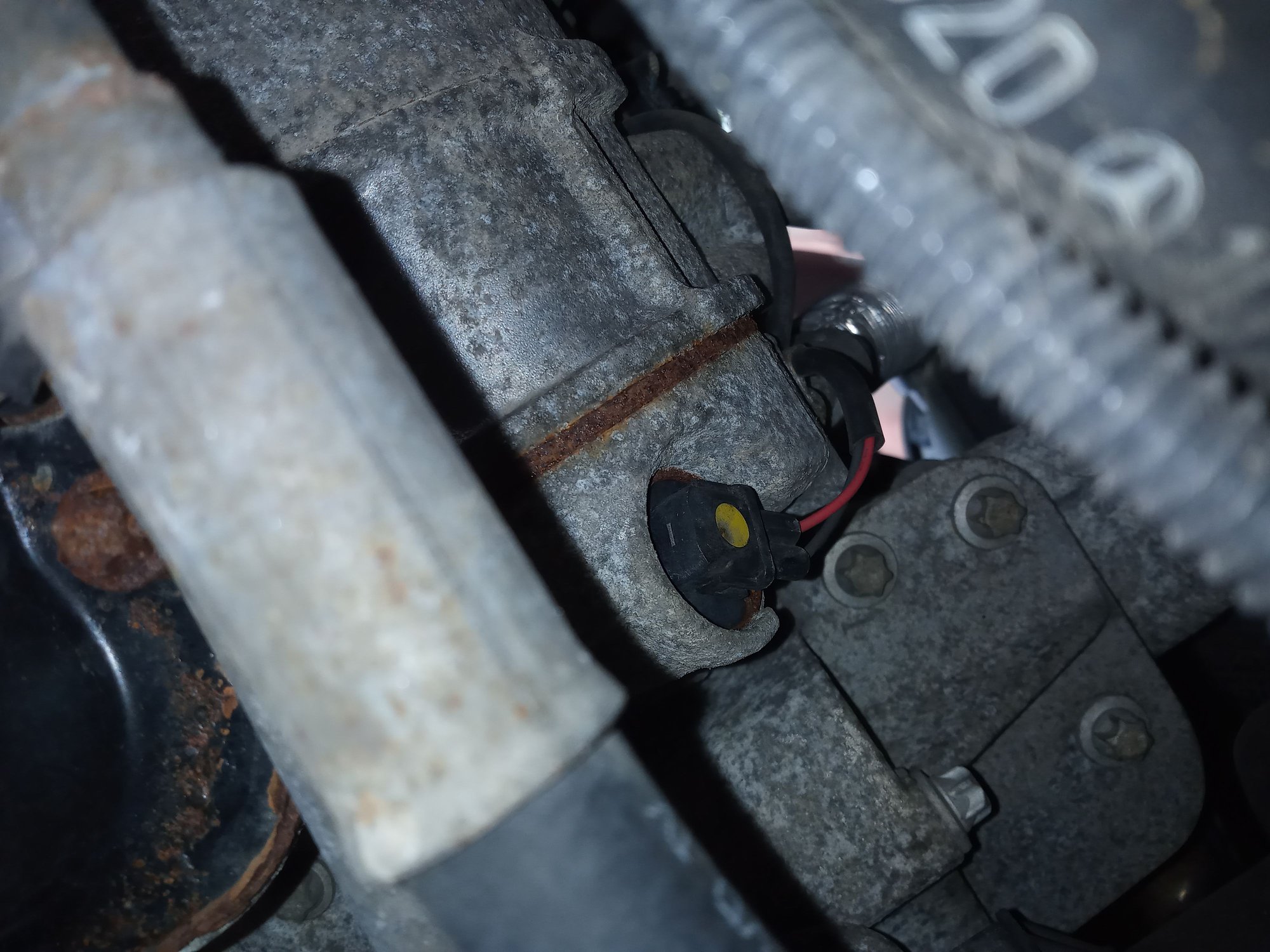

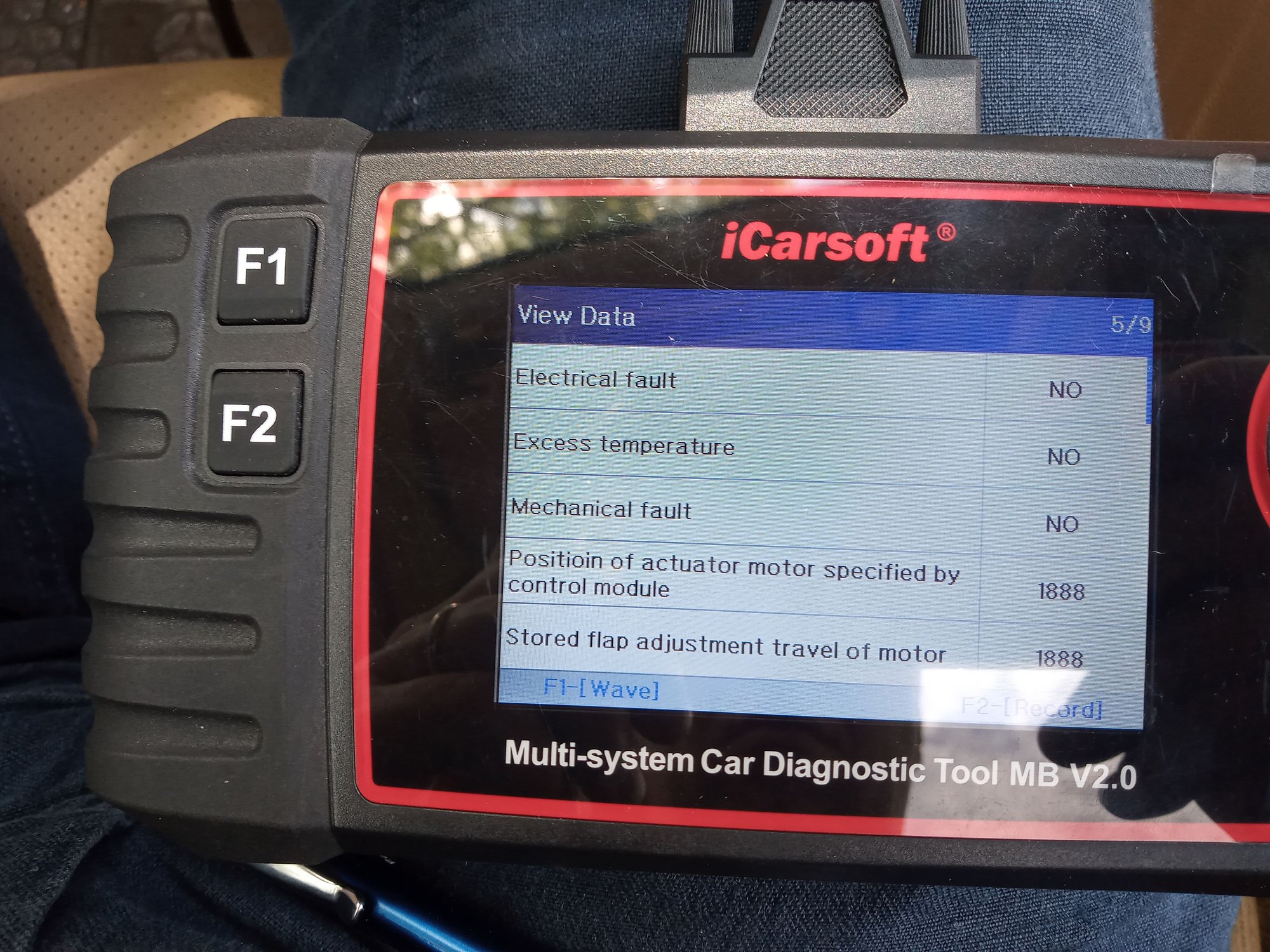

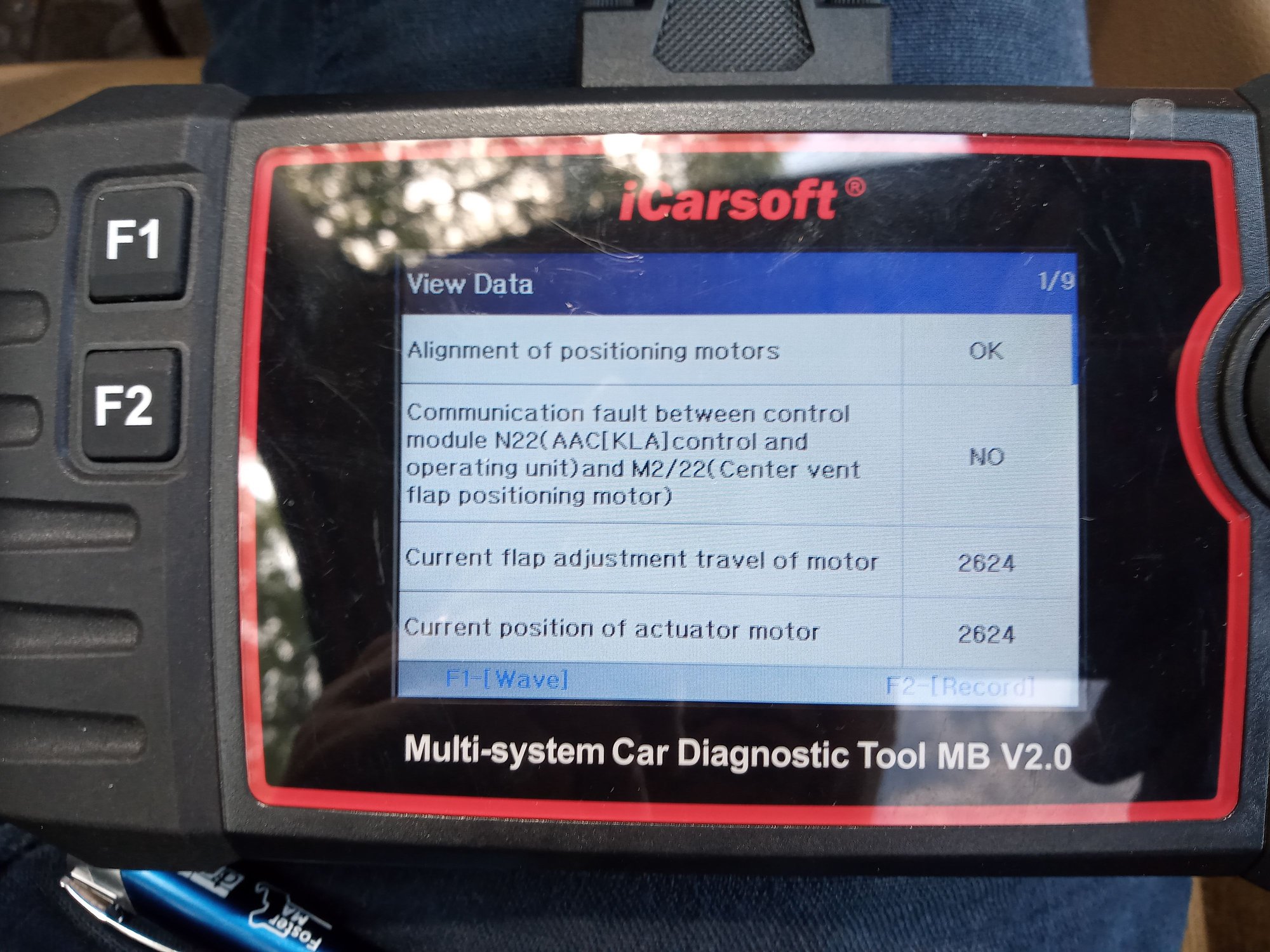

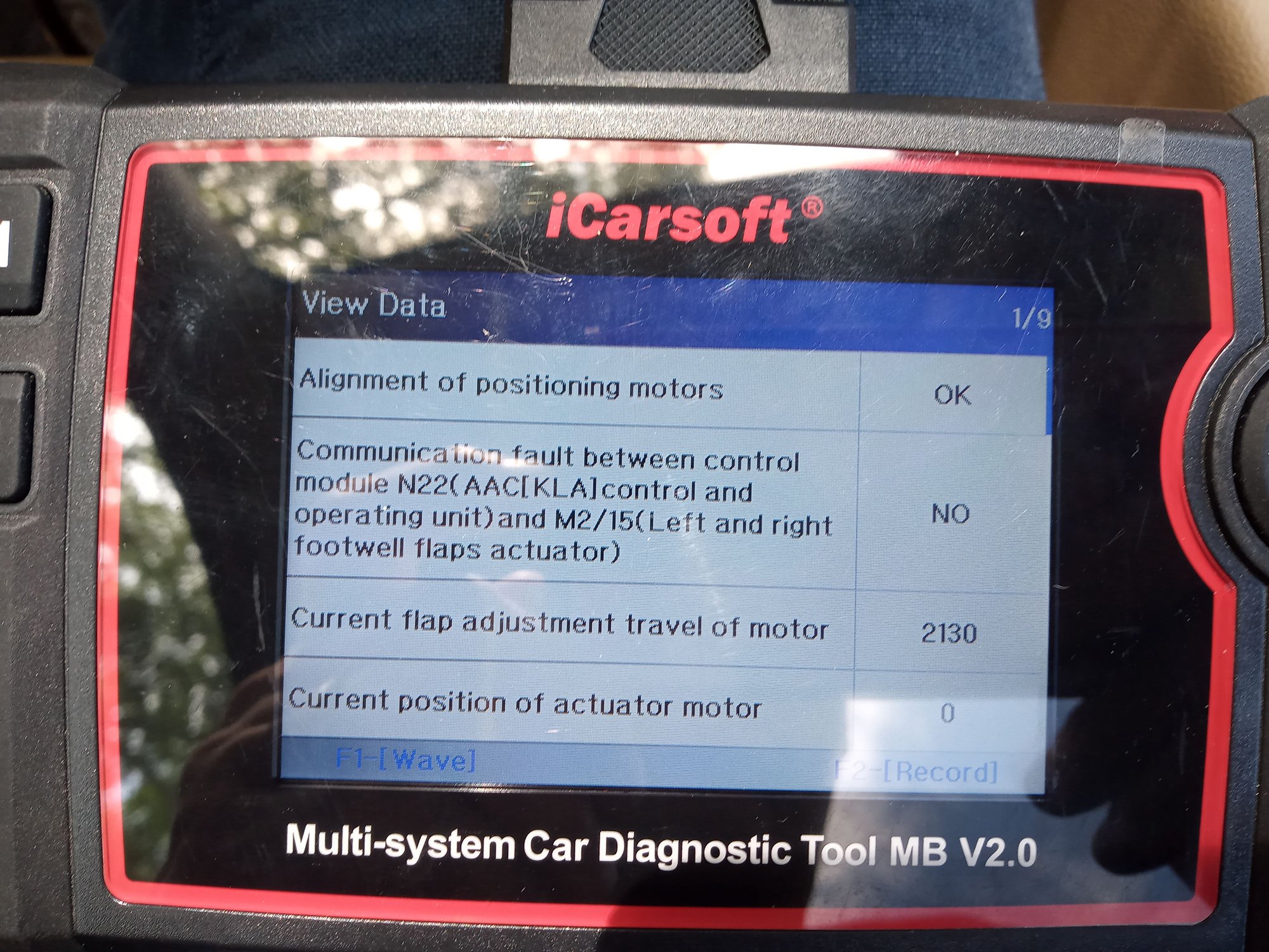

I took some screenshots with the AC parameters. Do you see anything wrong? I think, my problem is the control valve, like in the post referenced above. Sometimes, very rarely, AC starts and works just fine, but most of the time it just blows warm air. How do I buy the correct valve? The compressor is probably original Denso. Front plate of the compressor says "PPS-GF40". The valve has "7Y09Y" and "II" on the back. Also, I would greatly appreciate more details on how to remove it. Is it better to leave, say, 5-10 psi in the system (or more)? What tool can I use to pull it out? The only thing sticking out is a connector cap. How do I grab it?
