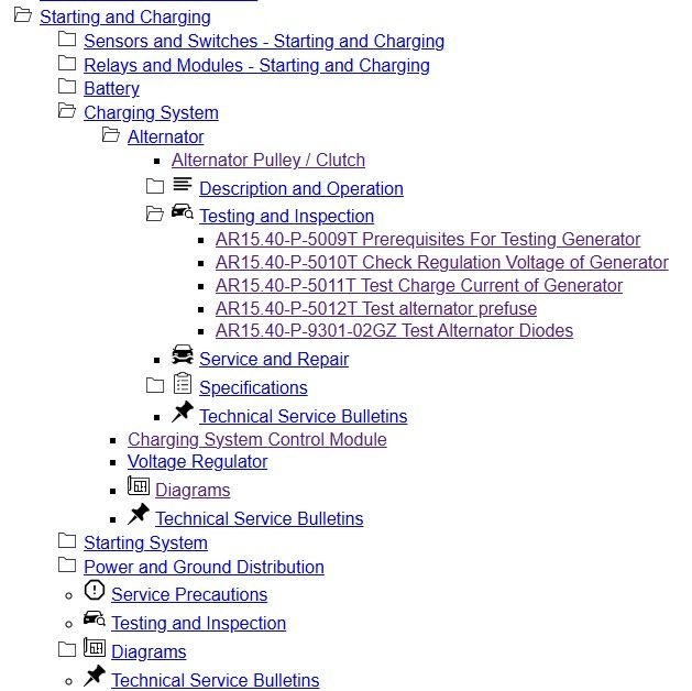

If voltage is 11 volts and under after the "alternator fix", the alternator ain't fixed. The car ran as long as the 900-1000 Cold Cranking Amps battery could provide power and then the car began it's scheduled "graceful degradation" of shutting off systems one-by-one until you either park the car as soon as possible or crash it into a ditch because the auxiliary battery (emergency power to the SBS braking system) runs down, and the computer actuated brakes fail.
Could be the "new" alternator. Could be the Battery Control Module. You either need the money to pay a good independent shop to diagnose or have the ability to do so yourself. I don't know your background so you need to decide for yourself.
Do you have a diagnostic system that will work with your W211? If not, get one. If you cannot afford the diagnostic system, sell the car. Seriously. Not being a dick, just telling you what I have learned over 12 years of ownership of two AMG Mercedes. The last five weeks cost me almost $1500 in parts for my W211. That can be frustrating because of the money and my time invested. Inspected my W210 today and it looks like I will be out a few hundred dollars in parts and a day of my time to make it safe and reliable again.
Assuming you have the ability (not slamming or disrespecting you, I genuinely do not know your skill set), download the WIS (Workshop Information System) from Charm.li. You can read it online or download the .zip file and install on your computer. There is a rather lengthy section detailing how can diagnose the charging system end-to-end exactly as the MB techs would do so.
Be advised the .zip file is 1.2GB in size and Win11 will choke at 1.0GB. You will need an aftermarket downloader for the .zip file if you want to keep it on your computer. If not, just read it online.
You can pull up the voltage on the electrical bus on your instrument cluster. You will find several videos of how to do so on Youtube.

The Auxiliary battery is intended to provide power to the SBC computer-controlled braking system in event of a main bus failure. I've posted on this before and attached the technical documentation to support this. The main battery is the main battery, not just a "starter" battery. It provides power to all of the modules on the distributed digital bus. If it fails, the Auxiliary battery is engaged to provide 15-20 minutes of power before complete system failure.
It is possible the deep discharge of the battery after electrical system failure caused the BCM to go into a "safe" mode. If so, it can be reset by disconnecting it from the harness for five minutes.
If the BCM actually failed, it will default to a (IIRC) charge voltage of ~12.7 volts; not enough to keep the battery charged.
To test the charging system from end-to-end, download the Workshop Information System and perform the following tests listed in "Testing and Inspection":
Description and function of the dual-battery system is attached to this post. Save it. Read it.
SBC system tech documentation is also attached. It explains what happens when the main battery and then the Auxiliary battery fail; two solenoids fall open when power fails and you now have unassisted hydraulic braking to the two front calipers. At that time, I recommend stomping on the parking brake and then standing on the main brake pedal like King Kong while downshifting the transmission into lower gears as fast as you safely can. The car is literally a two-ton mass of metal with very little to slow/stop it if the brake-by-wire system fails. Plan ahead and practice emergency procedures "just in case".
