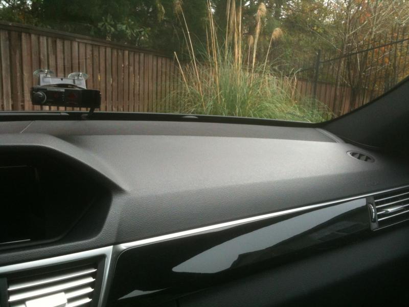

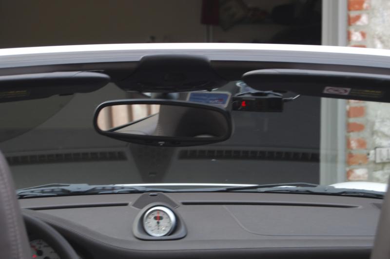

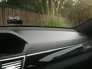

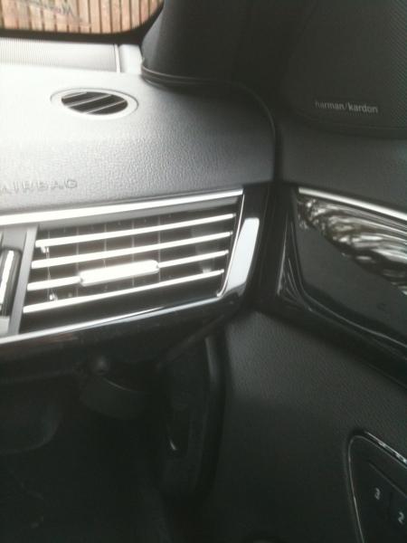

So here's my quick and dirty "install." The wire tucks (as mg-E550 said) pretty well between the glass and dash. Just about 10" exposed along side but not bad for $3.49 phone wire.
If I want hidden better or up by rearview mirror, I think professional help is needed. That's how I have it my 911 (Last pic) but it cost me $$. The other reason to hardwire it in the 911 is you have to have it wired in to a line that is off when the car is off because the cigarette and accessory plug are always hot.
