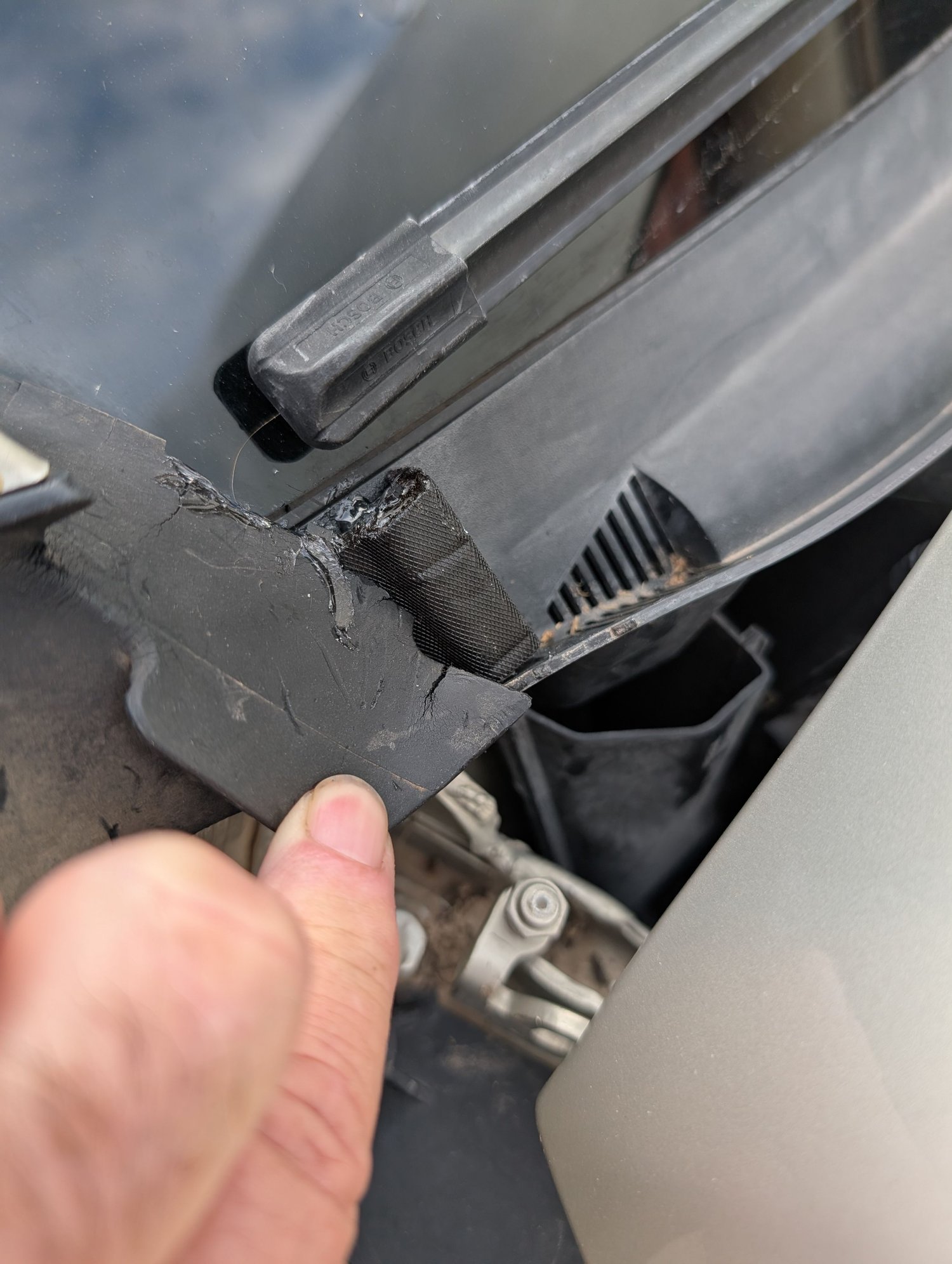

MB E350 Cowl Drain
Here is a picture of the drain. You can see how the rubber I am holding is cracked and actually part is missing. As water runs off the front window it should drain into the vented area shown. The damaged rubber flap stops it from going past the drain. To stop the flow from going past the drain I glued the textured rectangle piece you see by the drain.
Located at bottom of windshield on passenger side.

Originally Posted by GMBrownSr
Here is a picture of the drain. You can see how the rubber I am holding is cracked and actually part is missing. As water runs off the front window it should drain into the vented area shown. The sun damaged rubber flap stops it from going past the drain.
Nice one, thank you!

The driver's side cowl drain is a different layout. I'm not experiencing any issue there. I found this problem while trying to track down a problem with my display for the Command system. My problem is the screen on the command system. The audio works fine, just the screen is black also no picture from the backup camera.
2011 to 2025 = 14 years.
The rubber weather strip you are holding , is it also "sticky" ? Aside from the cracking.
It seems more sunlight damage , aside from 14 years of age...yes ?
I too been wondering how long it will last for , if for a sun protected garaged car.

GMBrownSr's Avatar
Joined: Nov 2025
Posts: 7
2011 MB E350
No it's not sticky. I'm 99% sure the damage is from sun damage. (Located in Phoenix, AZ)

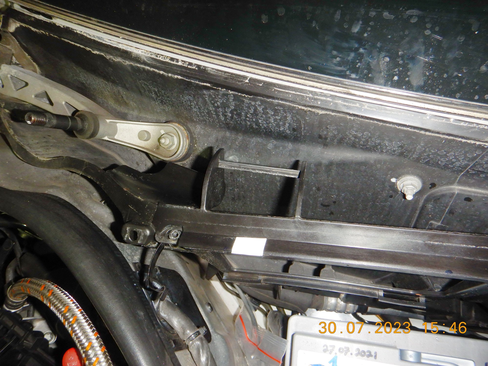

I just noticed.... where is your wiper cowling "rubbery" edge ? The one which seals the hood when hood close ?
My plastic wiper cowling assy is like 2 years old only. It did not tear or anything, but look dull. So I got a new one.
My windshield side rubber weather stripping is as old as the car, 2014.
My car is Right Hand Drive.

My issue is best viewed in your second picture. You can see the drain grate next to where the wiper attaches. My damaged part comes from the edge of the windshield down to the cowl. Yours looks in good shape.

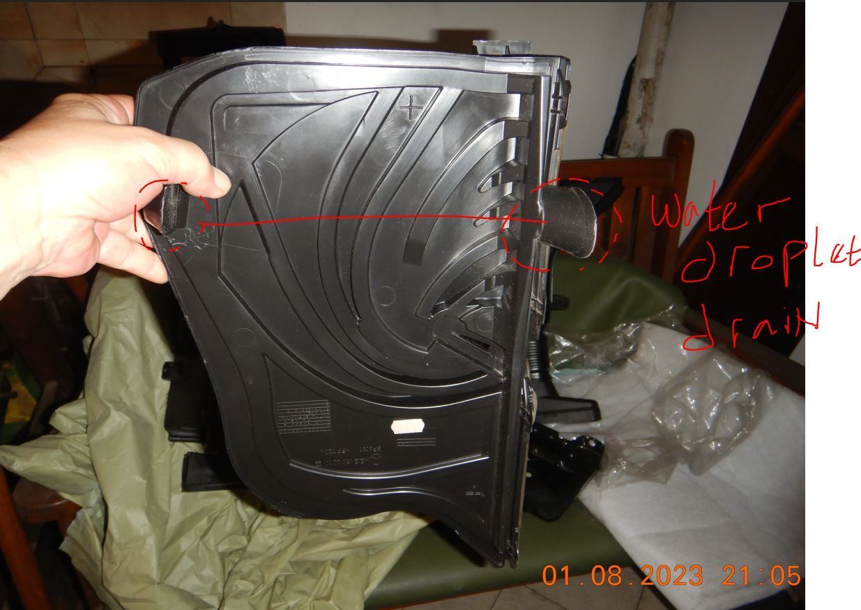

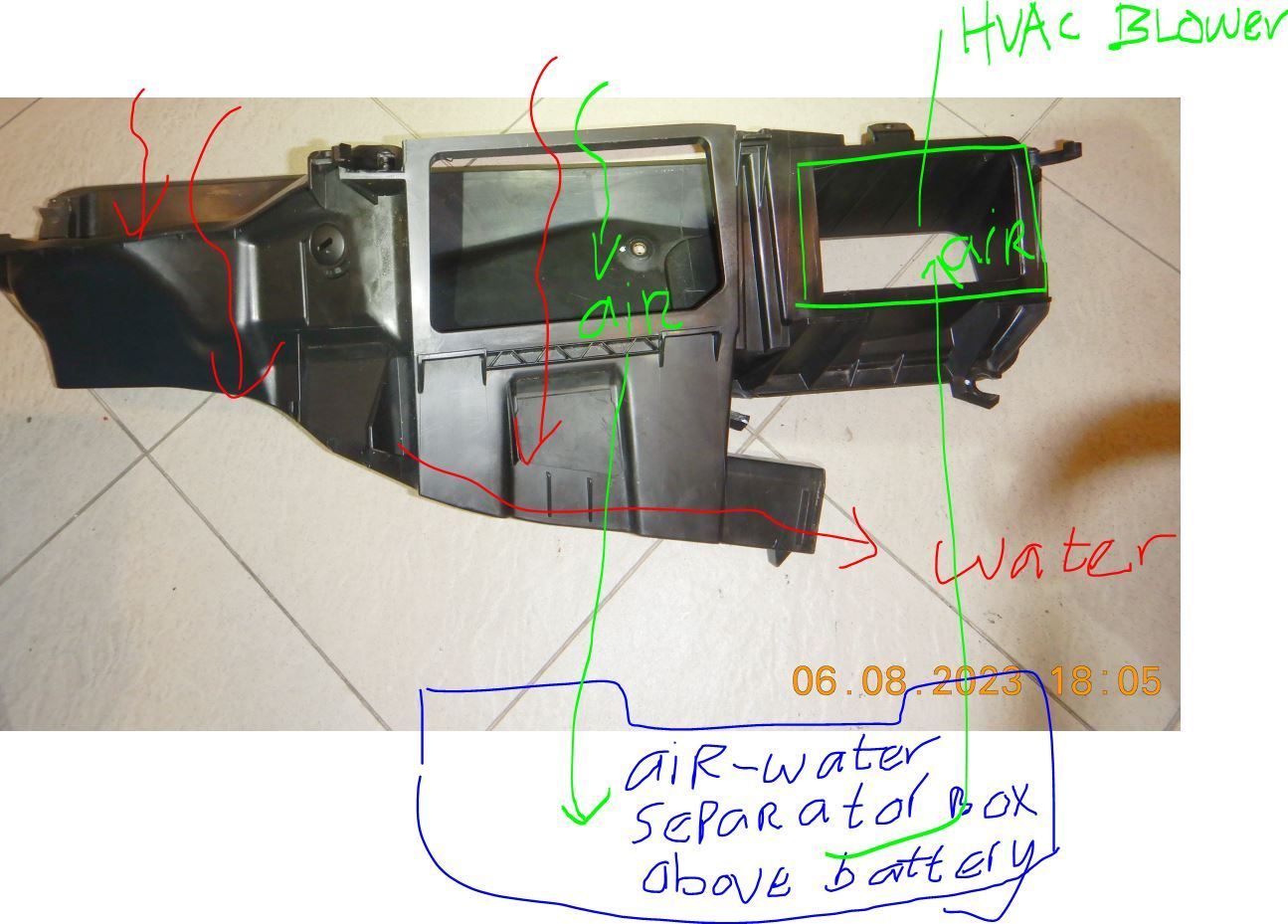

Your description in green is wrong : But my goodness, what a silly setup to run the cowl drain through the HVAC system!

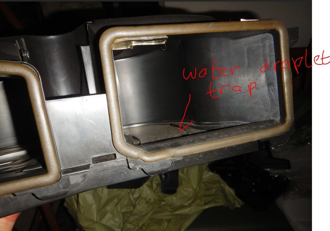

The air separator box above battery is water separator for HVAC blower FRESH AIR INTAKE.
Yes, the air separator box uses the cowling for fresh air entry.
Only when car owner is so ignorant and never clean their drain water path or the plastics or foam seal have cracked and whatnot, water will not enter the HVAC blower.

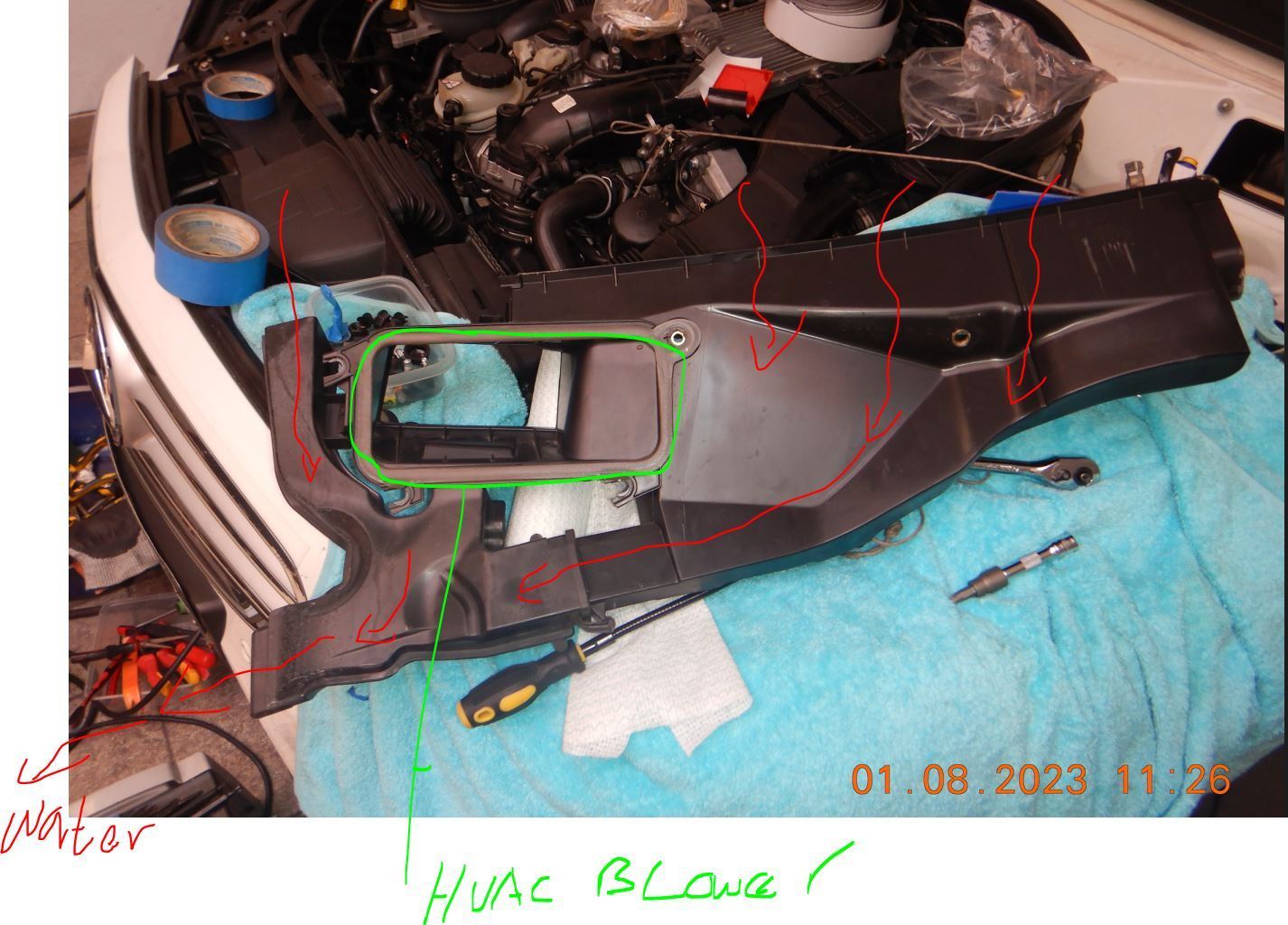

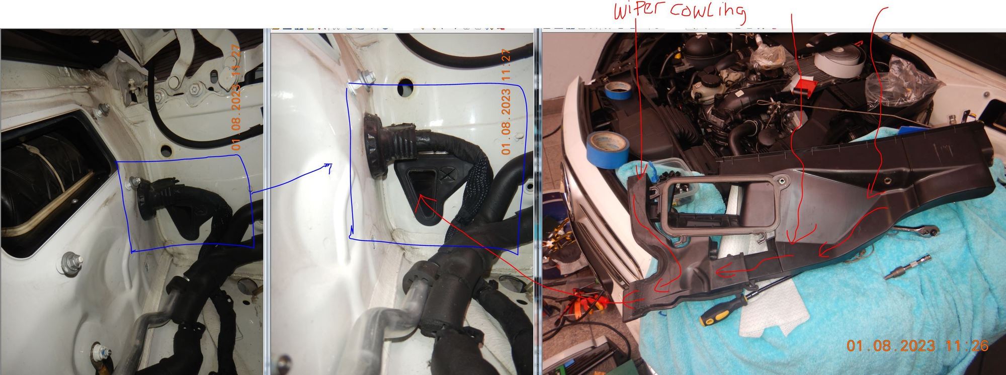

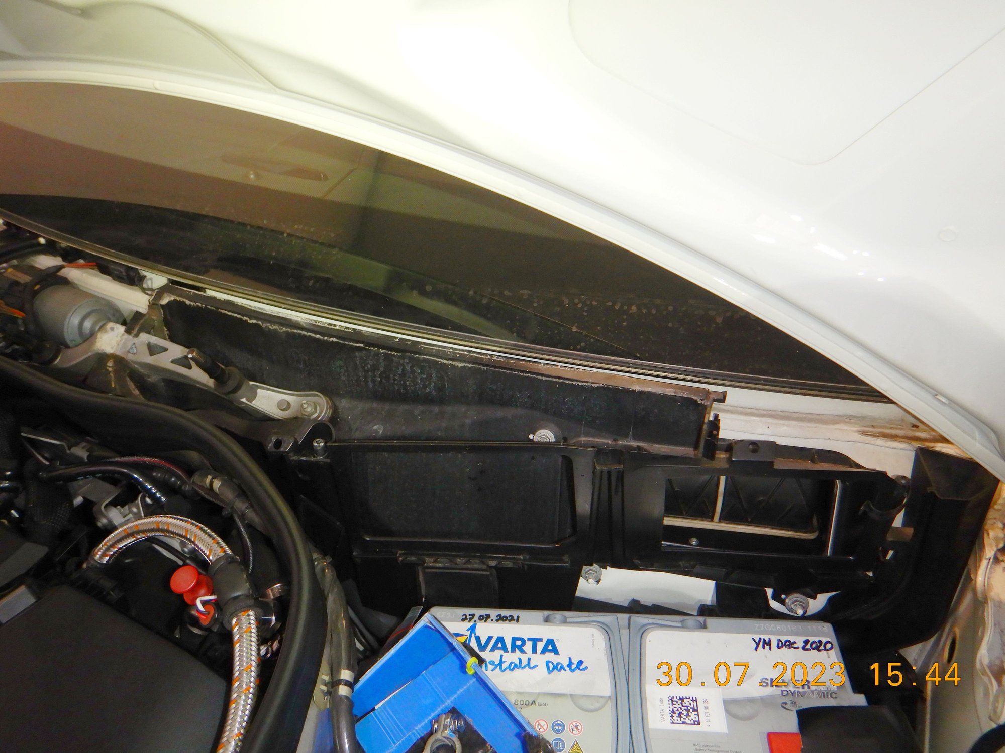

Do you know how many liters of water being stuck at the water catchment plastic casing below wiper cowling for it to be able to "flood" the HVAC blower ? A LOT....
This is the water catchment + drain plastic casing below wiper cowling , mine is right hand drive car, use your imagination for Left Hand Drive car yours is.
Water catchment + drain plastic casing below wiper cowling , as installed.

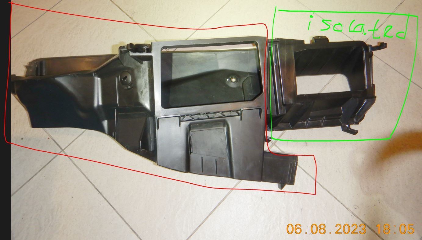

The HVAC blower zone is totally isolated from the wet water zone. Thus the air-water separator above battery box is needed to deliver air to HVAC blower.
Its firewall side, the seal is for the HVAC blower fresh air intake.
Again, I am reminding : the HVAC blower fresh air intake is isolated from the wet rain water zone..............., unless plastic or seal cracked or something clogging so bad,

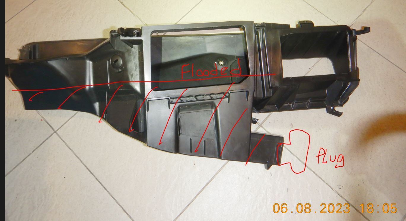

water level rise up so high

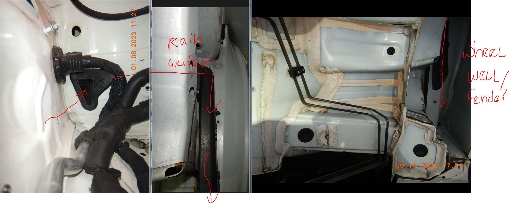

The air box above battery, is the air-water separator for HVAC blower air intake.
This is the final water drain......... at wheel well/fender. Both Left and Right side has this plastic water drain pipes
Now do you understand how much lazyness and uncleanliness + mechanical wear or damage .........have to occur, before one can flood rain water to HVAC blower intake zone......
This is pure neglect in my book, if ever my car can have rain water entering this way..........except BAD LUCK......if the front windscreen sealant failed a bit , not common but have occured.
If the flooding is up to the level I marked above in red, the air-water separator box above battery probably can not handle that much water, albeit it has its own drain too....which probably clogged too........
...............only then the HVAC blower intake get the water.
3rd reminder. HVAC blower air intake zone is totally isolated from wet water zone.
