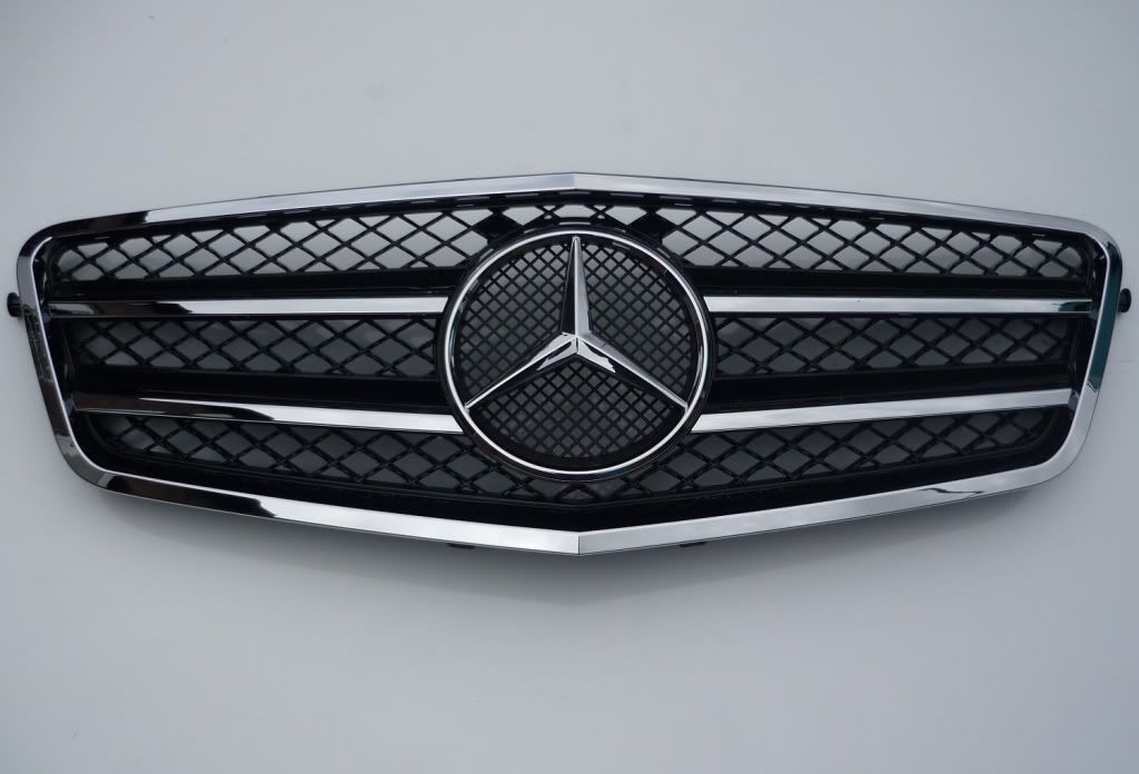

5-Front grill:
My car comes with luxury grill, but I like 2 other models:
The grill with the star:
Then I bought the OEM Distronic grill which I found nicer: A2128800383
I did change the traditional hood star with flat bonnet
Part number: A2048170616
