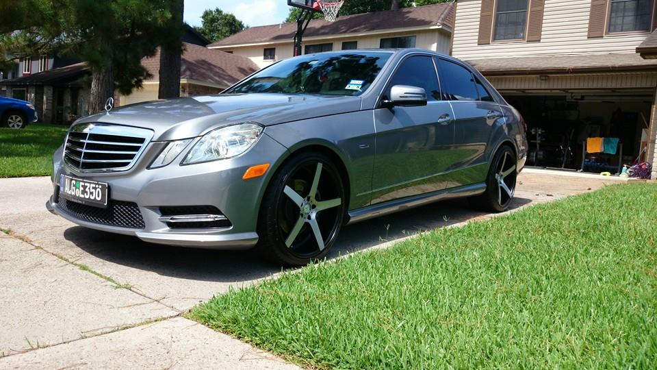

Here's a quick pic taken with my phone. I'll post some nicer pics soon. Thanks for helping with my sizing questions. They fit great!
Attached Thumbnails I Need Help With Tire Sizing For XO Miami 20" Wheels-alg_e350.jpg

Looking nice. Question, was the pictured car dropped with http://www.ebay.com/itm/271487879855 HR springs? Do you know how much of a drop was it was with the new wheel/tire comb? How much did the HR Spring actually drop the car? We're you able to fit 2 fingers into the fender well ? Most appreciate your answe and photos if possible.

H&R Springs drop the car ~ 1" front and rear and helps the car look great without rubbing
preffered tire sizing is
245/30/20
275/30/20 or 285/25/20
the 285/25/20 tires are really hard to come by right now as most tire companies are switching models so they aren't producing the usual tires to be in stock.

Looks nice! Drop it if you are thinking about it

Davidkuo0330, I didn't install springs on the car yet and am not sure that I will. I can just barely get two fingers between the tire and the fender. It really doesn't need to be dropped IMO. There is another set that drops the car a little less .6" and I may get that, not sure yet... I will post better pics this weekend.

Thanks bro. Man, I'm a little worried that I'll rub if I lower, I can barely get two fingers under there. Do you think it will rub lowered?

I know much less than others around here, but for comparison I dropped my 2010 sedan here (on 19s though after springs settled)
2010 W212
On my coupe, I run 20's and I get slight rubbing on the rear when I have adult passengers and hit a decent sized bump or dip. Hasn't quite settled yet.
2014 C207
I did have to get 3mm spacers on the front since I was rubbing against the strut. But I think the coupe doesn't have as much room as the sedan. Again, guys like threeMBs know much better.

Beautiful rides! I'm going to take it here next week: http://www.americanwheelandtire.com/ I'll see what they think. If they say it will be ok, I'll have them install the springs. I think it would definitely look a little sexier lowered, I just don't want any damage.
