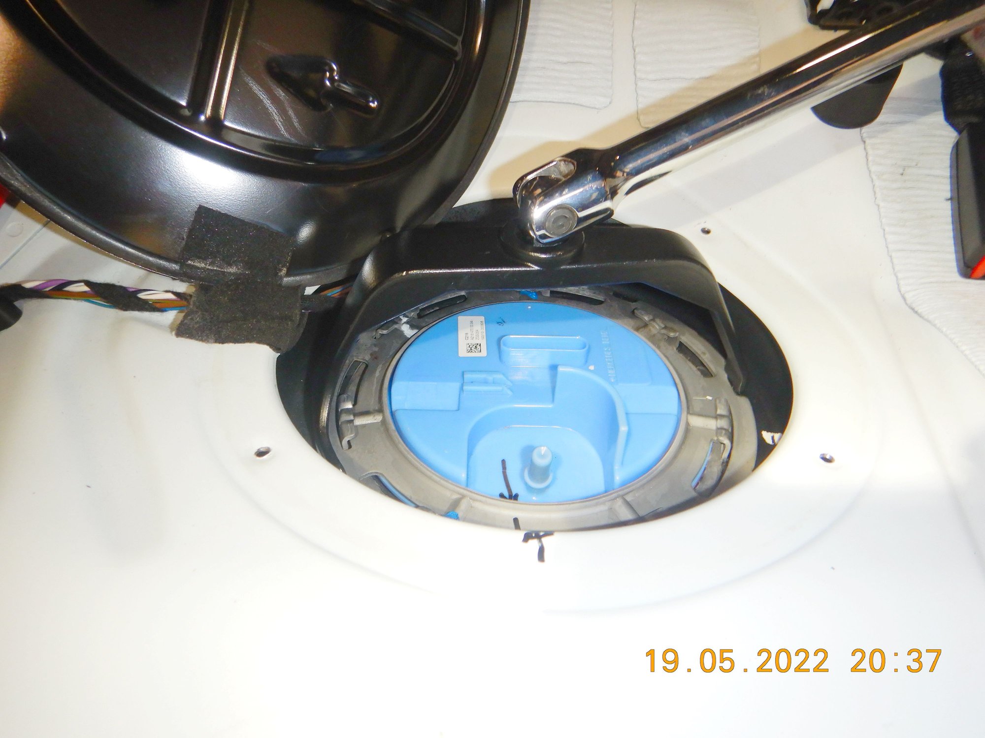

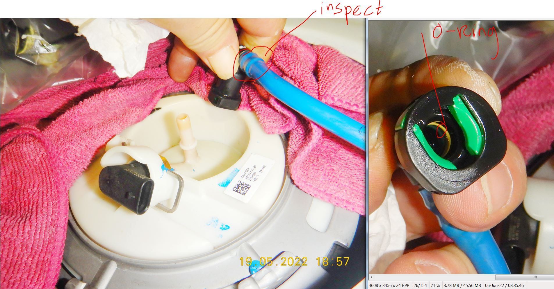

Read this first : https://mbworld.org/forums/e-class-w...er-change.html
That blue fuel hose BLACK connector is a PUSH-TO-RELEASE type at the base to release, kind hidden from view.
So ur o-ring is probably leaky.
There is 5 BAR of pressure in that blue fuel hose, becareful. See the link and study it well. Ask more when you need it yah.
Battery disconnect is best-safest and a MUST to prevent fuel pump priming itself.
Use a mirror to locate the push button.

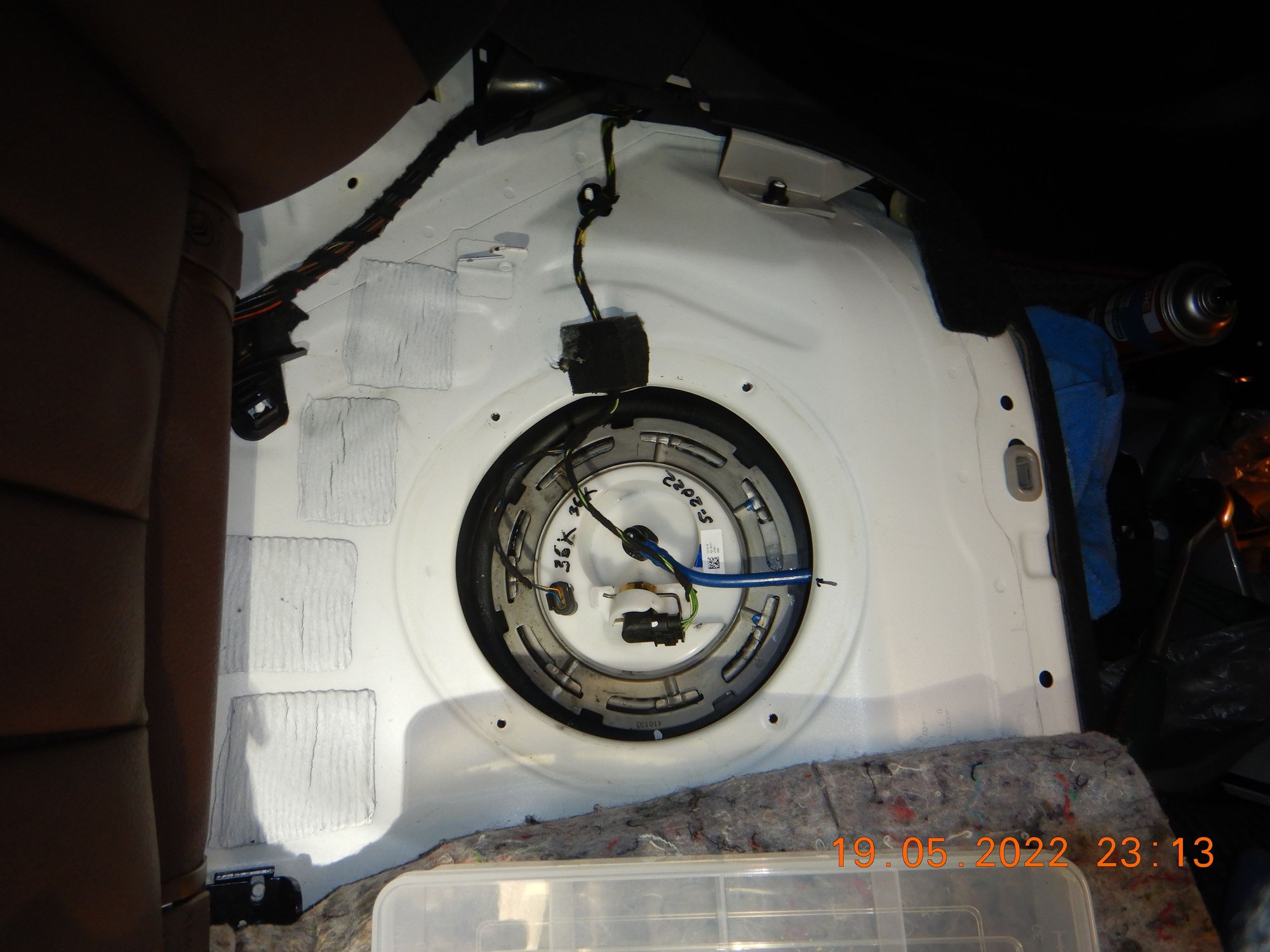

The fuel leak smell if is inside the car, meaning from these two units :
The leaky points are not only the white if filter and blue if pump plastic body/cover of fuel pump or fuel filter, cracking, it could also be the big orange o-ring underneath it failing.
It can also be the o-ring of the blue plastic hose of filter output.
PUMP
See the big orange o-ring.
FILTER. Also uses the same big orange o-ring.
Thus 2 old o-rings in my hand. I use new o-rings. A MUST DO.
This is the output hose of filter to engine, it has o-ring. U can't buy this o-ring, you must buy 1 set blue hose.
To replace this blue hose most likely your fuel tank must come down. I tried replacing this blue hose and failed, because I do not want to drop my fuel tank.
Maybe drop of 2-3 inches is enough, no need to drop 100% to the floor. Me worried the main fuel filler hose neck will break, also plastic. when I lower fuel tank even only by 2-3 inches.
Good luck finding the leak..........

Yes, it is possible but the o-ring has to be accurately the same and fuel resistant and up to 7 BAR ( 102 psi ) ready.
If that o-ring failed, I think sooner or later the blue plastic hose and the black plastic clip body will go too.
Afterall it is plastic.
