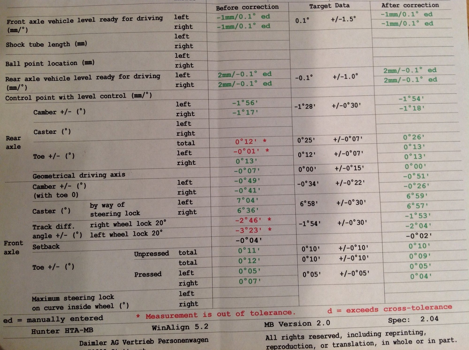

Just had my CPO 2012 E350 Sport alignment checked this week.
Old Nov 9, 2014 | 07:47 PM
tmitmitmi's Avatar
Joined: Nov 2014
Posts: 5
2012 W212 E350 Sport P2
Don't know what happened to the picture of alignment report I attached to post ???
Old Nov 9, 2014 | 07:51 PM
tmitmitmi's Avatar
Joined: Nov 2014
Posts: 5
Old Nov 9, 2014 | 09:02 PM
sghokie's Avatar
Joined: Apr 2008
Posts: 152
From: Northern VA
2010 e350
Thanks for the pic of your alignment.
How did it drive before the alignment?
How does it drive now?
I see you had almost 0 left toe and they put +.13 on both rear toes.

Before alignment I had very slight pull to the left on the highway. It was perceptible though not terrible, BUT, I hoped the dealership I'd just bought the car from would include the alignment, which they did. I'd only bought the car (CPO) four days before.
I'd learned that CPO "certification" does not include an alignment. From my last CPO purchase, a BMW 335 Convertible, I got "burned"'by that lack of an alignment check because it drove fine, but the inside of drivers side tire was bald within four months. So that meant a new tire and alignment on that car.
This time around I wanted to avoid that and my dealer took great care of me.
