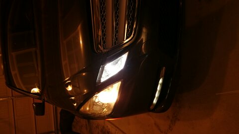

Update, Parking lights installed
Here are a few picks of the parking lights installed and being installed. I adjusted the picture in order to get "real life" color on this lights, which makes everything else look a little weird. The color of the lights in the pic are exact. Headlights should be installed within a week.
Parking bulbs were 12$ for the pair on amazon.

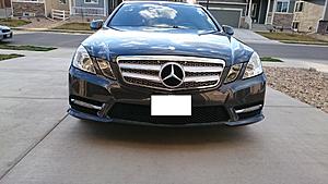

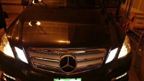

Finally done. Headlamps are a perfect match to factory. The color of the headlights, DRL, and city lights are now perfect which was my original intent before all this crap happened. Here are a few pics. One is comparing the new LED to old Halogen. I will post more after I take them tonight. Also, the chrome bulbs really do make a huge difference in the corners and turn signals.
Attached Thumbnails Full front light upgrade Help?-front1.jpg   Full front light upgrade Help?-front3.jpg   Full front light upgrade Help?-front4.jpg   Full front light upgrade Help?-front5.jpg
