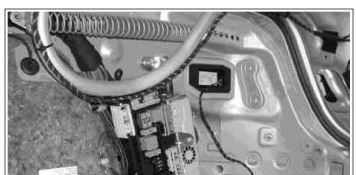

For the trunks its a bit different issue causing it then the tailgates. Im assuming you dont have a wagon so its the trunk lid on yours. There are springs that can adjust the pretension, by reducing the slack (counter clockwise iirc) the trunk will not shoot up so abruptly. hth.

When I unlock the trunk on my car, it opens with a certain amount of strength and then bungees a bit at the top and the whole car slightly bounces with it as well at the top.
May need to adjust springs, note holes - upper right.
Attached Thumbnails E550 2011: Trunk / Tailgate opening like a slingshot!-capture.jpg
