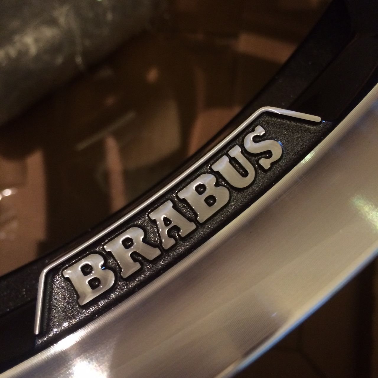

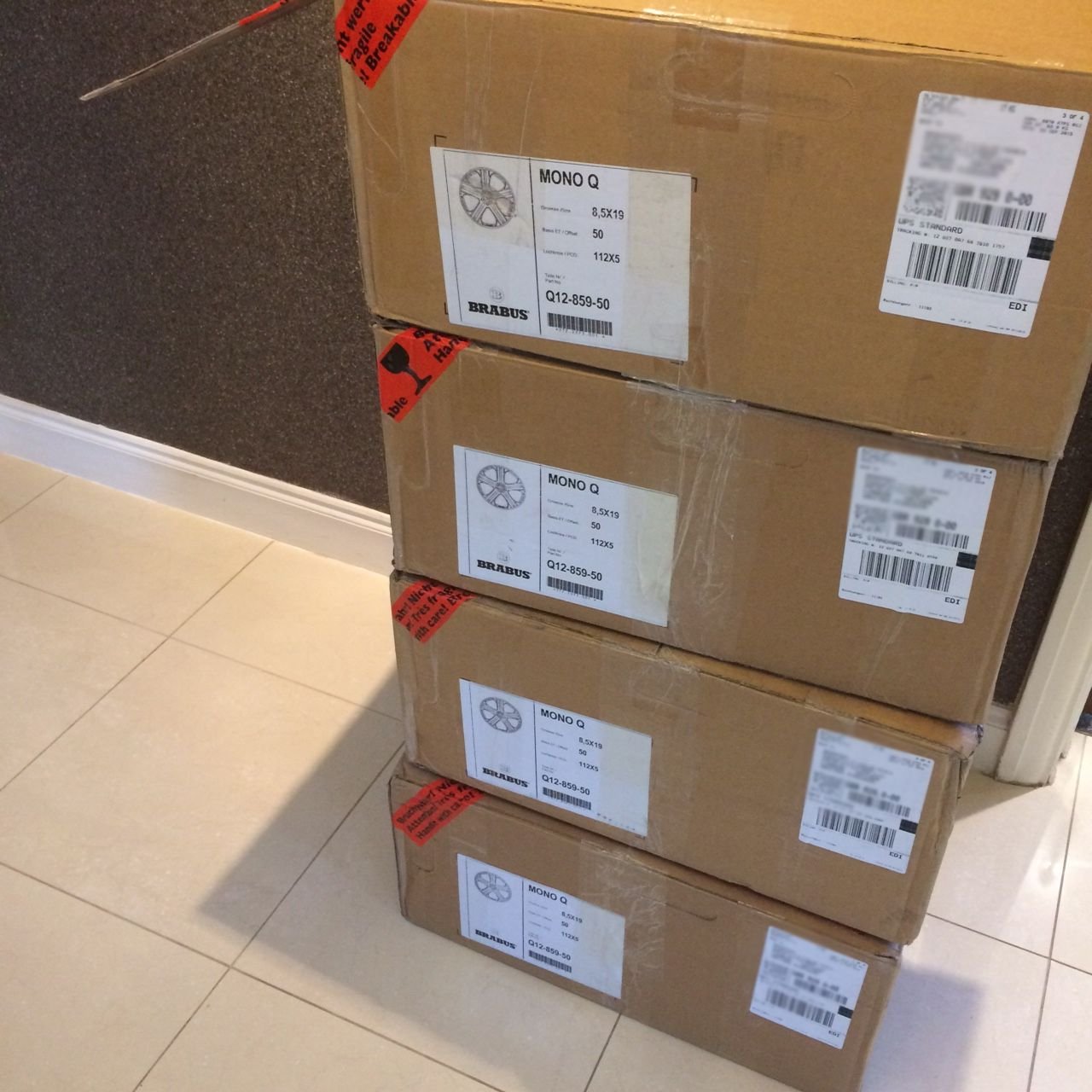

the front wheel spec i have choosen is 8.5x19 - et 50
really thinking of 245/40 or 255/35?
anyway.. here are these beauties
