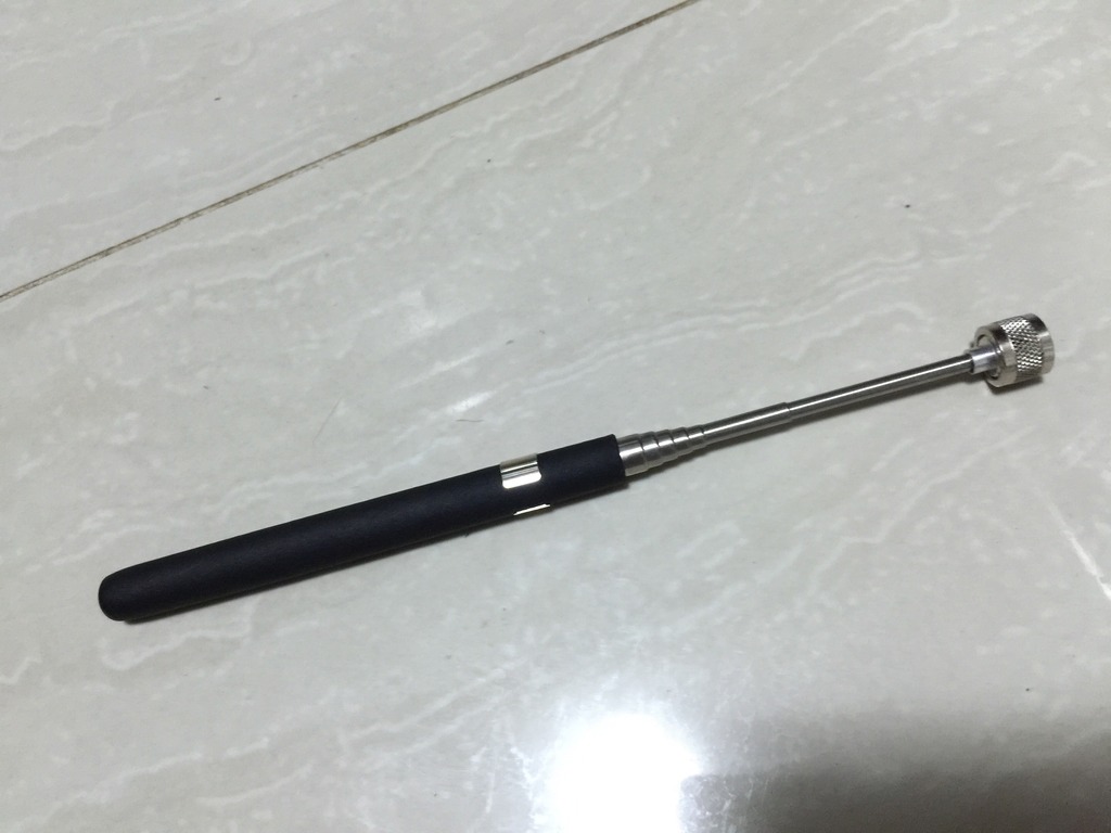

This is what i use for times like that, a telescopic stick with a magnet at the end. You wouldnt believe how many times this thing has saved me from major headaches.
Help - Hex screw fell inside the torque converter-d2704b5f-02f6-4f08-b7d6-d1d4502a7e82_zpstqgput20.jpg
