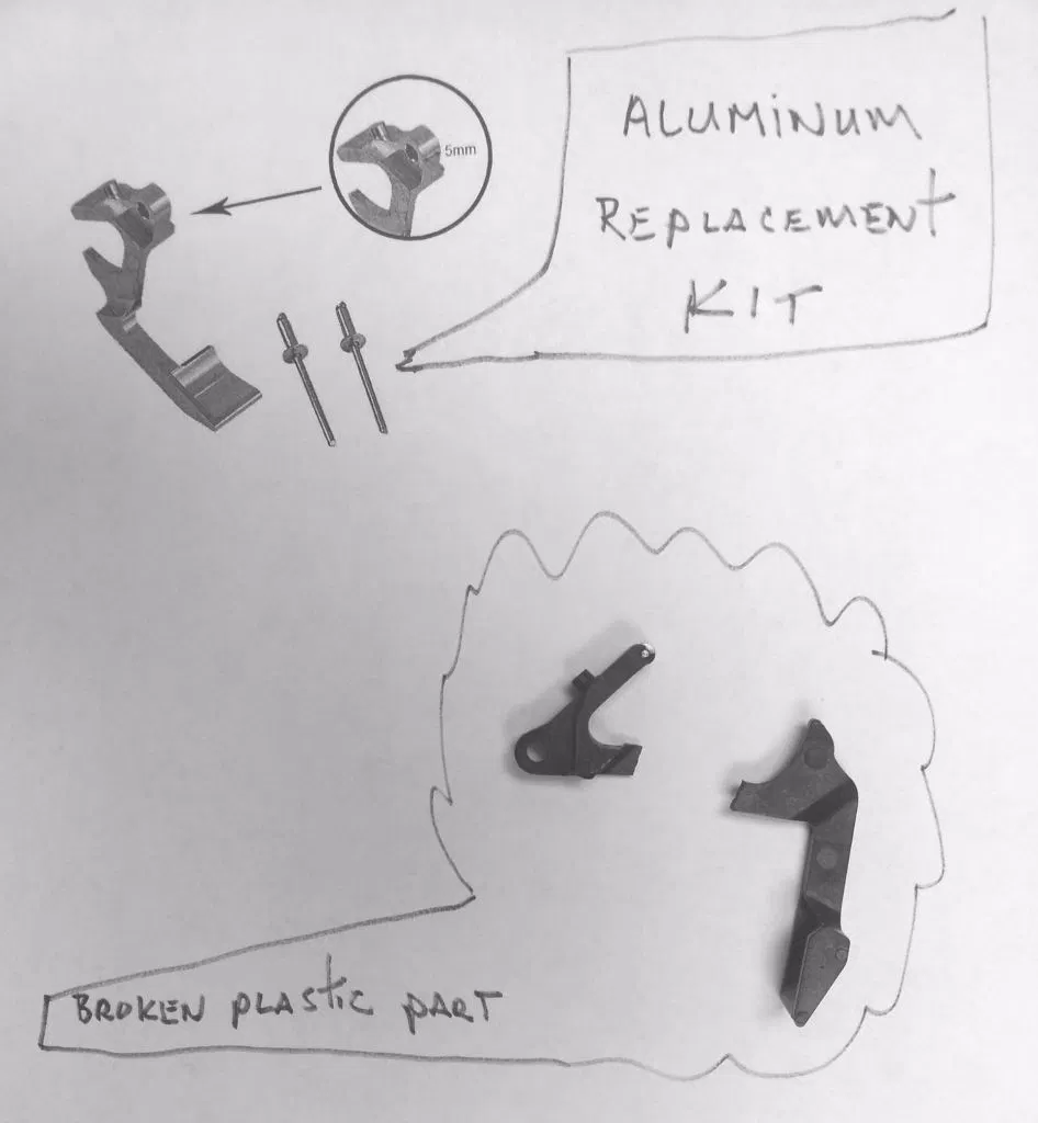

Not sure if the W212 has a plastic shifter part like the 722.6 tranny, but ever since reading about the "stuck in park" issues, I started applying the parking brake as mentioned above when parked on anything but level ground.
