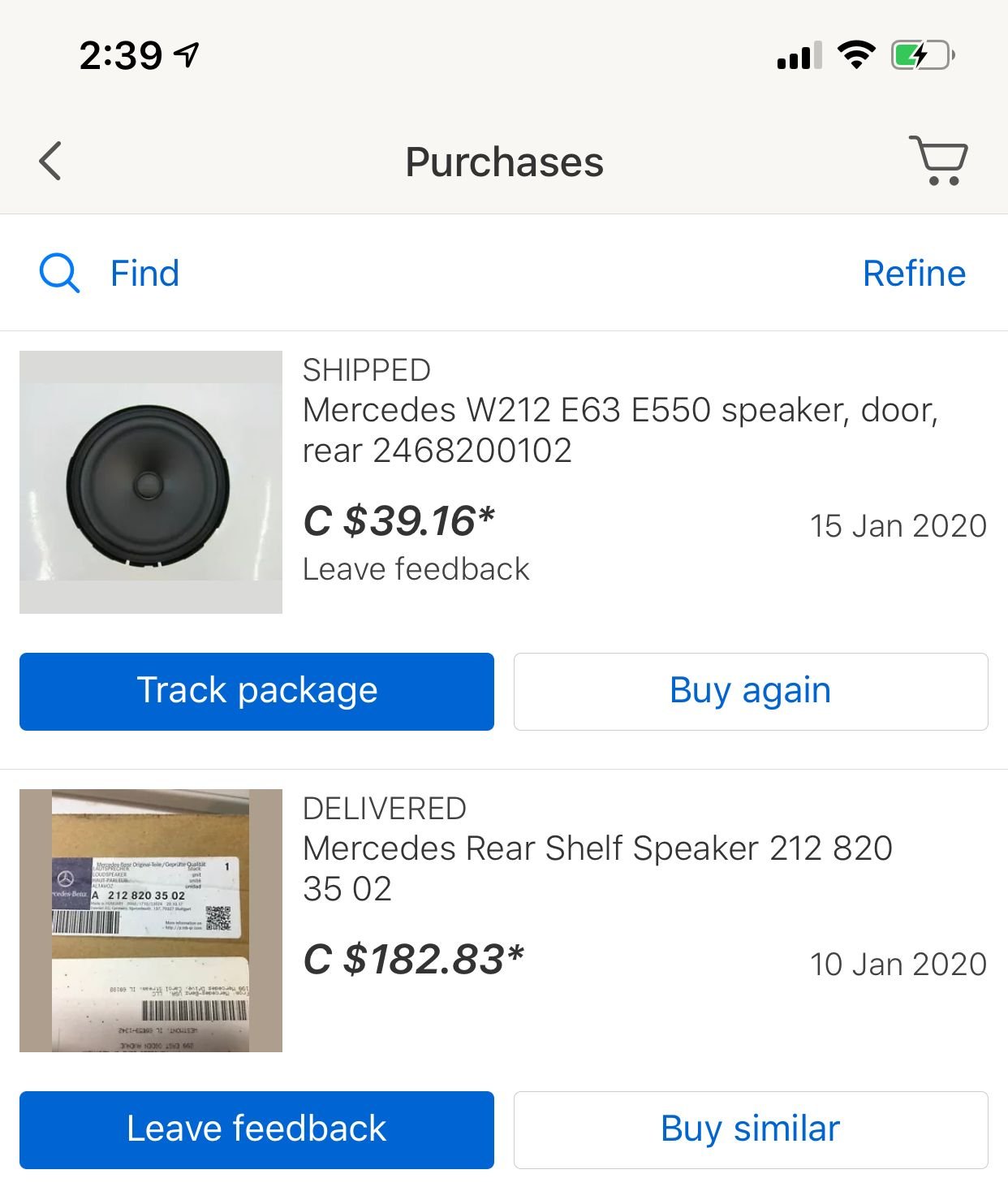

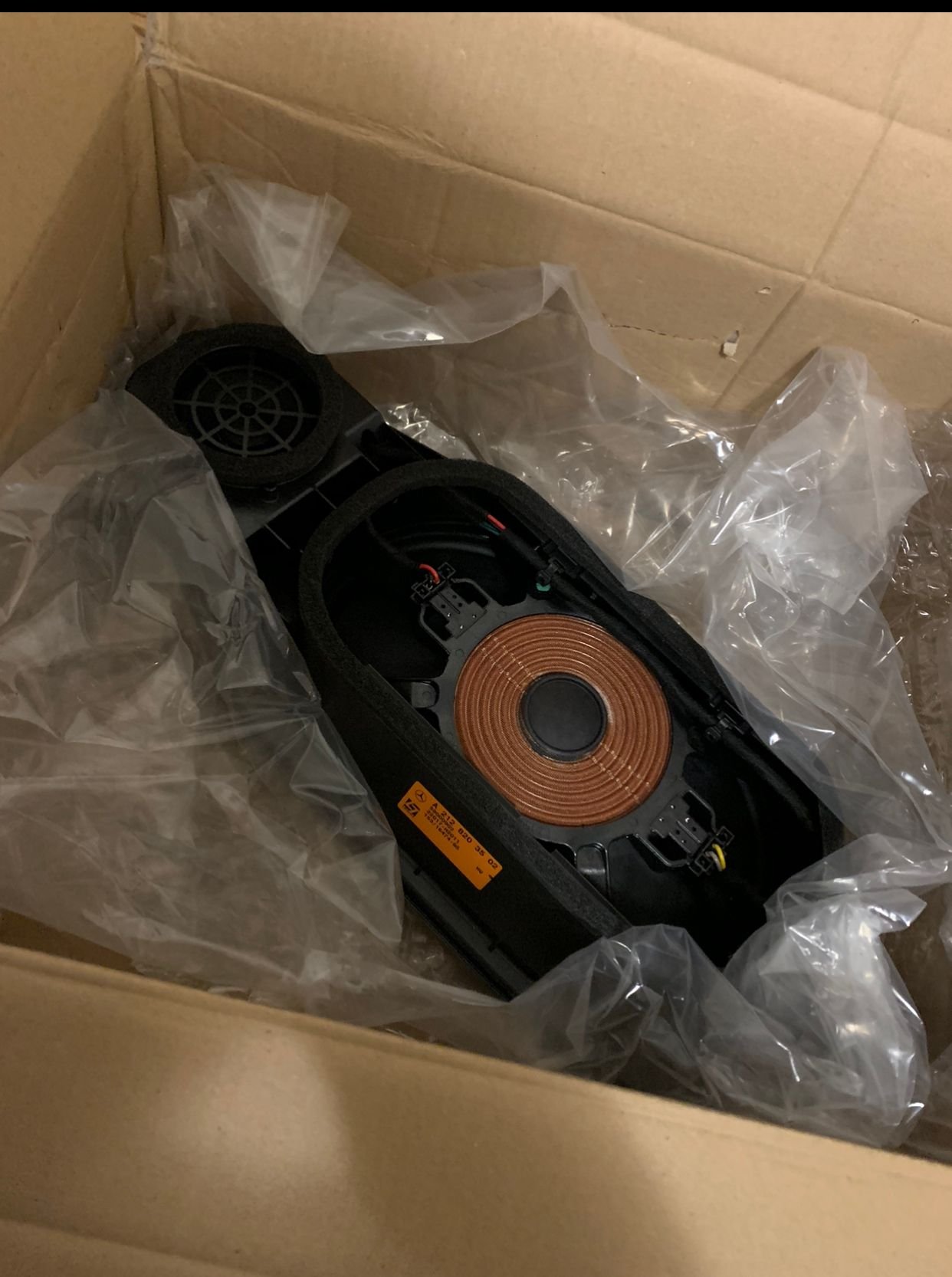

Hello my dudes, I believe my sauga of melting speakers is about to end. Just ordered a new subwoofer off EBay and got it today, and also ordered the side door panel speaker
Here’s the new subwoofer! Someone had an issue with their speaker at the MB dealer, and ended up being covered by MB, but the guy never came back to install it haha. So pretty good deal considering it’s new
Found out the right rear speaker was actually unplugged, previous owner had this issue and dealer I believe disconnected it.

Speakers installed! Speaker Melting Syndrome is now over
Installed the new speakers! All together $576 installed. Pretty happy considering the subwoofer along from the dealer is $980
