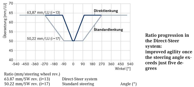

I believe you're referring to the "Direct-Steer" system, which was made standard MY14+.
I tried to find technical information regarding it, but all I can find is this graph.
