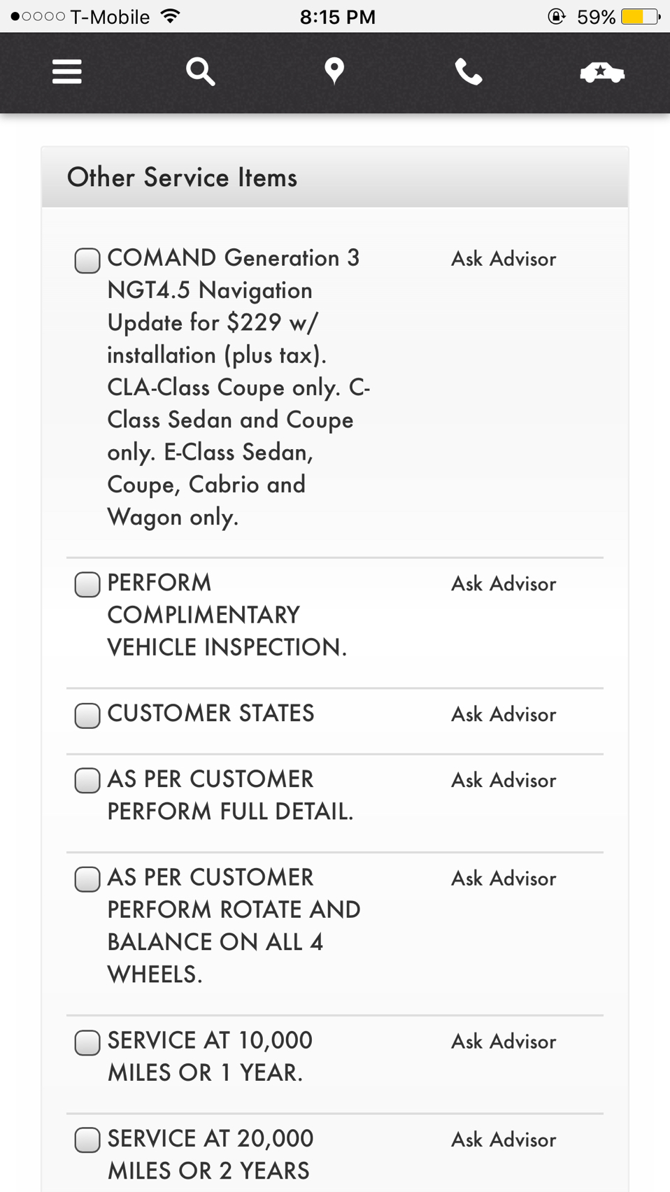

Just found this online. I dont think is that expensive.

Well that's just the comand update. Navigation update lists for $250, but I think you find it cheaper online, but that's probably more like $180-$200. So you're looking at a little over $400 although someone else claimed the dealer was able to do it for around $150 so it may be something you can negotiate.
Where did you see that price list? My local dealer is quoting me nearly $600 for nav map update.
