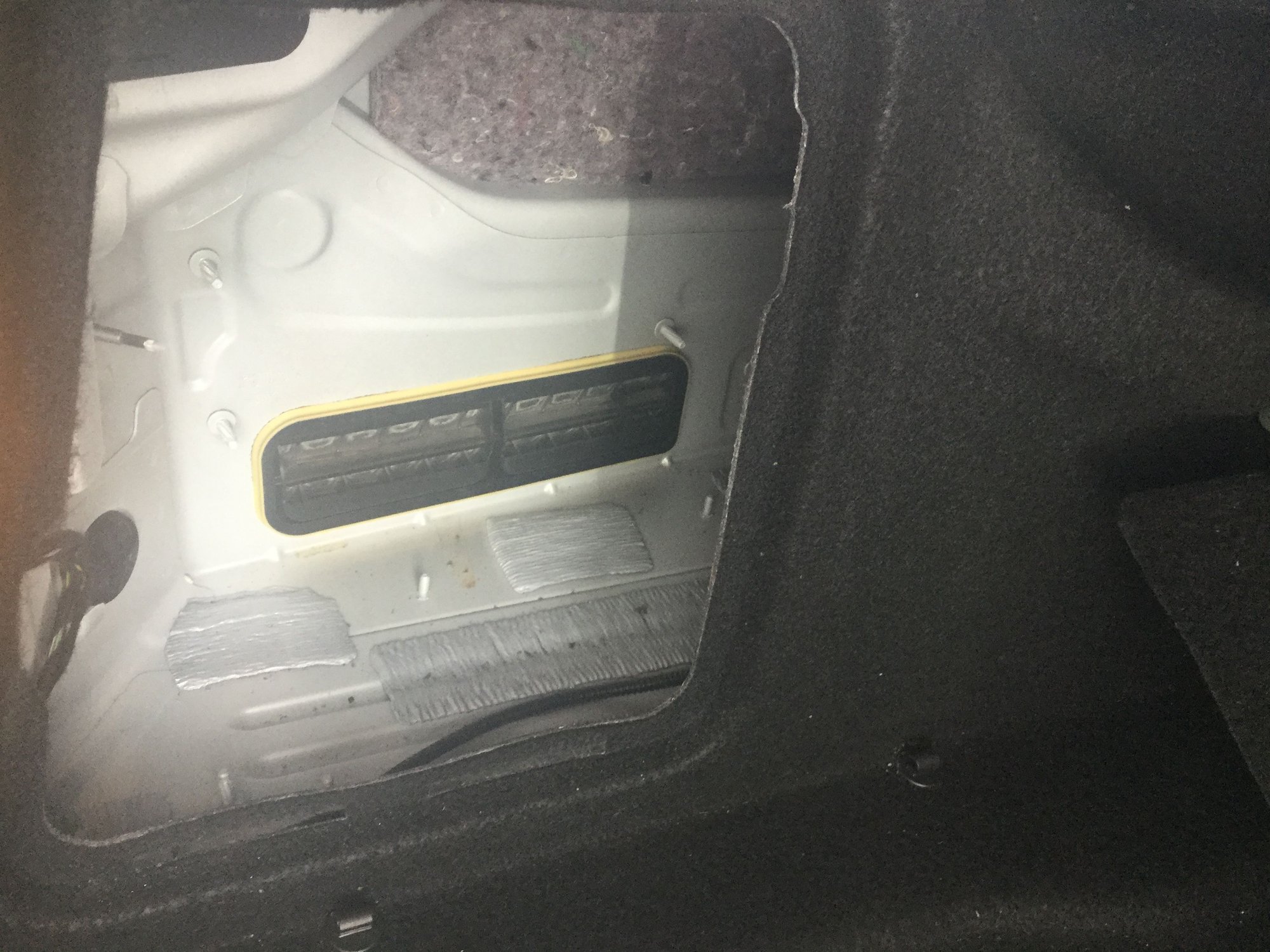

I was unable to locate the Sirius satellite radio control module based on the above picture. Dealer stated this module needed to be replaced in order for satellite radio to start working. This picture shows the trunk, left side (drivers side in USA). As you can see, nothing is there. Vehicle 2016 E250 4-door 4matic. Any suggestions where it might be located?

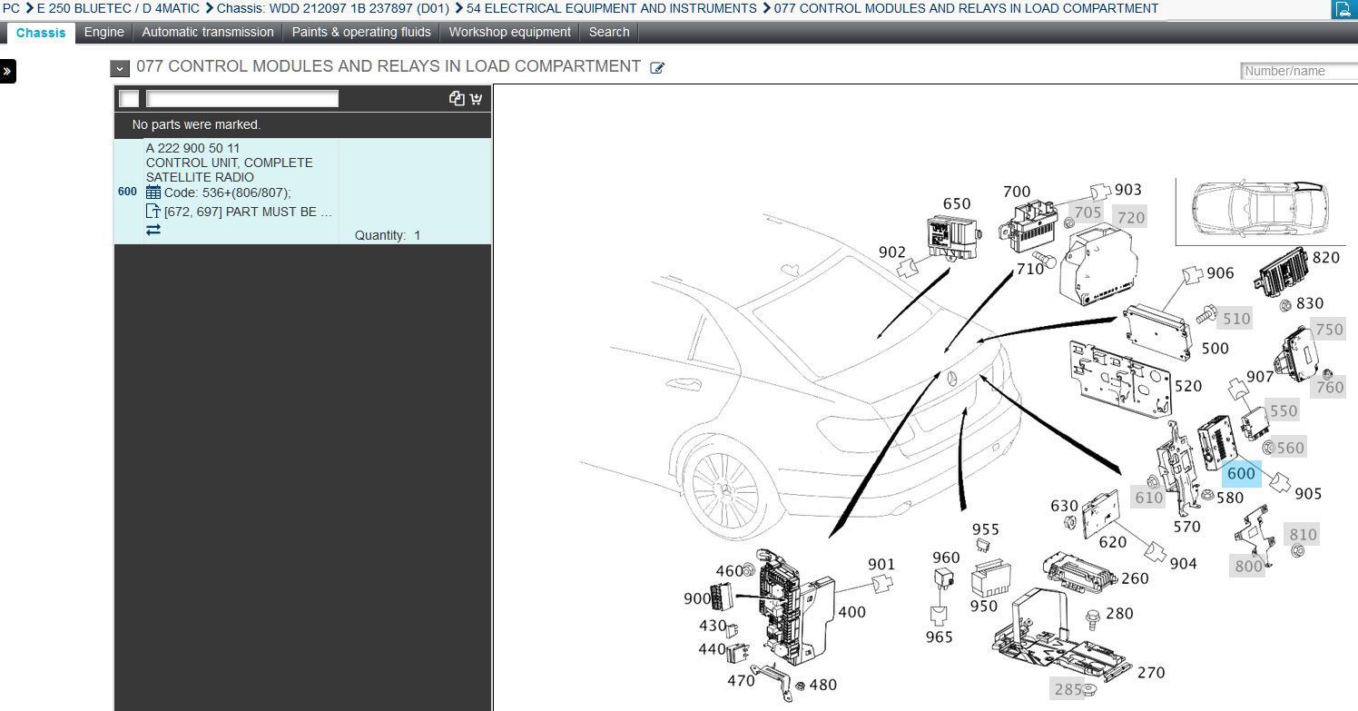

Since reluctant to provide VIN I pulled a comparable vehicle, this model satellite receiver is located on right side - current part # is 222900301580 or shop 2229005011 used. Replacement should be covered under factory warranty if receiver is malfunctioning.

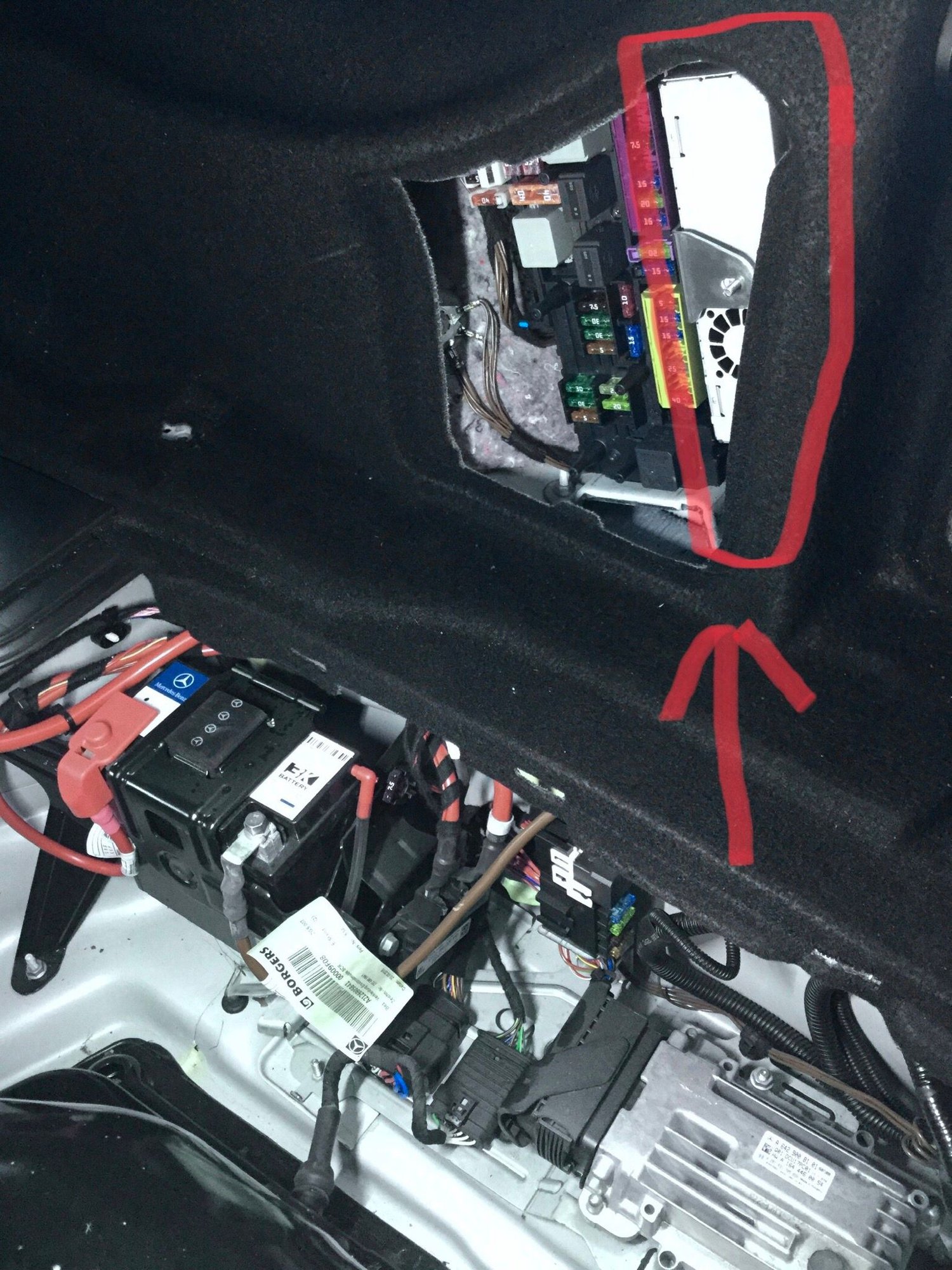

Found it! It is on the right side trunk area next to the fuses and below the right trunk hinge. Now to find out if it is plug and play or if it needs to be coded to the system. Warranty is long over with over 100,000 miles on it.
