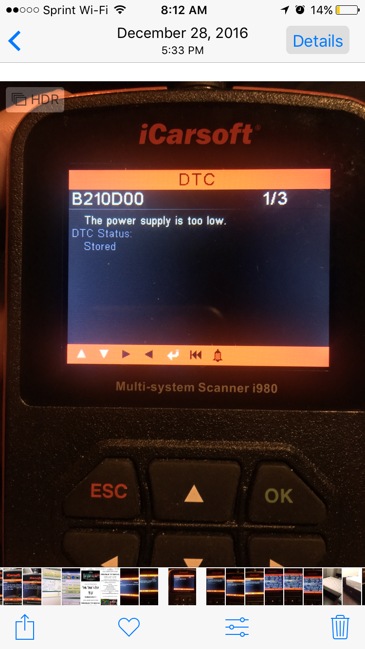

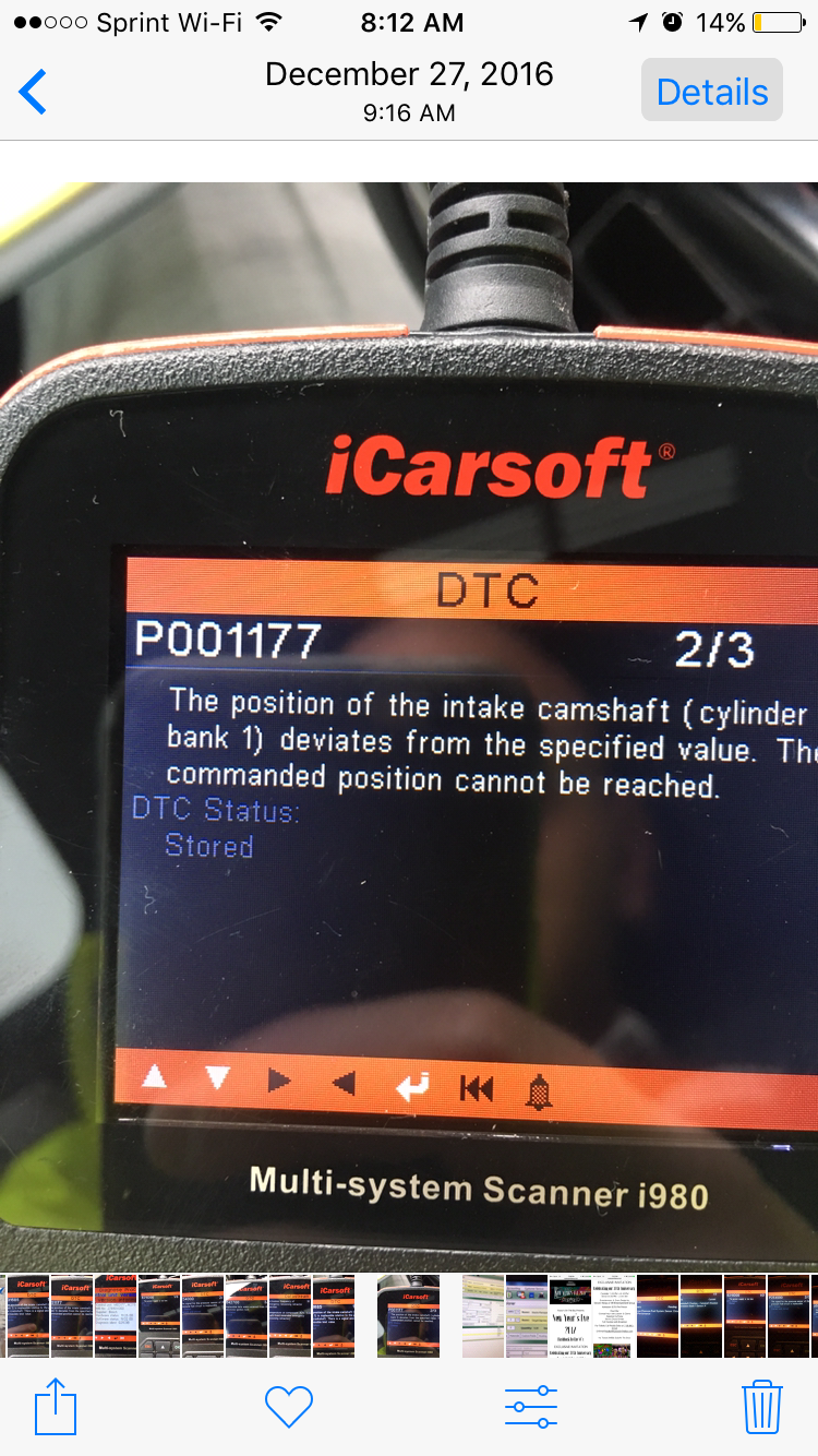

Issues: 2 months ago when it began to get cold in NYC I began to hear a noise upon startup for a few seconds. After researching I saw that many owners shared this same issue. MB released a TSB on this in 2013 "Rattle Noise after engine start for a few seconds (M278 M157 M276 engines.) After reading the SB and saw that no consequential damage can come it I was relieved. Even though I didnt have a check engine light on at he time I still wanted to check to see if anything would pop up. I recieved 2 codes; P0016 & P0011. I documented both codes for reference purposes and monitored it for the next 2 weeks. Conclusion; No change in engine performance or behavior. I continued to drive the car.
2.5 Weeks ago I get a check engine light on my way to work. When I got home that night I hooked up my icarsoft scan tool and I recieved 4 codes. P0016 P0011 and 2 new codes;
P2540 - The signal for the pressure sensor of the low fuel pressure fuel circuit is implausible.
B210D- The Power supply too low

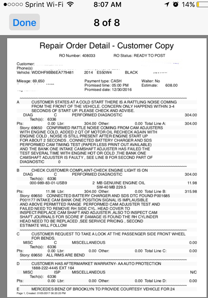

Rather than trying to fix it myself. I said, I have the warranty I'm just going to use it and bring the car in. As the days go by I notice its taking a bit longer for the engine to turn over. Anyhow, I bring the car in after a week long wait for an appointment and I hand the car over. I explain to the SA that I notice the car is taking 1-2-3 seconds longer to start up and I feel that there may be a problem with the fuel pump or system. I also advise him that the car upon start up makes a clinking noise that goes away after 2-3 seconds. I brought a copy of the MB TSB and gave it to the SA for him to only pass it back to me. In my head, I said this guy didnt even write the TSB number down. I guess he just automatically assumed I knew nothing about cars.
In conclusion: The dealer calls me yesterday to tell me that they need to do a tear down on the head to check to see if the head is scored. He claims the cam is damaged and the cam adjustor needs to be replaced. He said this is due to poor maintenance (He said my engine was 2 quarts low on engine oil. No indicator on dash and my last oil change was 5k ago.) He said to do the tear down and change the cam and cam adjustor it would cost $6825. He then proceeded there is a possibility the head may be scored and if that is the case it would be nearly 12k to fix.
-Cam Adjustor
-Cam shaft ()
I told the SA I will come in on Monday to go over the details. If anyone has any input please feel free to advise. I will post the MB Diagnosis and codes to this post.

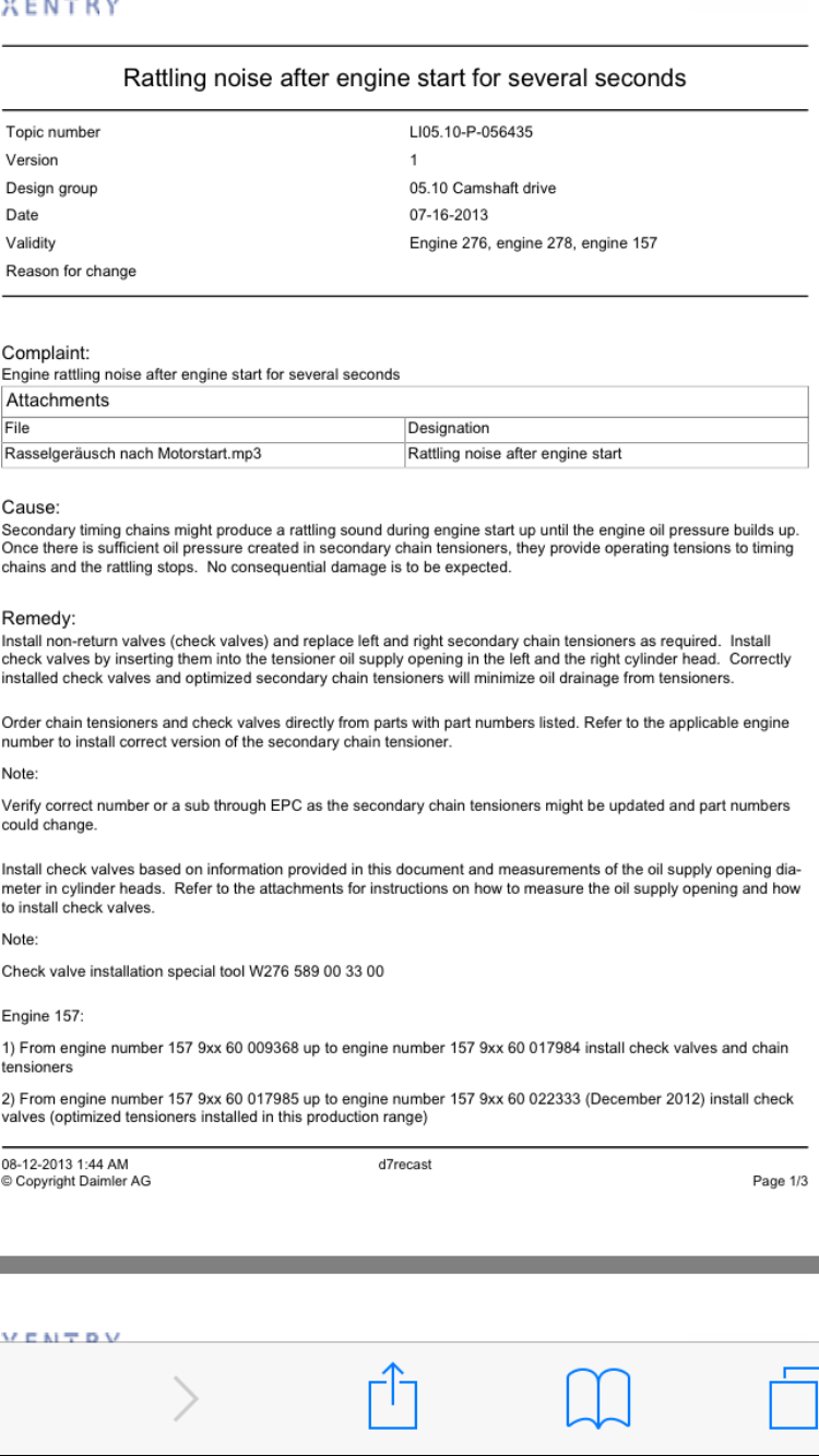

I have 2 concerns:
1) I walked into MB knowing why the engine was making noise upon start up. I provided him the bulletin and he basically passed it back to me. On the TSB it states chain tensioners L & R need to be replaced and check valves have to be inserted into the head to eliminate flow of low oil pressure (This is reasoning for the noise).
2) Why didn't the mechanic indicate Any mention of P2540 fuel pump code when he diagnosed the car?
Instead I get a diagnosis that states I need a new cam and camshaft adjuster and on top of it Possibly a new head if it is damaged.
I honestly think the diagnosis is wrong.

I attached a copy of the TSB and picture of the codes I pulled prior to going to MB

r. I just walked out of the Mercedes dealership after had speaking to the shop foreman. The shop foreman in my opinion did not expect me to come prepared based on my impression. He basically excused himself from the conversation and walked away because he did not know what to say to me. I was able to verify with him that my car DID NOT have a check valve installed.
My next question to him was "does my car have the updated chain tensioner that is specified on the TSB?"
His reply: "I'm unsure."
My reply: So how could you come to the conclusion that I need a cam and a camshaft adjuster when the check valves were not installed at time of build nor were my chain tensioners inspected to see if my car had the revised tensioners.
His reply; "based on the codes I got, that was my conclusion"
I laughed
He then excuses himself from the conversation and acts as if he has someone waiting on him.
The most important question I wanted answered was, why was the P2540 fuel code not on the diagnosis sheet?? I indicated to the SA once again that I felt the car misdiagnosed and I felt the car has 2 separate issues. 1) being the check valves and chain tensioner and 2) a bad fuel pump or fuel sensor. The SA Couldn't answer my question and didn't know what to say. I believe I got my point across and SA assured me that the car will be reevaluated by lead tech tomorrow morning. I will update the thread once I receive diagnosis from lead tech...
Truly Unbelievable

Update: MB SA just called to give me a final diagnosis...
Upon discovery of the check valves not being installed in my vehicle. After analysis, they also realized L+R chain tensioner's show signs of wear due to the mileage of the vehicle. Regarding the Fuel Code P2540; High pressure fuel pump failed. Pump needs to be replaced.
Conclusion:
- Check Valves need to be installed.
- Chain tensioner's (Left + Right) will be replaced.
- Fuel Pump will be replaced
SA advised; Upon installation of the above, codes will be cleared and vehicle will be reassessed to verify all issues have been addressed. "Hopefully no codes come back"
