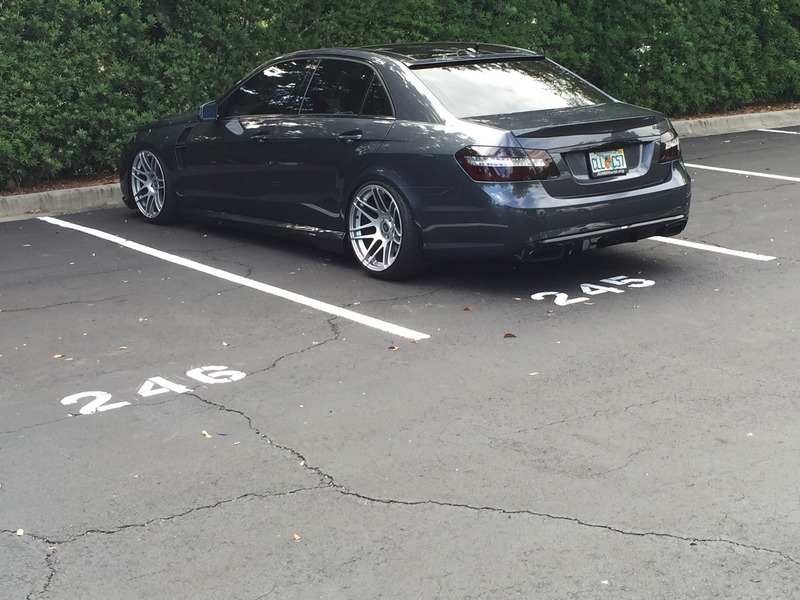

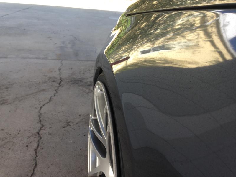

I got Forgestar F14 deep concave up front and super deep concave in the rears (which are FOR SALE) on my E550.
My specs are:
19x10 +38
19x11 +38
They sit flush with my fenders, didn't need to roll or pull my fenders, and they clear my brakes without spacers...
Chance concave 19x9.5 Et42 wheel up front rubs caliper?-image_zps5mxs2rob.jpg
EDIT: here are some better pics showing fitment - let me know if you want to buy them
REARS:
Chance concave 19x9.5 Et42 wheel up front rubs caliper?-52824703-d18f-4d54-9266-d3585a375e36_zps5pbi3bkx.jpg
FRONTS:
Chance concave 19x9.5 Et42 wheel up front rubs caliper?-30ed8bbb-6373-424d-bb99-cc9255d59b11_zpscplxukew.jpg

DUDE!! I wish I saw this post before getting my wheels
If you don't mind me asking, what suspension are you on?
Old Jan 16, 2017 | 07:17 PM
Chris_tA_4's Avatar
Joined: Dec 2010
Posts: 411
A4
factory air matic with lowering links, that's it.
