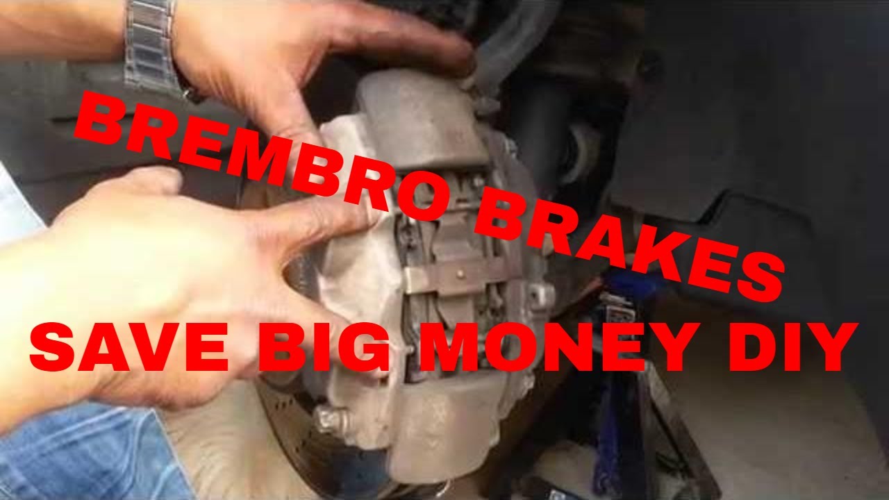

My 2010 E550 has 4-piston brake calipers up front. I dunno the answers to the question about rotor size and what not.
This is someone else's picture but it's the same ones that I have.
