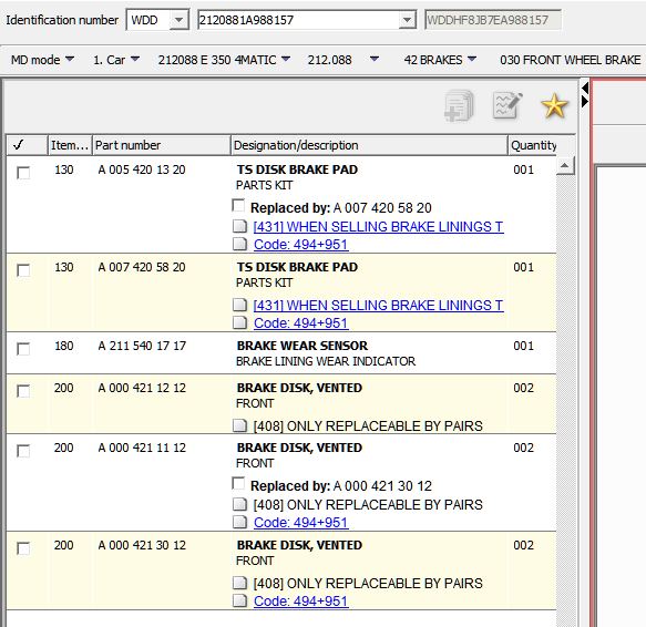

Ok, here are my part numbers for my OEM brakes. For anyone reading this, you can click on my vin in the first post to see what type of car i've got (2014 E350 4Matic Sedan with the sport package). If you've seen one, you've seen mine. I'll also include what I paid for them.
Front Pads: 007-420-58-20 ($63.72) One for the front entirely (not one for each wheel)
Rear Pads: 007-420-68-20 ($60.18) One for the rear entirely (not one for each wheel)
Front Rotors: 000-421-30-12-07 ($92.04 each)
Rear Rotors: 000-423-09-12-07 ($43.07 each)

Here is what EPC shows for your VIN, see attachments. For future reference also consider https://www.mbdirectparts.com/ for parts.
Attached Thumbnails Brake Rotor/Pad part #'s?-front.jpg   Brake Rotor/Pad part #'s?-rear.jpg
