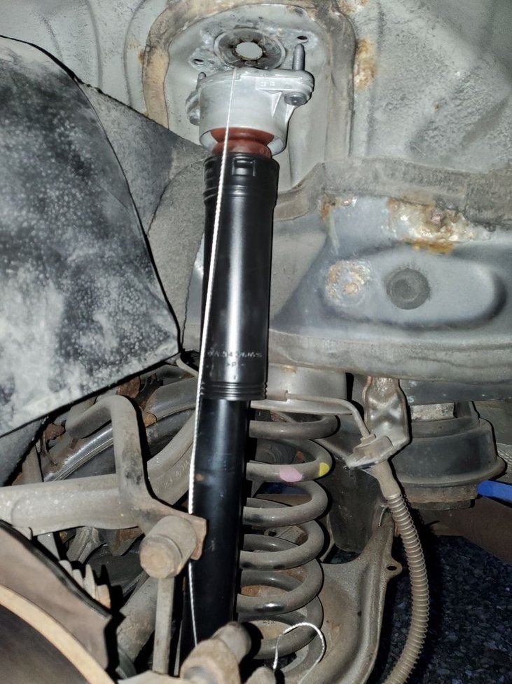

I replaced my rear shocks last weekend. It was pretty easy. The top mounts consist of 2 bolts for each shock in the trunk area. The bottom mounts consist of one bolt each through the lower control arm. I removed the plastic cover from the lower control arm to make accessing the lower bolts easier. When I reinstalled the control arm covers I used a couple of small black zip ties to ensure the retaining clips held. I also removed the inner wheel well insert which made seeing what I was doing much easier. You can skip this part if you wish.
To get the shock out you need to compress it a bit and work it out. Just takes a little muscle. The new shock goes back in reverse order. Compressing the shock for reinstall was a bit of a pain, though. I've see where someone compressed the shock and secured it with a heavy string until it was in position then cut and removed the string.

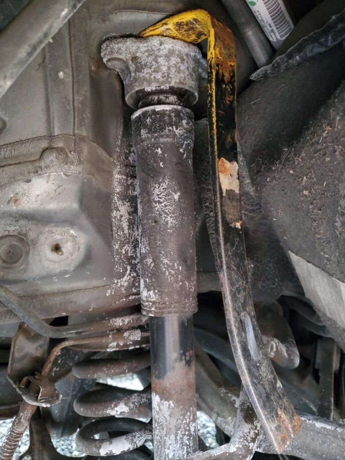

Update: I know it's been a while but I replaced both my rear shocks + airsprings myself (helped by YouTube videos) in 6 hrs and at $2000 (including some tools). My local MB dealer would have charged me $6200 parts + labor (they quoted 9 hrs of labor).

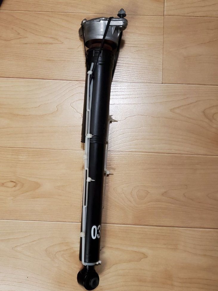

When i replaced my W204 rear shocks I tried string and then zip ties to hold them compressed while installing. The zip ties were easier.
