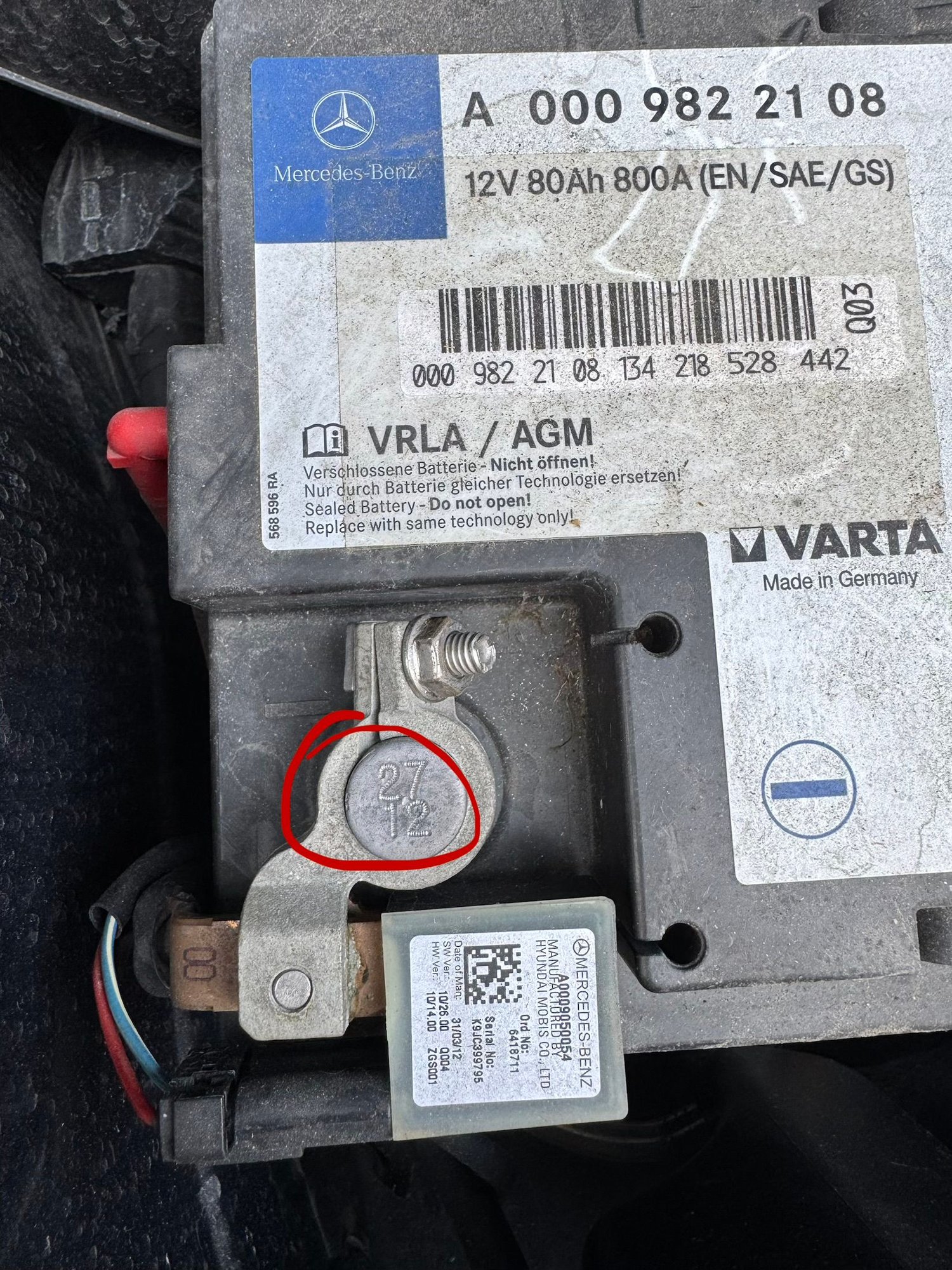

Old Jan 6, 2026 | 02:23 AM
2013W212's Avatar
Joined: Jul 2025
Posts: 38
Snapped a pic of it yesterday when checking to confirm that an H8 will fit on the tray (it will). I was actually wrong, it’s even older than November 2012, it’s from early July 2012 (27th week of 2012)!
It still starts the car after only 2 cranks in warm weather, and after only 3 cranks if below freezing (as of January 2026). I’m sure if it gets discharged just one time, that will be the end of its life (AGM’s hate being discharged) so it will be replaced in next few days.
My car is the last year of the E350 without start/stop so I’m sure that helped it live this long. Regardless, very impressive.
27th week of 2012!
27th week of 2012!
27th week of 2012!
thats the problem: it lasted too long without start/stop ("ECO").
Something has to be done to change that.
ECO requires an AUX battery with a collection of relays to switch power around. Be glad you don't have EngineCutOff.
